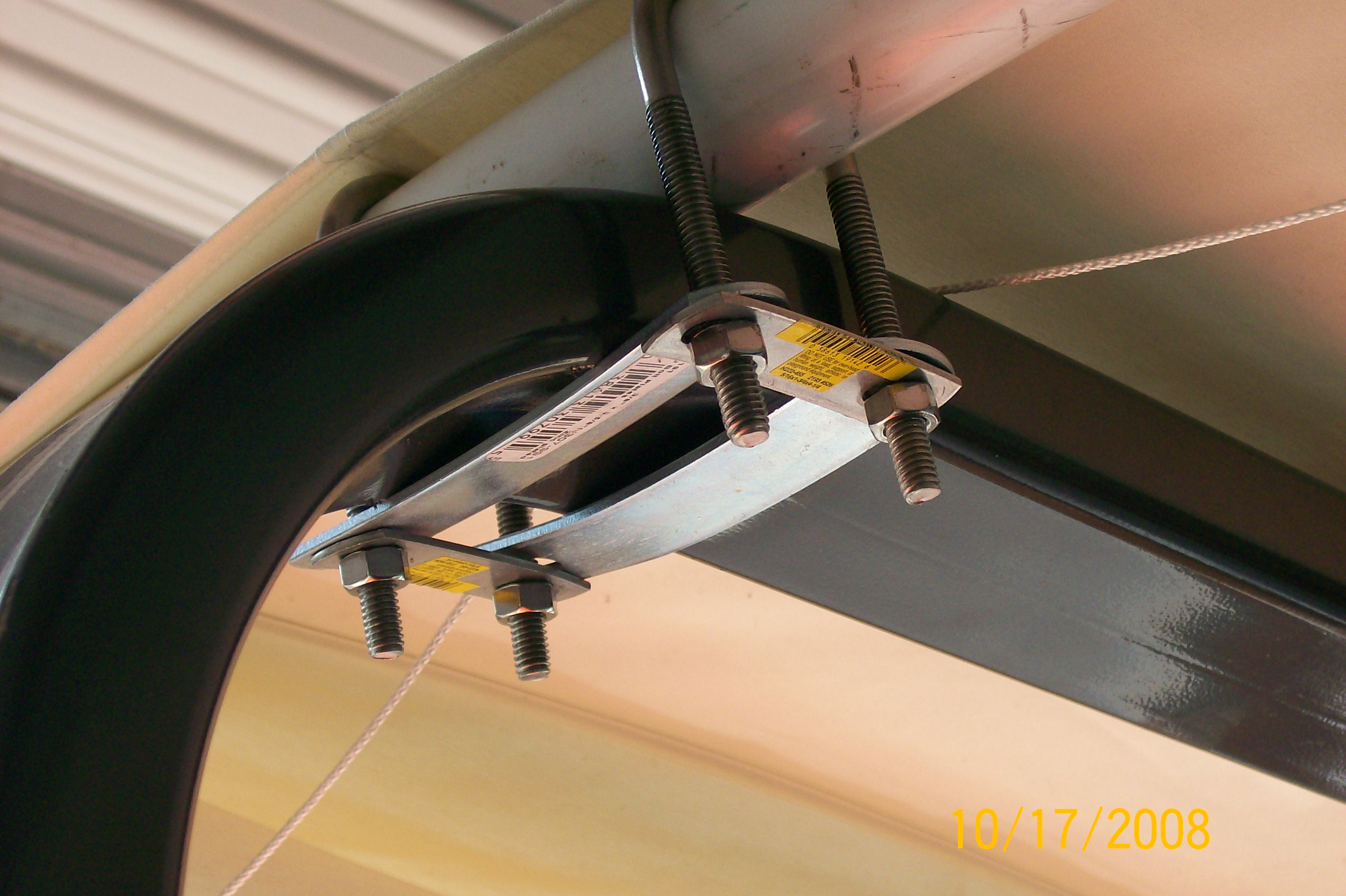

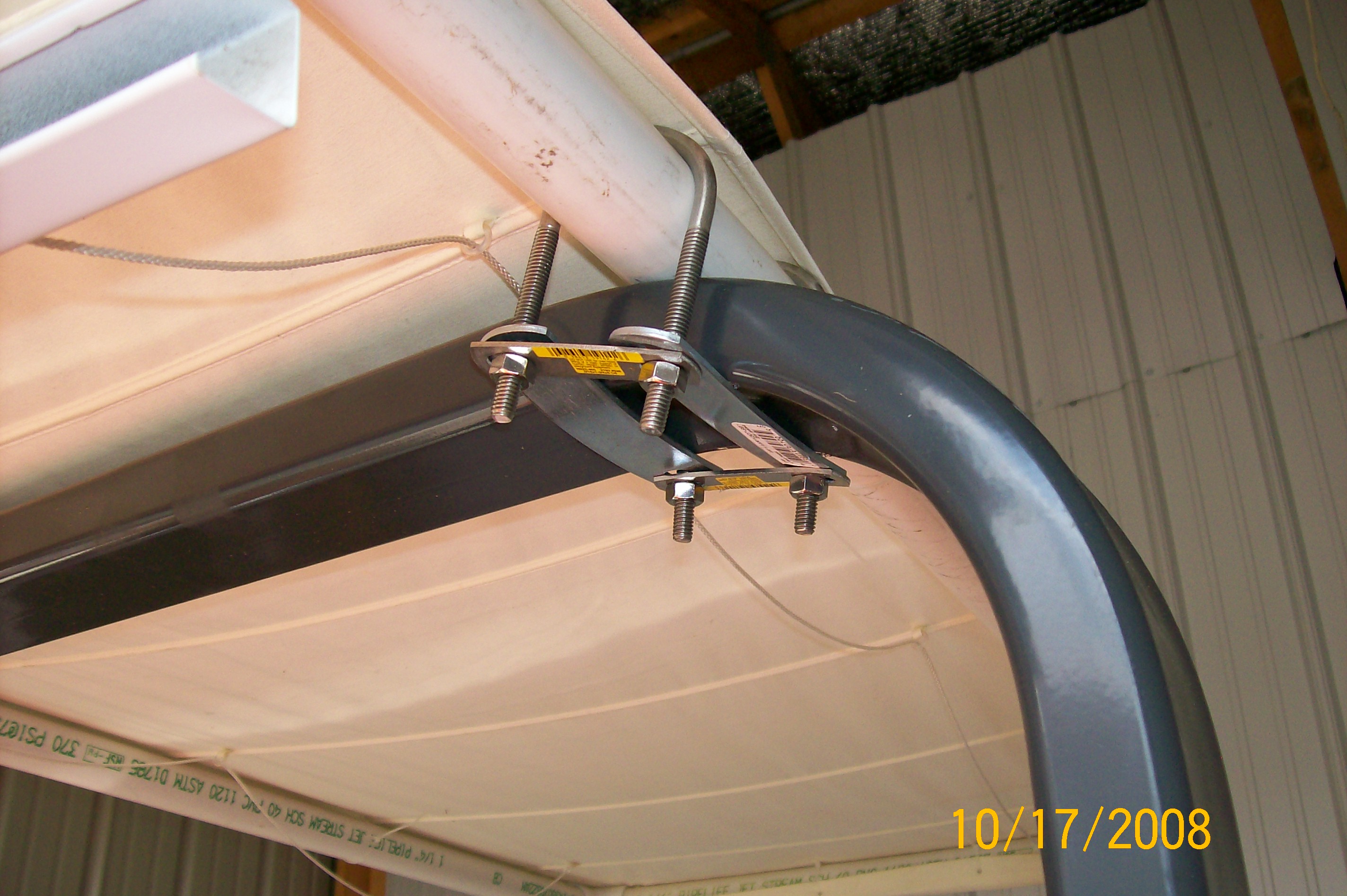

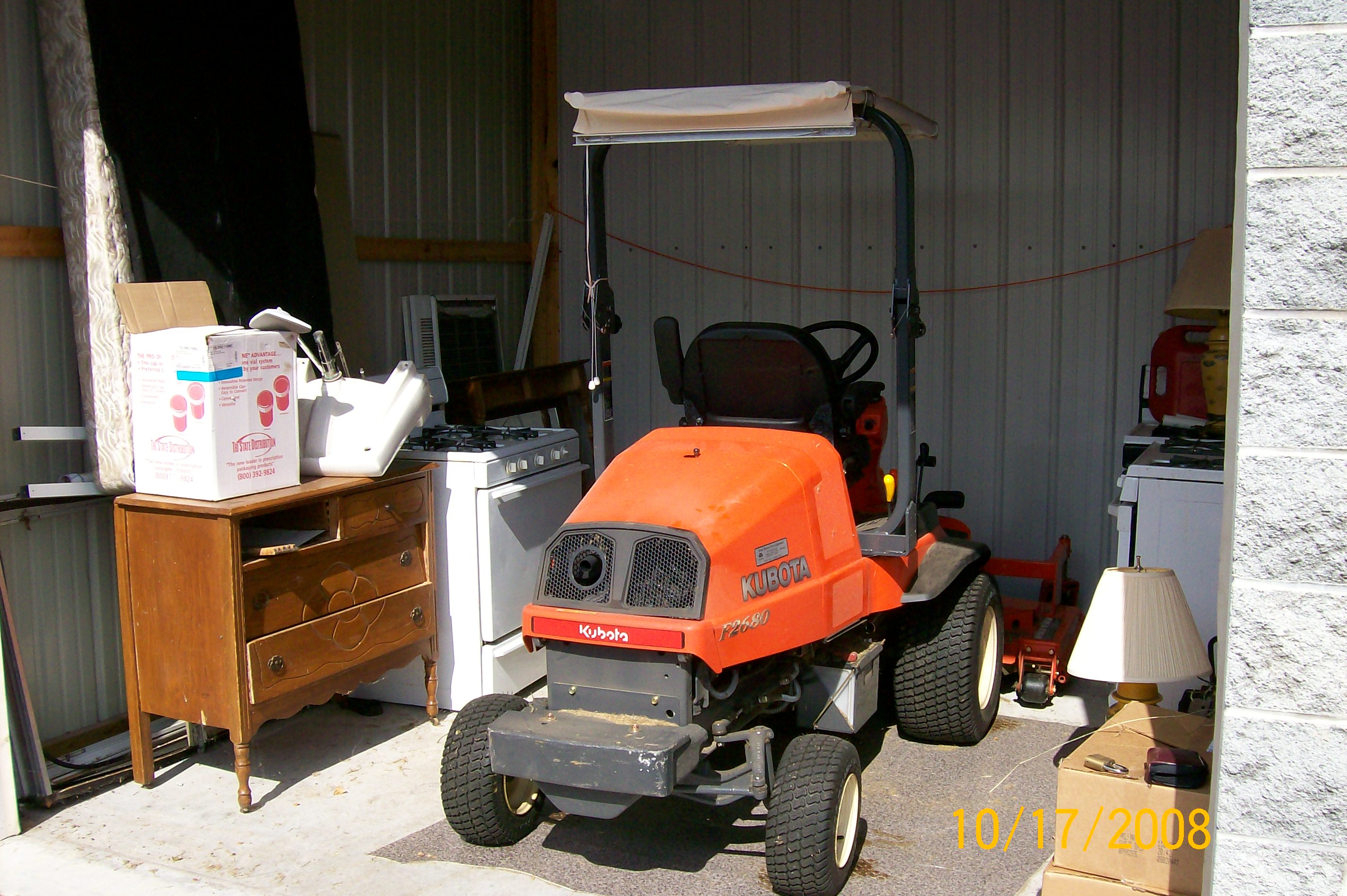

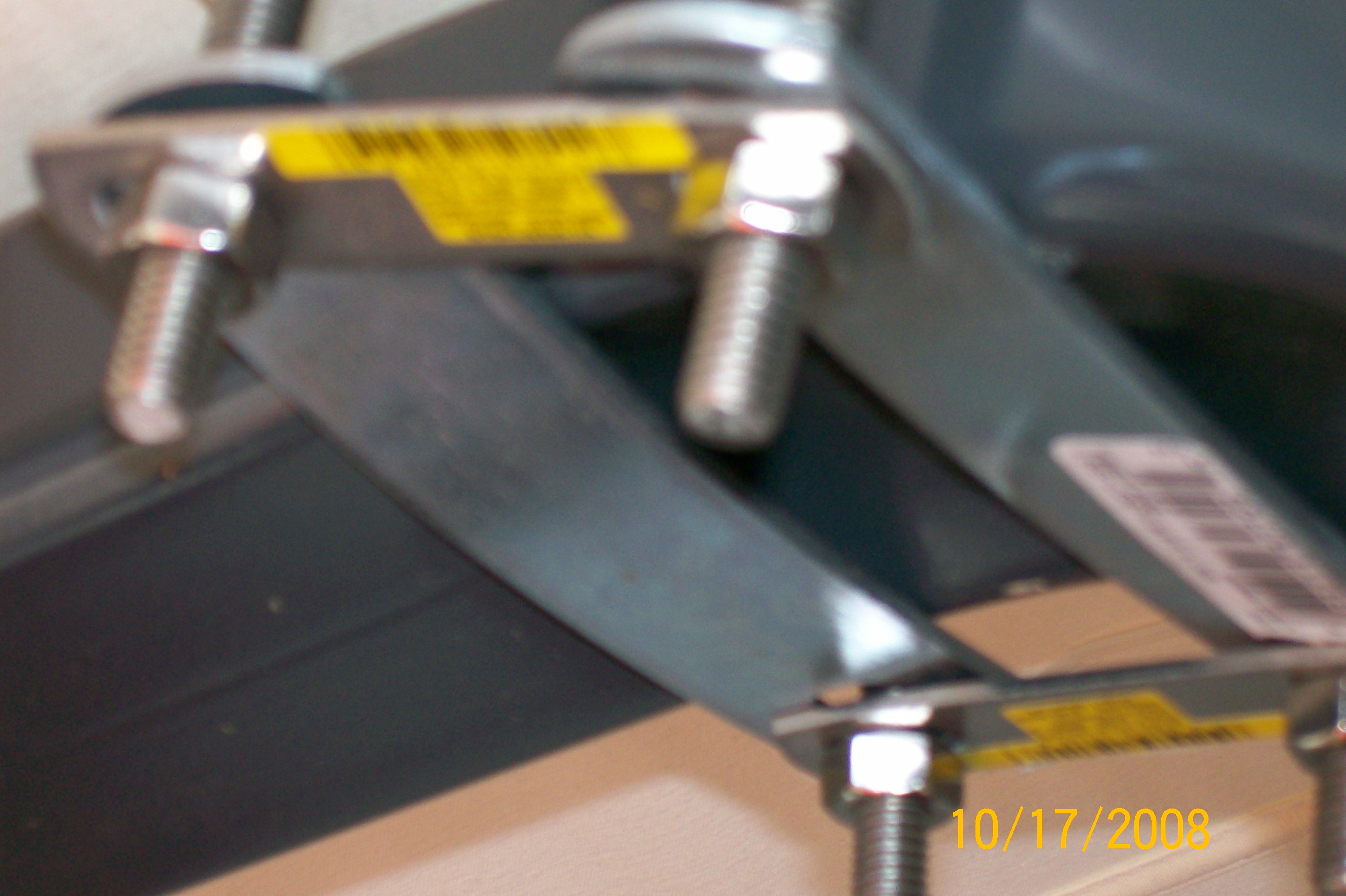

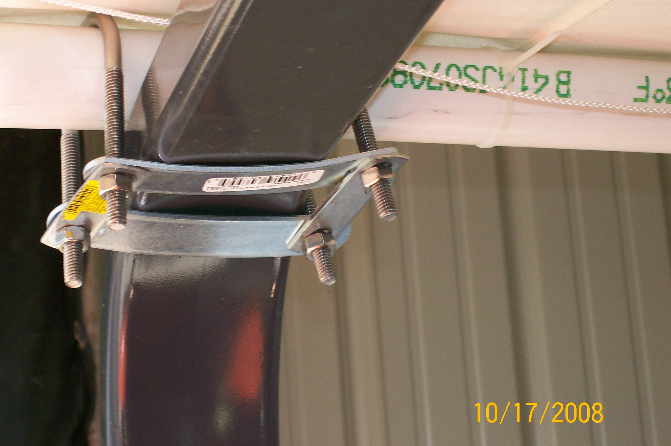

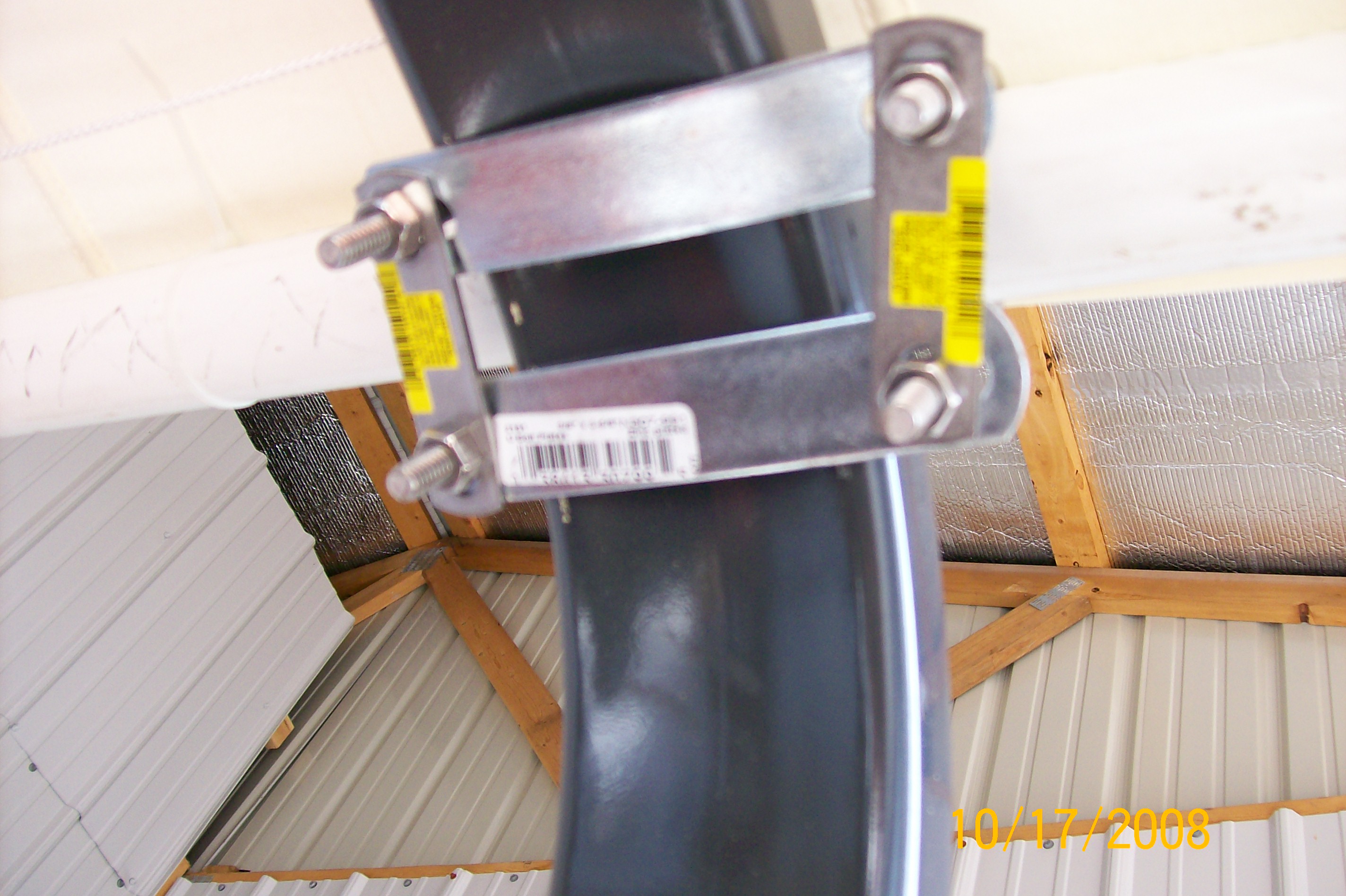

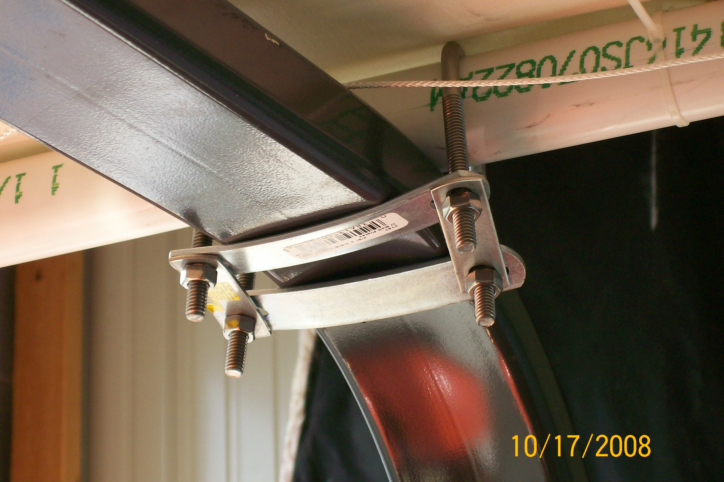

Here are pictures of the brackets I made/bought. They are stainless steel and the frame is schedule 40 1 1/2" pipe. Built one for my F and another for my BX2350. If I hit a limb the canvas slides out of the way and even if it tears it's no big loss. I just wanted cheap shade. I have the $400 cover on my L3240 and wish I had the money instead.
