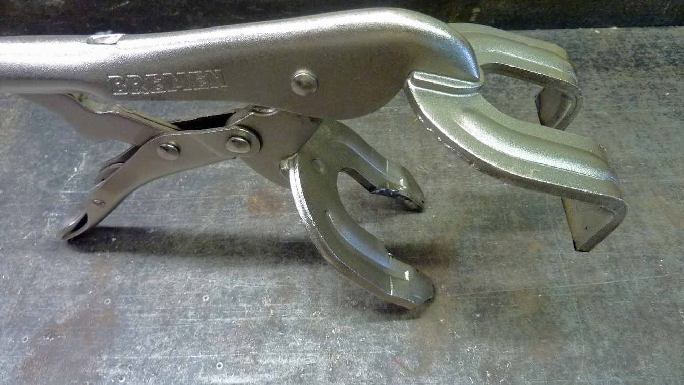

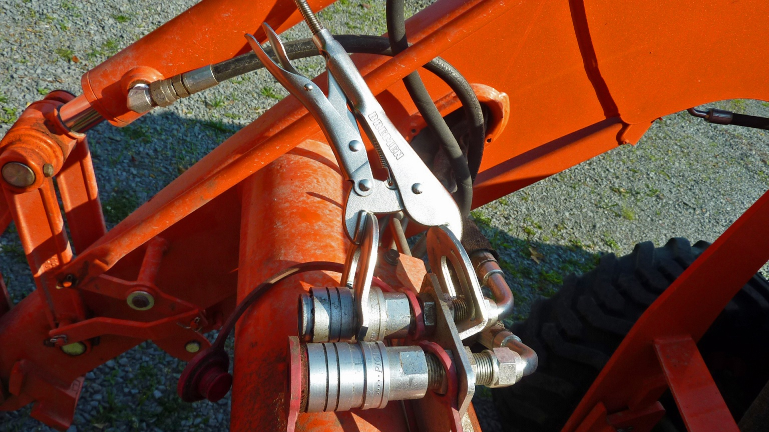

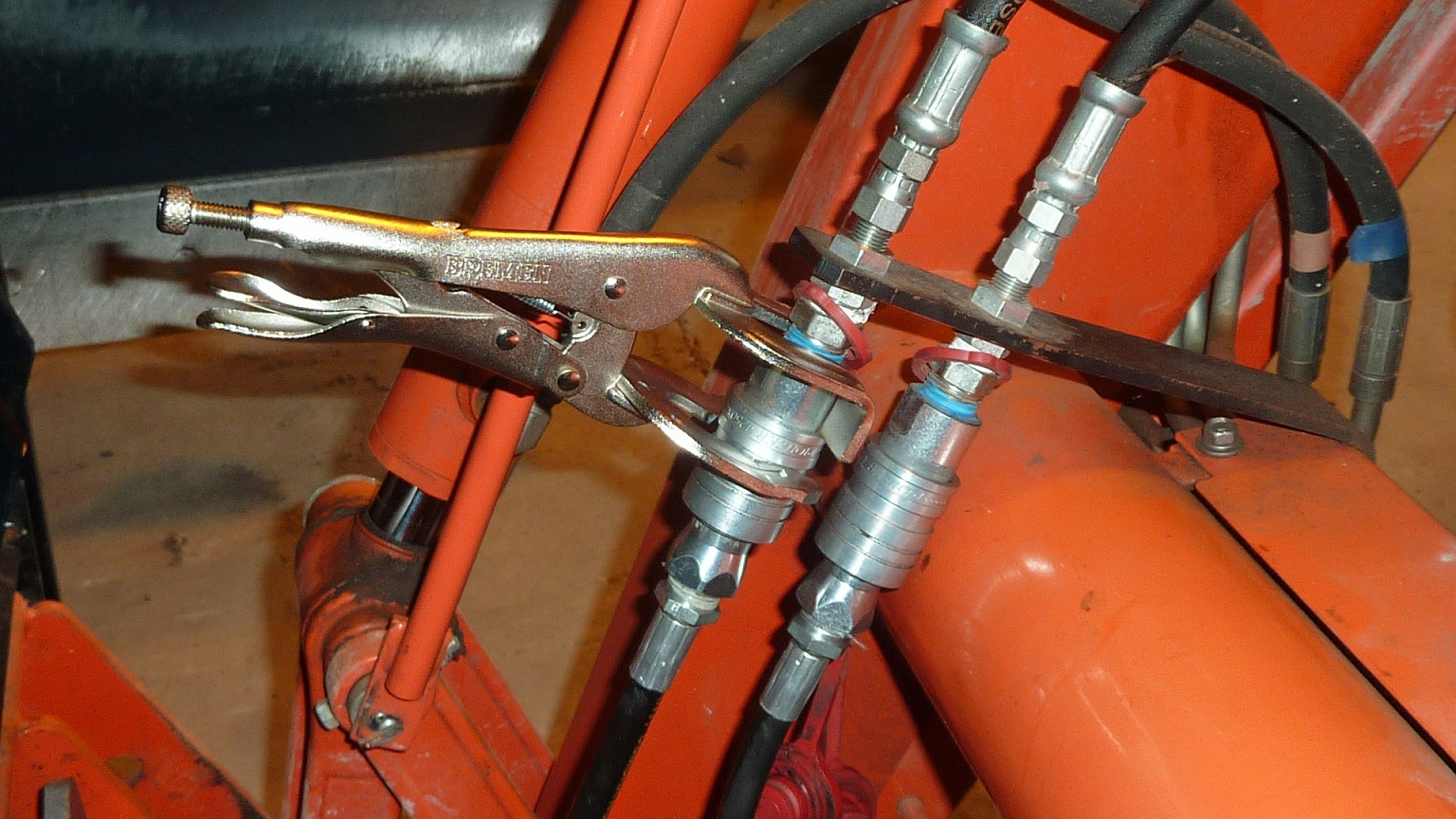

I've been fighting these sticky hydraulic couplers for years. The solution that works for me is this cheap welding clamp from Harbor Freight:
I used an angle grinder to open the jaws enough to fit the slot on the coupler barrel:
It spits a bit of oil but it even works on lines with some pressure in them.
View attachment 724441 View attachment 724442
Interesting solution!
