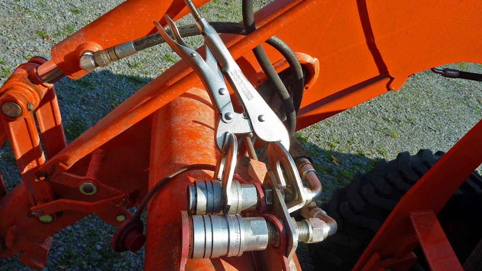

I figured I'd make a new thread other then my Float Thread. In my journey trying to disassemble my loader joystick. I can't disconnect my hydrolic. the collar will not slide up or down or turn.
Any idea ?
It's a 2008 and I don't think they have ever been disconnected before.

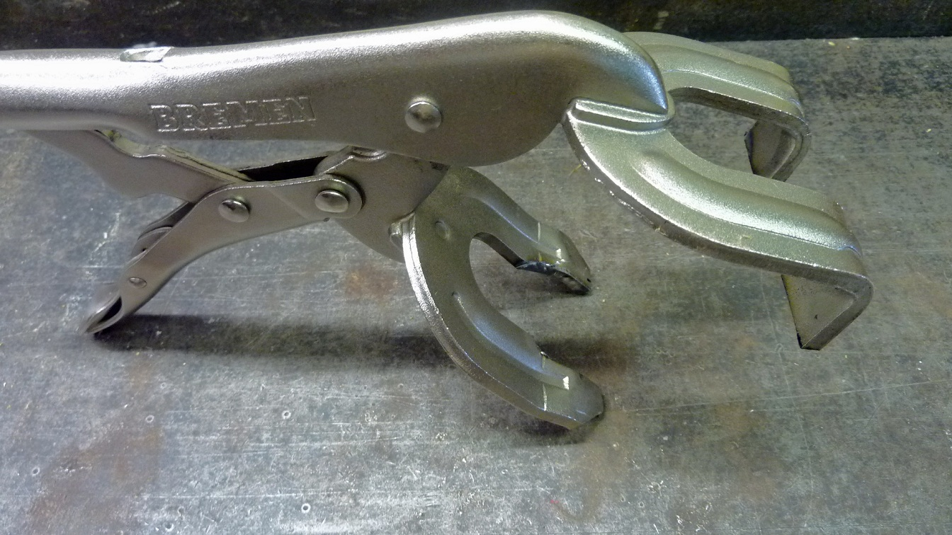

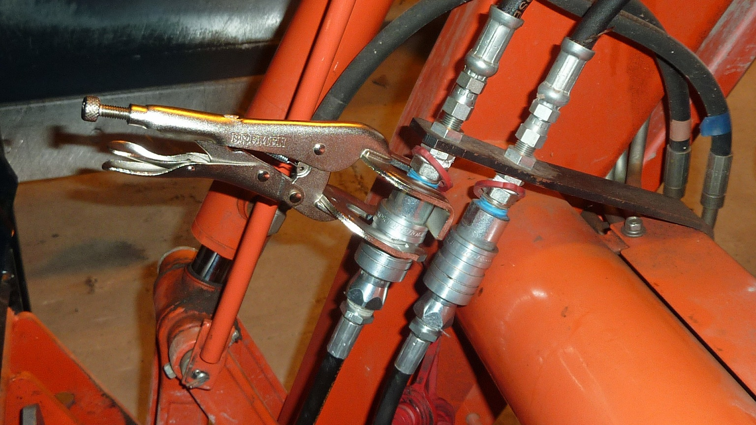

I've been fighting these sticky hydraulic couplers for years. The solution that works for me is this cheap welding clamp from Harbor Freight:
I used an angle grinder to open the jaws enough to fit the slot on the coupler barrel:
It spits a bit of oil but it even works on lines with some pressure in them.
