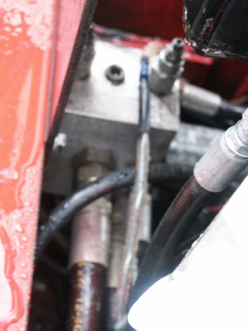

I have a 3/4" hose in a tight spot. It is hard to get anything more than a normal wrench on it. It sources from an aluminum block, into a fitting that has an o-ring The fitting then connects to the hose, the hose has a JIC to make it all happen.
Well the hose won't break free. I have tried nothing more than manual labor.
Anyone have any tricks? I was pondering hitting it with a smalll torch but the o ring, oil and the fact I do not want to ruin this hose are all playing into my angst.

I am trying with difficulty, to visualize you situation, How about a crow's foot on an extension long enough to get a nice long wrachet on it?
   / Can't get a hose to come off #3
If a small wrench will fit how about channel locks? You have to put a twist on the hose to break it loose. I would not use a torch. Pulling will break the cords inside the hose. Twist and pull .
Here is a very blury pic. The hose in question is coming of the aluminum cube. Actually it is under the small hose on the right (I can remove the other hoses). But it does not want to come off. I do not want to wreck the hose but I may just.
I was using a crows foot but not with an extension. Things are so tight in there... But I will give it a try.

If you can use a long extension, and you can get in the clear with the wrachet, or a breaker bar. It might give up. Otherwise you may have to remove the obstructions, or the block. Good luck.
   / Can't get a hose to come off #6
Carl, sometimes the easiest way takes the most work. Remove the hoses in your way. Put the longest wrench you have on it. Wack the wrench with a hammer. You want to hit it quick and sharp. It also may be easier and cause less damage to remove the other end of the hose first. Now, unscrew the fitting, with the hose attached, from the aluminum manifold.
Don't look for the easy way, there isn't one. Get all that other junk out of the way and give yourself some room to work.

Maybe a basin wrench used to reach up behind sinks?
   / Can't get a hose to come off #8
"Don't look for the easy way, there isn't one"
Good one!
I would get a heat gun and warm up the aluminum. It expands a lot so it will get bigger and loosen its grip some.

Hit it yes but not with a torch.
Put something about the weight of the hammer you plan to use behind the jic nut for a dolly and strike it opposite the dolly with a hammer to flex the female hose end nut.
This will dramatically reduce the amount of torque to break the nut loose.
I have used this on # 12 16 and 20 jics that I could not pull hard enough to break loose
Also sometimes you have to cut a wrench off to get in a tight spot, then pry or pound (use reason and judgement here) on the shortend end of it
