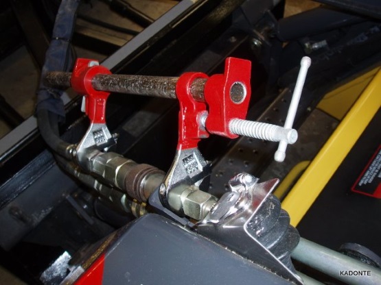

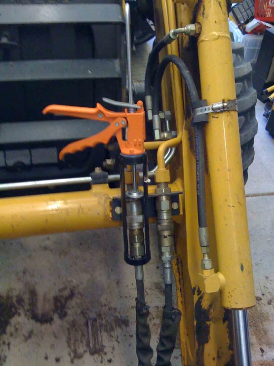

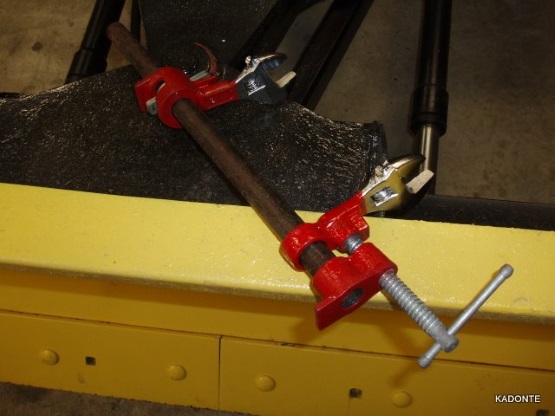

Here are a couple ideas from my projects file and this old thread: http://www.tractorbynet.com/forums/hydraulics/131755-help-my-stucchi-disconnect.html

save your self some headaches and put ag couplers back on. the clamps xfaxman made will work but you can damage a fitting if you put to much force on them.
