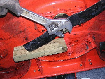

I was trying to go counterclockwise as per the manual... Man am i gonna be hacked if i wasted all that effort and the manual is wrong!! Let me know what you learn in the AM... Also where is a good place to buy a torque wrench and how much should i spend??
   / Can't get the @#*&@ MMM Blades off!! #12
Re: Can\'t get the @#*&@ MMM Blades off!!
Nilesw -
The old saying: "Lefty-loosey / right-ey - tight-ey" works in my case (so normal "right-handed" threads = clockwise to tighten)
I attached a picture I took once while greasing my spindles and rotating the blades. The picture shows me loosening the fastening bolt (pushing down on the left side = counter-clockwise).
I since have bought a 30 mm combination wrench - rather than the big adjustable.
Hope that helps! /forums/images/graemlins/smile.gif
Cheers,
Dan

Junkman is right on - The MMM blade bolts are right hand thread (on my deck, model RCK48-15BX). I use a 30mm half inch drive socket in my 1950's Craftsman breaker bar with pipe extensions as required by the stubbornness of the situation. Hanging the deck from the chainfall with appropriate blocking helps a whole lot.
Use same socket in my equally elderly Craftsman beam-type torque wrench to apply 90 Ft-Lbs per MMM manual. I always apply a tiny amount of grease to the bolts, partly to improve torque accuracy and partly to discourage siezing up in the future.
