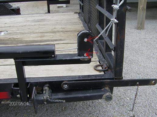

Like Oliver1655 said, You will need to put blocks under the back of a trailer with slide in ramps when loading it to keep from picking up the tow vehicle. Equipment trailers have legs on the ramps to prevent this from happening.
   / Car Hauler or Equipment Trailer -- What is the difference please? #18
I prefer hinged loading legs over blocks, shown here in the up (storage) position:
When down, on level ground (no load) they are a couple inches off the ground. When the weight is on them, simply back up a few inches to release them. When loaded, drop them down & pull forward onto the legs. ~~ Lowell
