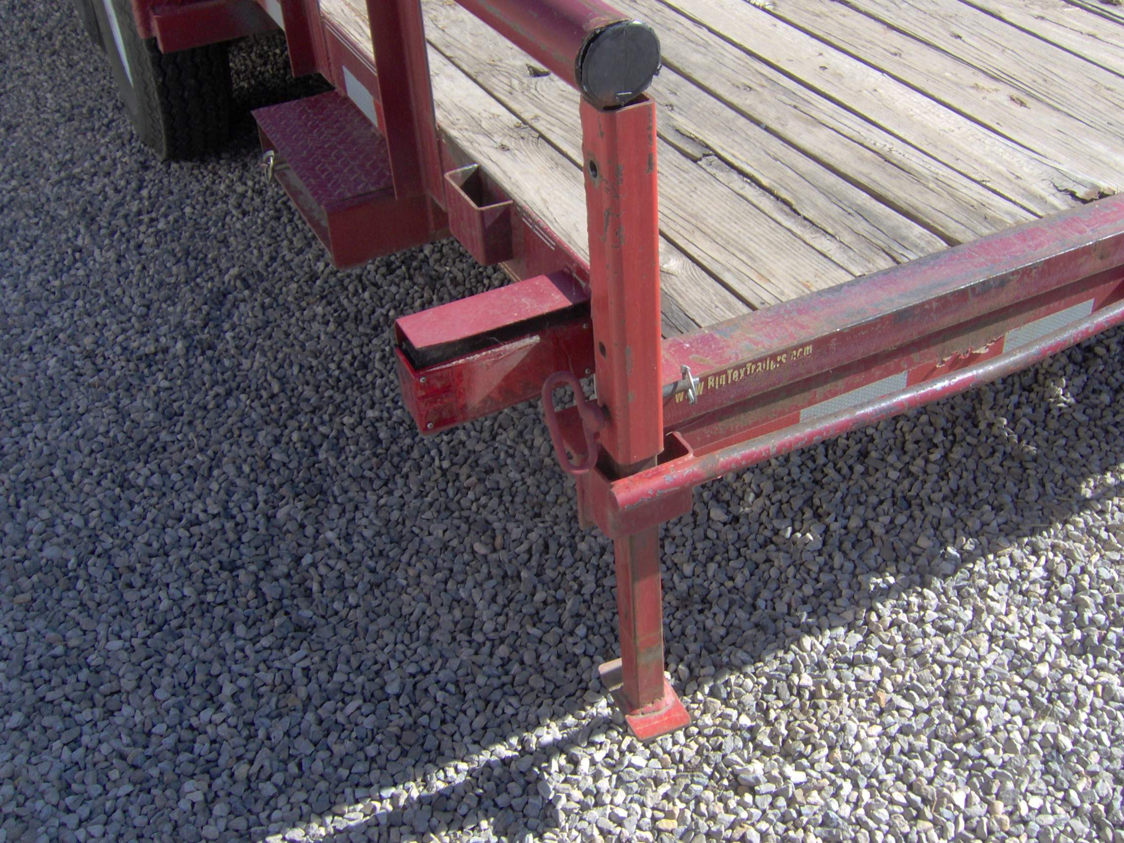

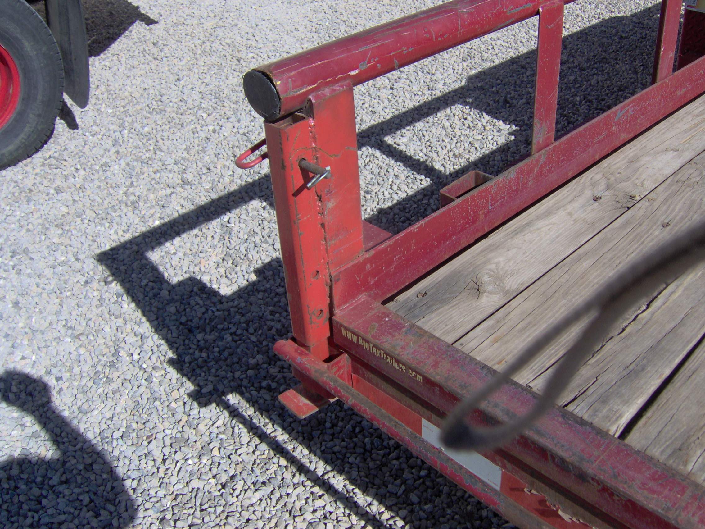

Here is a simple solution for loading stabilizers I added to my 12k trailer. Had these on the trailer for about 8 years now and this works well for loading my 8000 lb backhoe
I used 2" box tubing with 1 1/2" that slides inside of it with pins to hold them in place.
