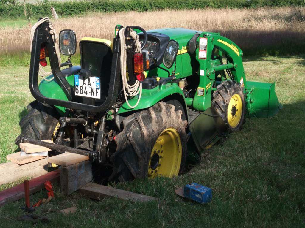

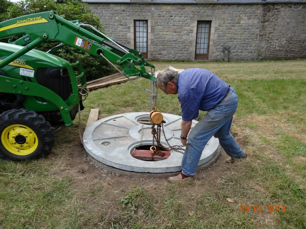

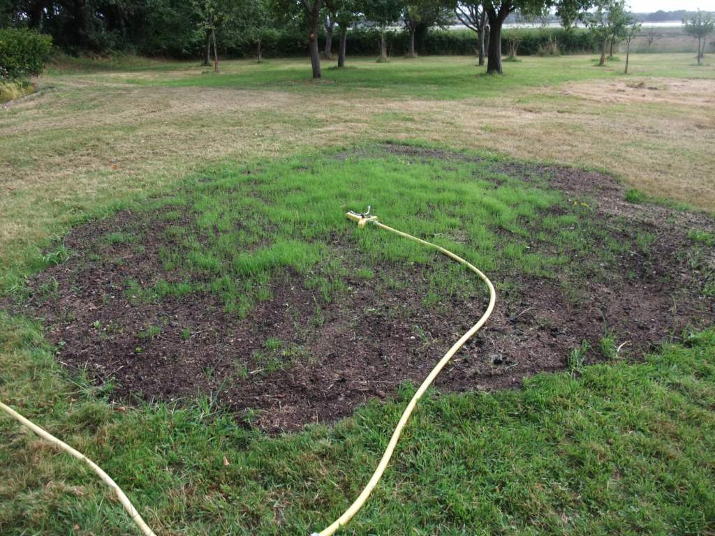

The only problem we ever had was when I drove the tractor through the lid of the newer tank and had to replace that big lid (2 metres across).
