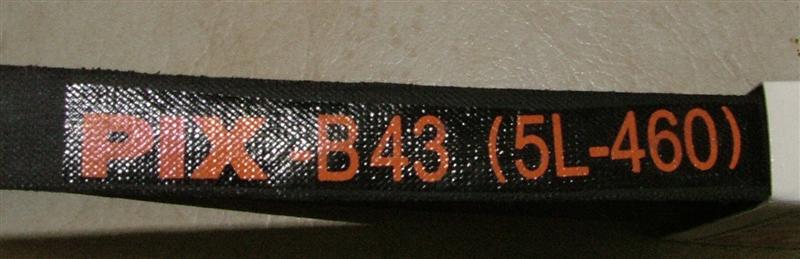

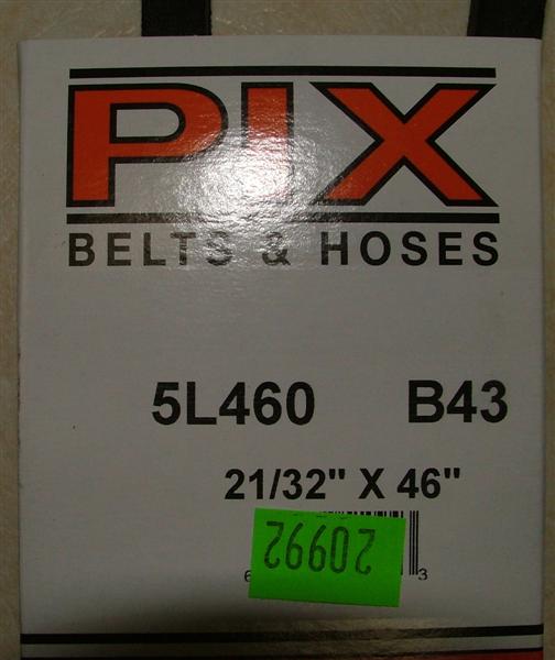

I received my new belts yesterday and they are the size posted in this thread.
B43 21/32" x 46". It does not have any metric size on the belt or the package. I'll post a picture tonight.

#78
Here are a couple of pictures of the replacement belts. They are made in......wait for it.......India:D
   / Caroni Flail Belt Failure #79
I presume the Gates equivalent B43 belts are US made. At $7.35 each they are hardly a big ticket item.
