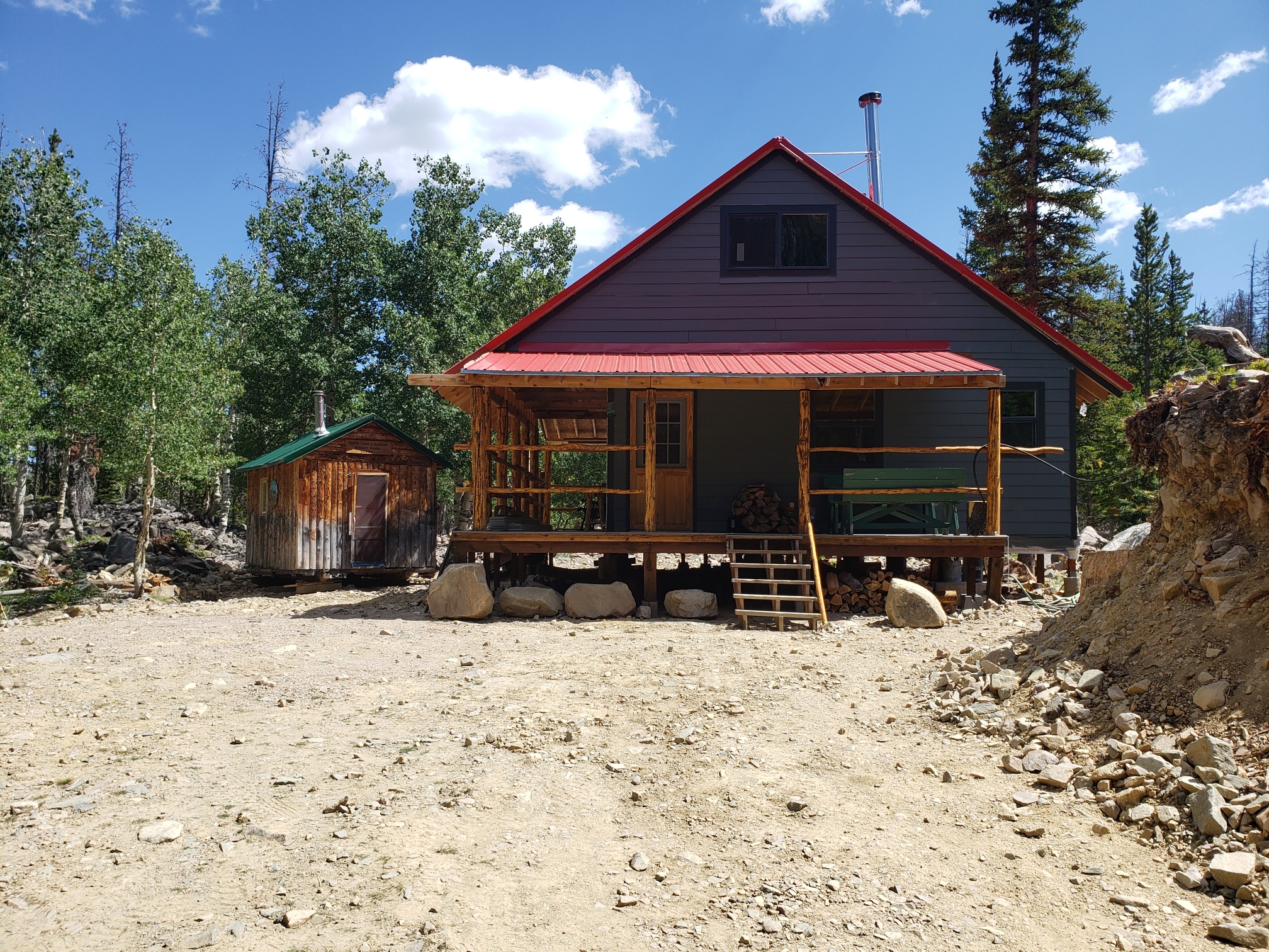

When I built my cabin, I hand nailed everything. We were in the mountains and I did not want a loud compressor going, I just wanted to hear the thud of nails being driven. Had a couple of young workers helping me, they could not hit a nail without bending it at first. By the end of the day, they were finally able to drive a nail square and true. Most carpenters today can't drive a nail square, it's becoming a lost art.
