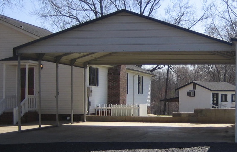

All, question what do you think this carport weighs?
I want to move it and I am thinking about moving it without taking it apart.
Its 24’x24’ and post’s are 9’ tall. The posts are 2.5” square.

I'd look on line for a similar carport to see what the shipping weight is.
I don't think weight will be your issue. The issue is that moving it will cause the frame to flex possibly tearing the roof around the fasteners unless you can figure out a way to stabilize it and go very slowly over a short distance.

I think this is spot on. I have the same carport. It used to flex in the wind before I welded steel gussets to the corners to stop that. But the roof sheeting started to tear around some of the screws because of the movement. It’s a pain but I think the best option is to remove the roof panels, then move the carport. It will be a lot lighter and easier to move also and no chance of structural damage.

Those carports aren’t that hard to disassemble. I might consider putting a piece of lumber at both ends for a spreader to keep the legs spaced apart and drag it but much beyond that you’d be faster to take it apart.

Have a 12x20 carport 8' walls moved a half dozen times around my property still standing no leaks very minor damage, I also moved a 20x24 12' high greenhouse off my polebarn still standing I did reinforce it with some steel extensively. Anyways I think if you can get two tractors lift it slightly on the base rails in the direction your dragging choke it under the base rail and a upright, and communicate well with the other operator you should be good. I can take pics of various reinforcement I did on green house before moving if you want. The 12' wide carport I didn't put extra reinforcement in it and used one tractor when moving. The green house I used one skid steer and a tractor and it was a straight pull. Good luck

Interesting....but personally I'd have used a heck of a lot more material to cross brace the carport before trying to move it.

Diagonal cross bracing in the form of an X would be more resistant to flexing that could cause tearing in the roof panels.

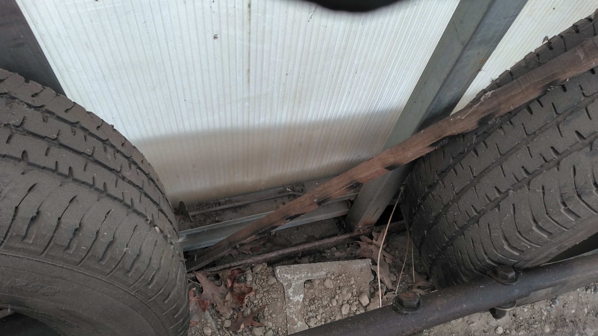

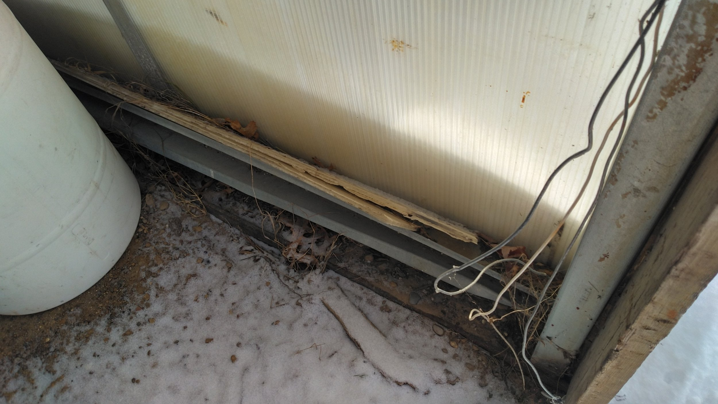

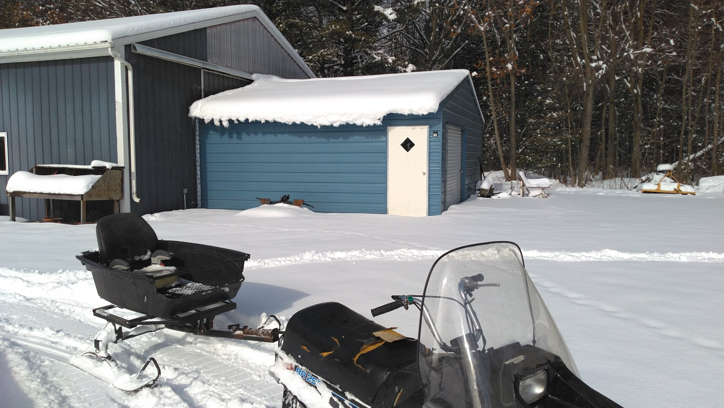

#7 picture of carport I've moved 1/2 doz times at least a few hundred feet in total. #1 and up are pics of green house I moved off the gable end of barn no pics of actually moving it out of learned mistakes I put phone and camera down when operating equipment lol anyways I know it's a lot heavier than any carport, had to cut lower uprights cause they were embedded in concrete, fortunately I had a lot of heavy gauge rusted repurposed angle iron lying around so I welded it around base and to cut uprights I also welded a piece of angle from the uprights below girder and welded srap angle diagonals in pic I removed center base piece I attached. To bottom of uprights left diagonals in place. One thing I can tell you is when moving it and it starts digging in ground stop immediately. Also when I moved green house I felt it may not make it but was ok if move failed and it came down cause other option was to tear I to down anyway I replaced green house on polebarn with another more usable structure. Any specific questions feel free to ask as my pics I took are snow covered and my explanation is probably lacking for some.
