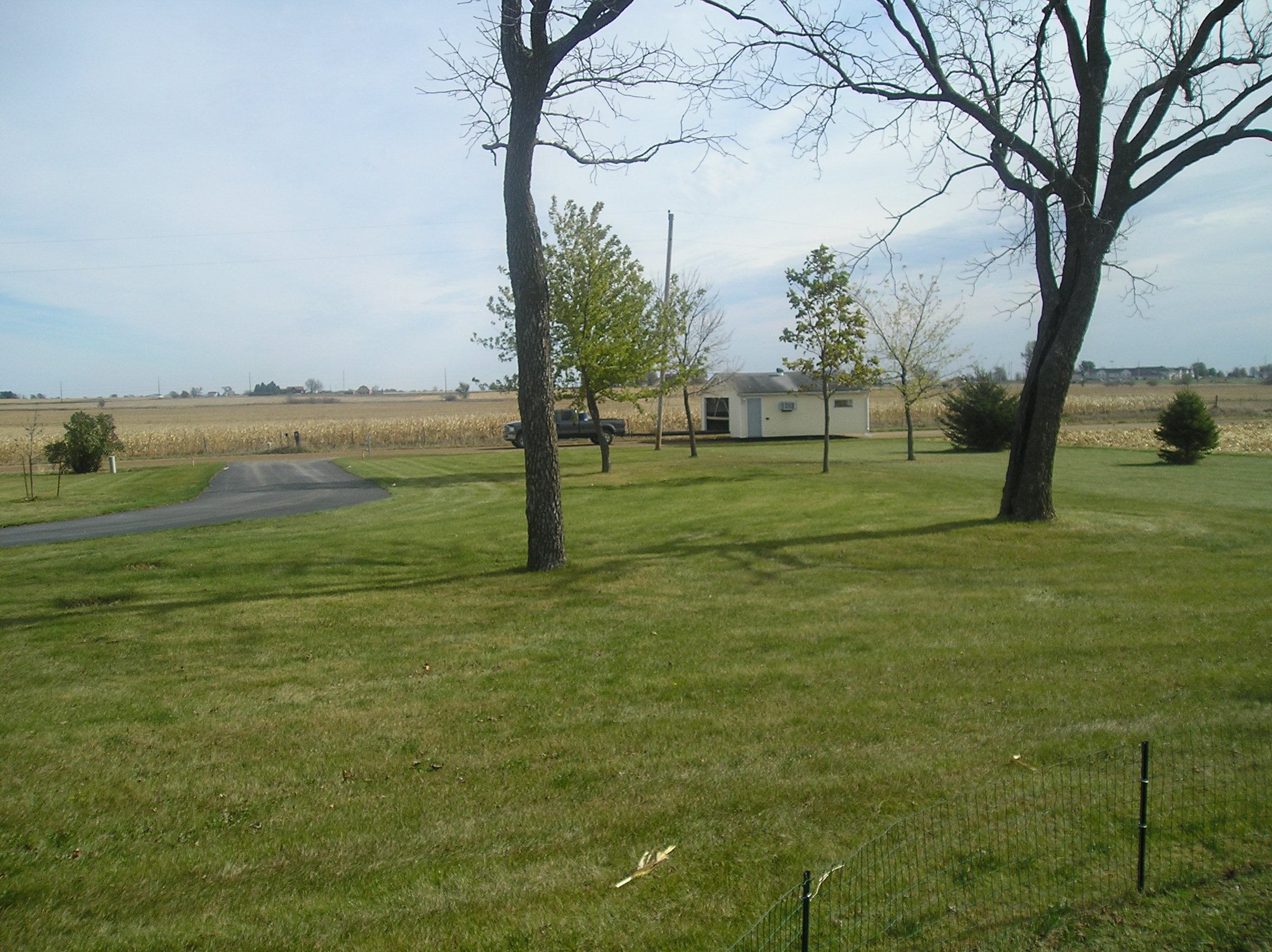

i would not try to road one, but for 200 yards i would exhaust every reasonable option to just skid it over. the base will have to be braced for x-y stabilization the z axis is the real question, it would be easy to wrack it by skidding it over too ruff of a path. also it is 24 x 24 so IMO to wide to put on a trailer. IMO if the path is not too ruff and it can be reasonably braced to skid it that is the way to go (you can x brace to stiffen the z axis).
It will fit on a trailer, buildings are trailered quite often. I have a 20x24 garage that was delivered and set in place.
Here is a pic of the neighbors 16x24 garage going down the road to it's new home.
