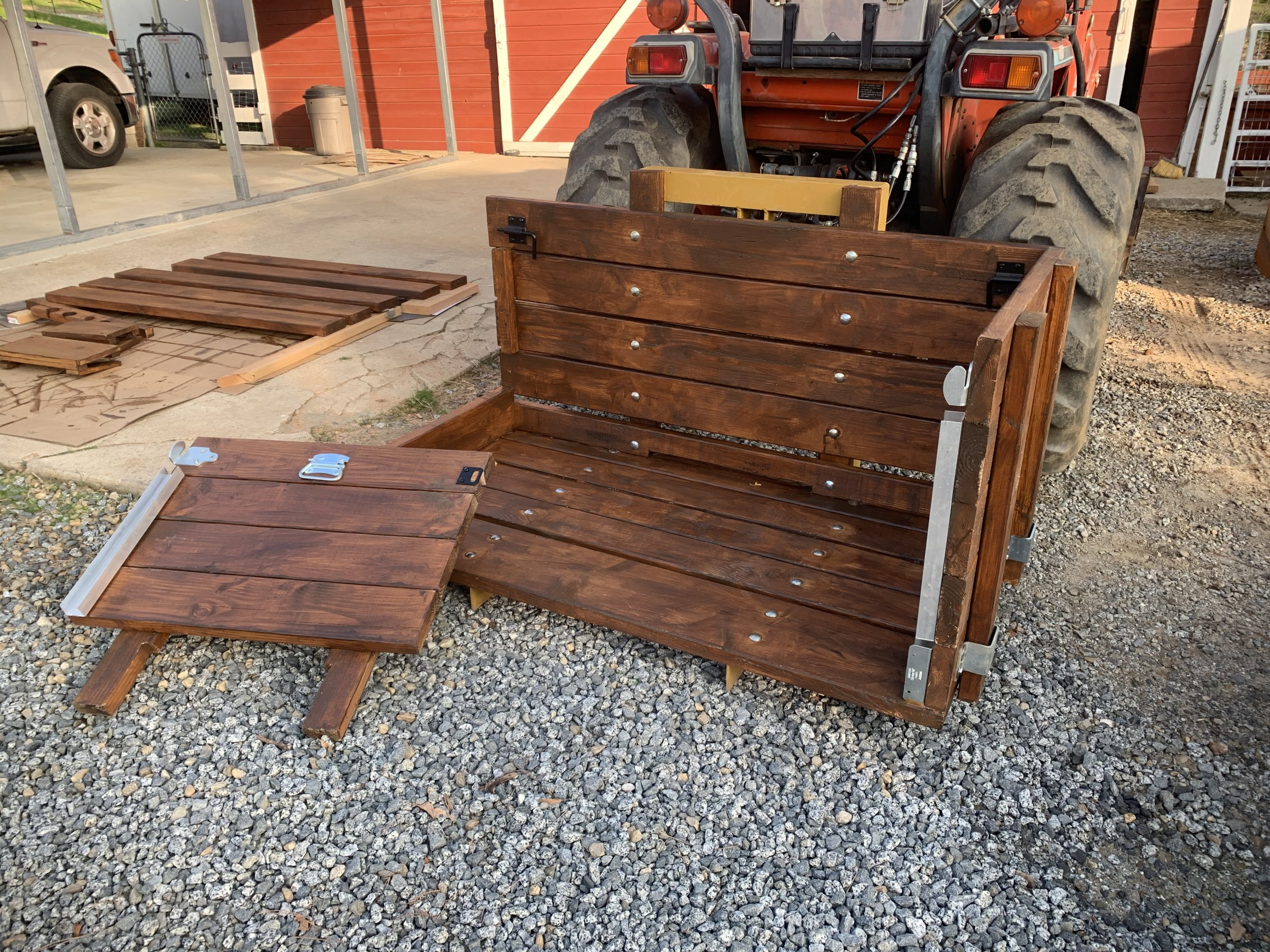

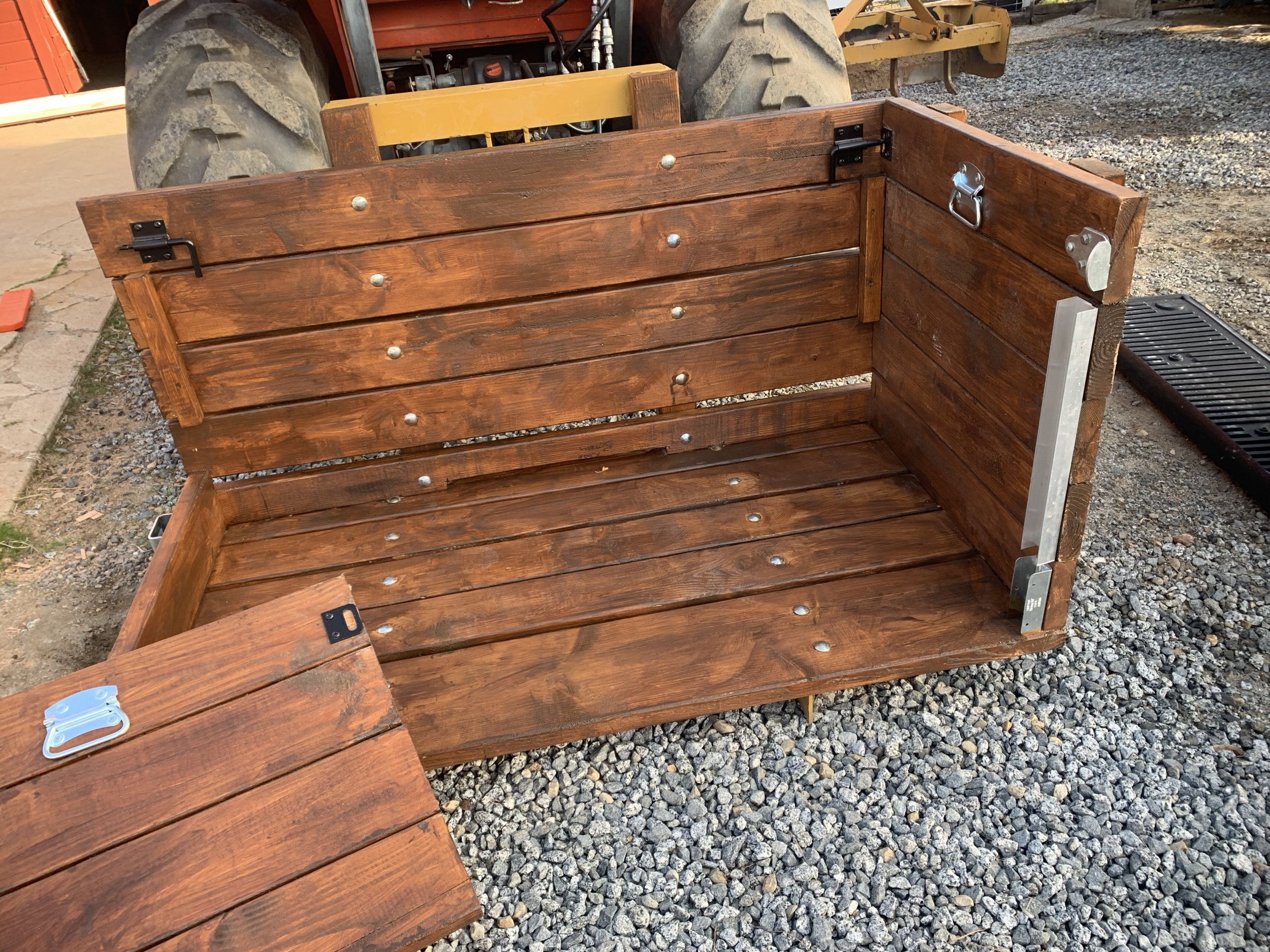

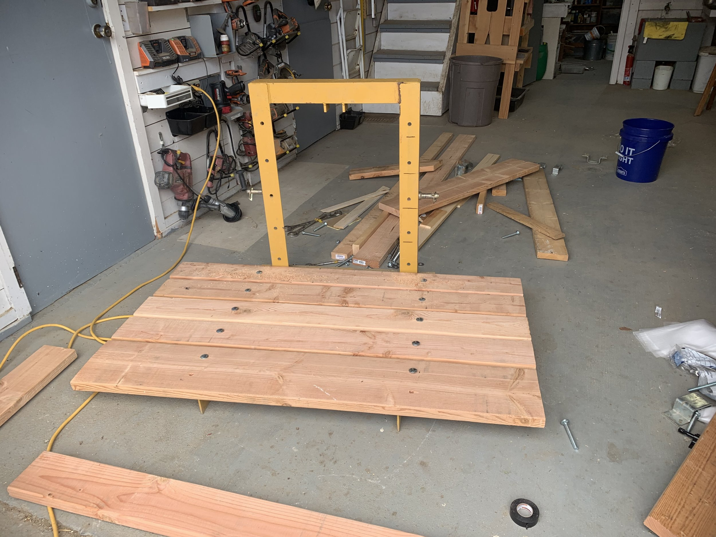

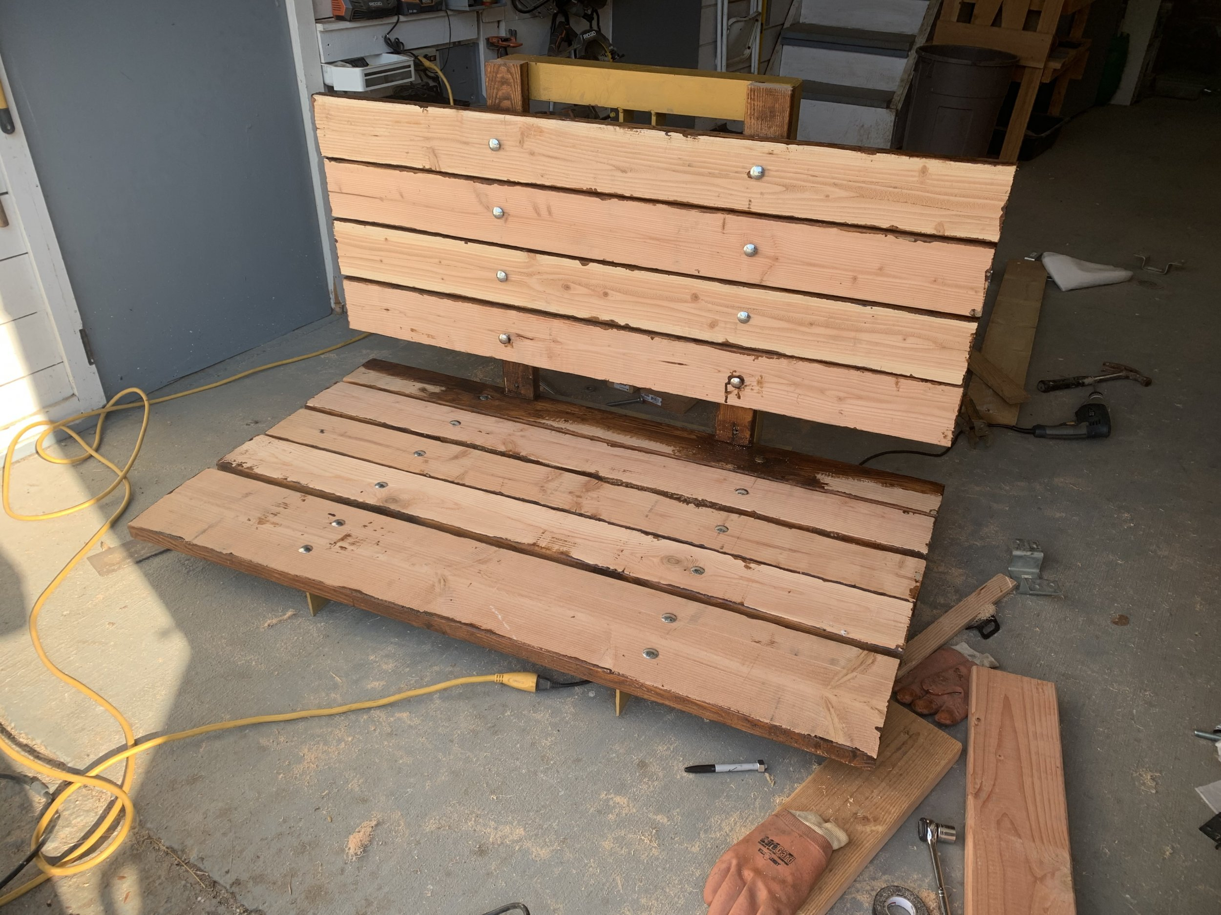

I have had a TSC carry all frame for a couple of years and finally got around to adding a 'box'. I made it so that the sides come off but latch securely everywhere, and the front can be closed up with 2 x 6 boards in "C" channels (made from two alluminum angle pieces). The tops of the removable sides are tied together with a top board with stake truck 'latches'. There are chainsaw scabbard sleeves on the back side and a shovel, handled tool rack (added after I took the pictures). The wife said it needed to be stained - so she did that. It has already been used several times, and when the granddaughters came up I added a bench so it then also became the 'ranch uber'.
I will try to attach photos.
