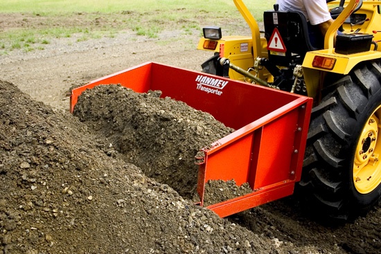

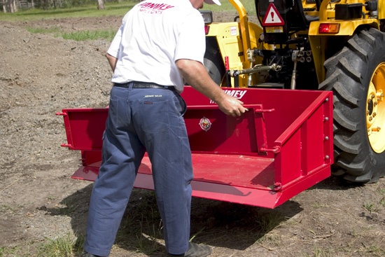

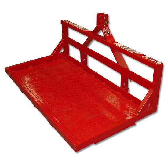

I'm looking at options for carrying around the yard ; carry-alls and
boxes. Empty weight is around 200lb for this stuff . What do you reckon
I could load this up to ,on a 1650lb BX2360 with MMM and no front weights ?

Using a Carry-All is like using a FEL with out a weight box on the rear. I have used the forks with up to 750lbs with out front weight and more with the FEL on. You'll have to do some testing to see when you have to much and a need for front end weight. Be careful when doing this.

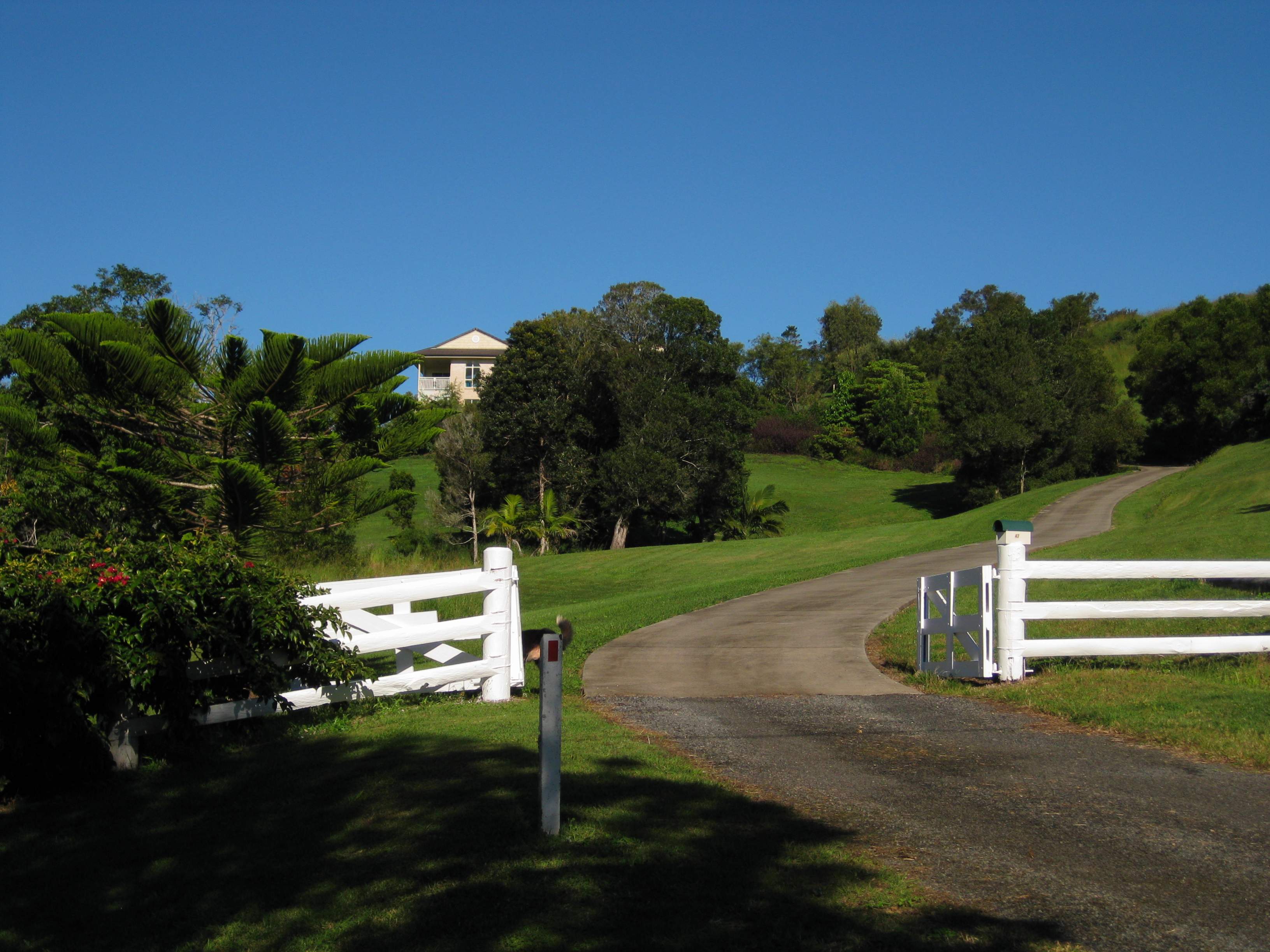

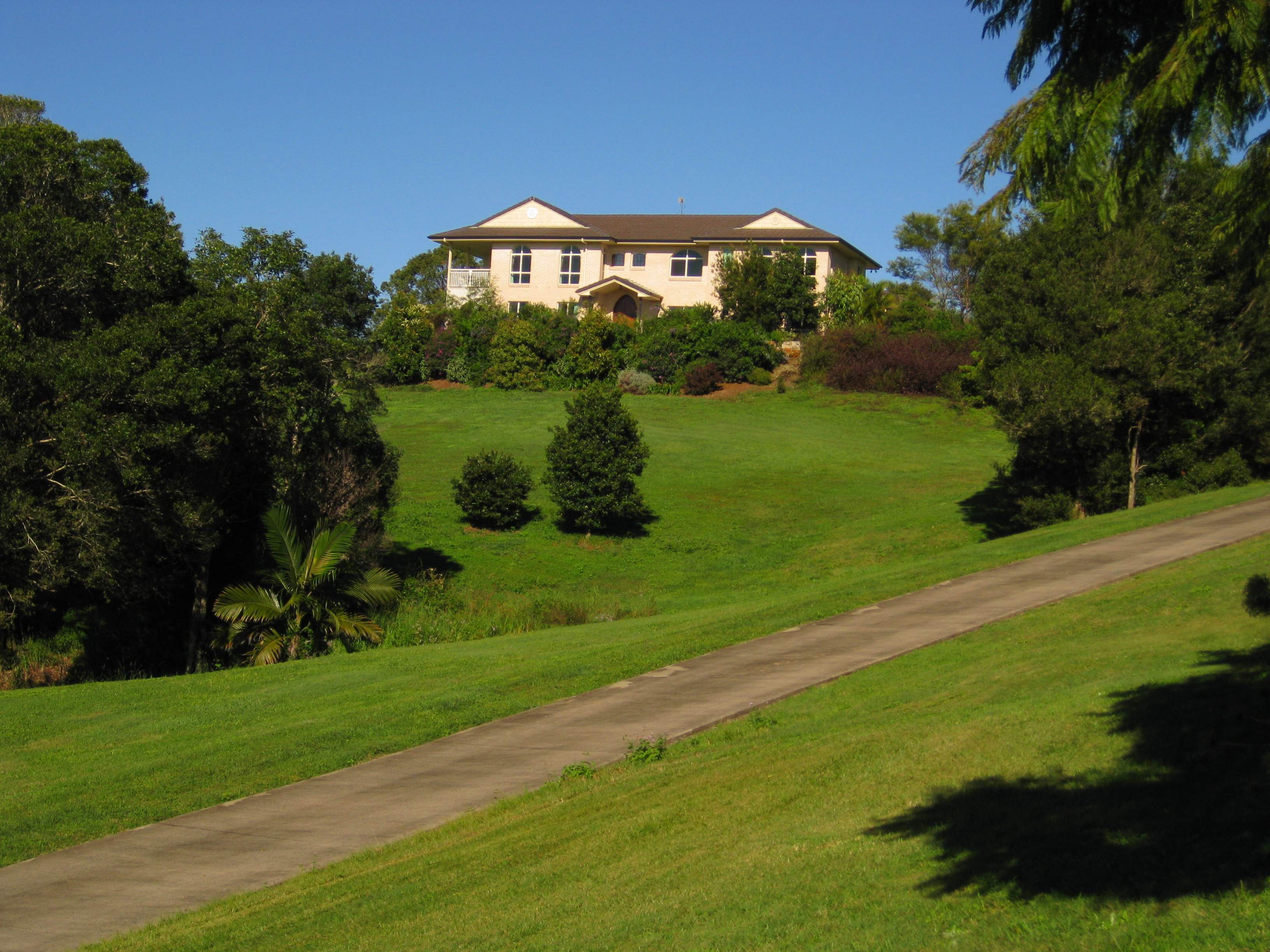

750lb minus the 200lb of the add-on is well more than I'd
probably load . I was thinking 300lb of compost/water for planting
around the place. Your 3 rail-sleepers looks enough of a comparison
for me .:thumbsup: There's no water down the front , unless I pump
out of a pond ( don't have a pump since there's no fire hazard up
here ) so need to water new plantings for 6 months until the summer
wet begins in January. Doing a tree lined drive .

Without a FEL on the machine I'd be cautious to carry too much weight going up that driveway. If you get too @$$ end heavy you will lift the front tires off the ground and loose steering. (Keep the carry-all as low as you can and it'll at least act as a wheelie bar. :)
