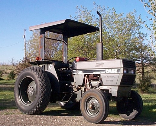

ps: Attached is a picture of my "new" tractor - a CASE 385.
