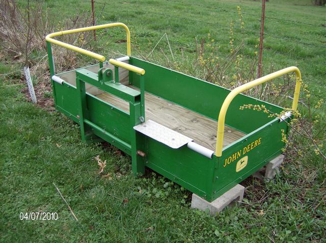

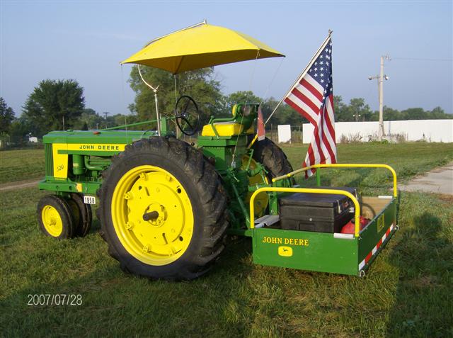

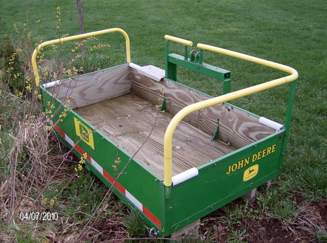

Where did you get the steel Carry All Frame that matches up with the iMatch quick connect? I have been looking for one of these, and they never seem to completely align, with out requiring extensive modifications.
   / Carryall Build with Photos #27
I made this one for tractor drives! Bought an old frame at a farm auction for $5, threw the rotted wood away. Had to do just a little repair on the original frame, then welded the outer frame up, added the CCA plywood floor & sides,paint & decals. The top rail is 1" plastic conduit. It too, has a 2" receiver hitch on it.
Don't do the drives anymore, and have sold the 520, so I really don't have much use for it now! ~~ grnspot110
