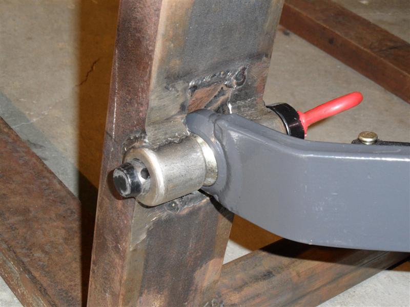

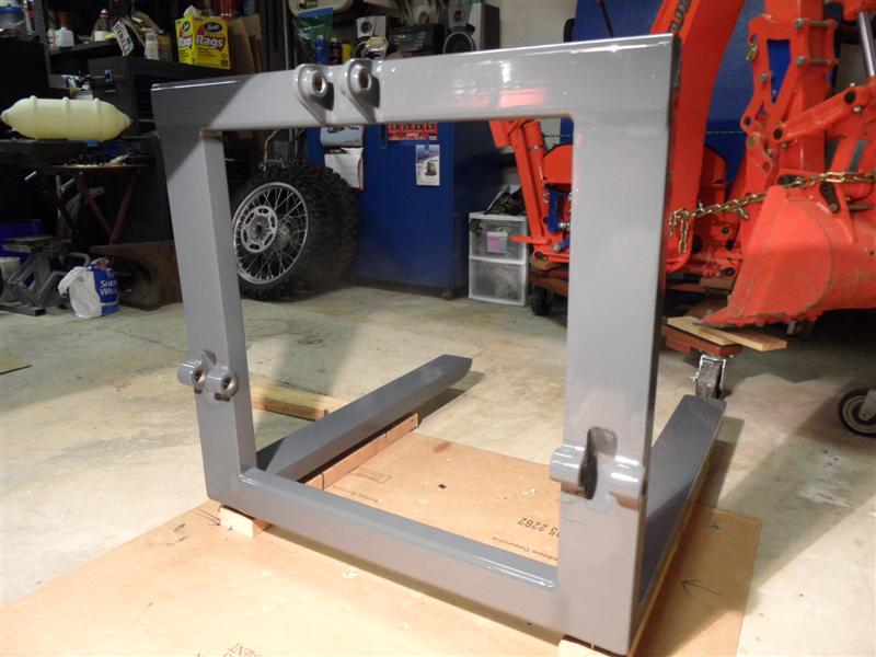

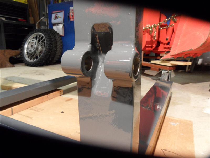

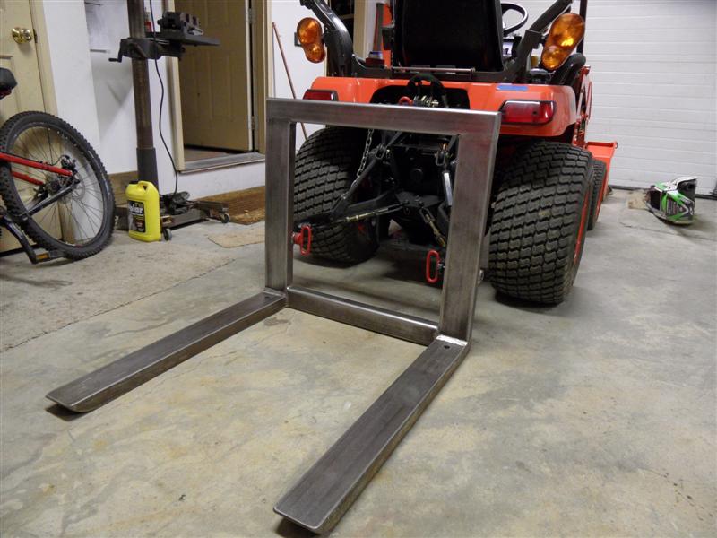

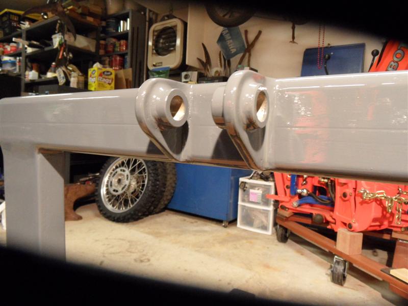

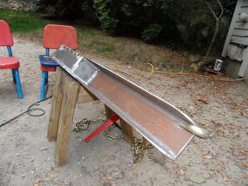

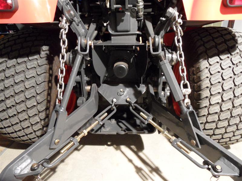

Got the prime coat on last night and will start work on a box & dolly for it next week.
The forks and the verticals are nested C channel, the pin receivers are DOM tubing, the cross bars are 1/4" wall box, and the elbow was filled and welded with scrap to stiffen it up. Most parts out of the scrap pile in the shed.

Looks to be very heavy duty. Suitable for a much larger tractor.
Better over-engineered than under.

:thumbsup: It's pretty. You going to drill more holes in the arms to attach a floor?
/ Carryall update #7
Very nice job!
If you don't mind me asking what did the materials cost for that puppy? What size channel did you use for the forks and how long are they?
/ Carryall update

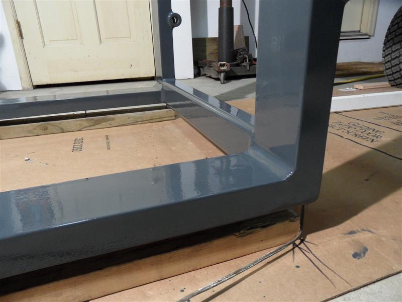

Thanks all. Like most of my projects it took longer than I thought, but is just in time to move the wood around for the bride . . .

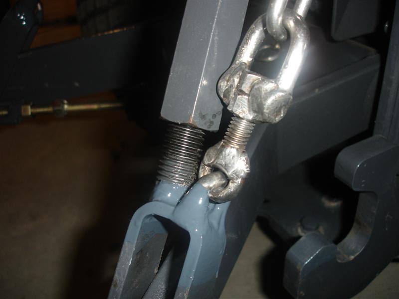

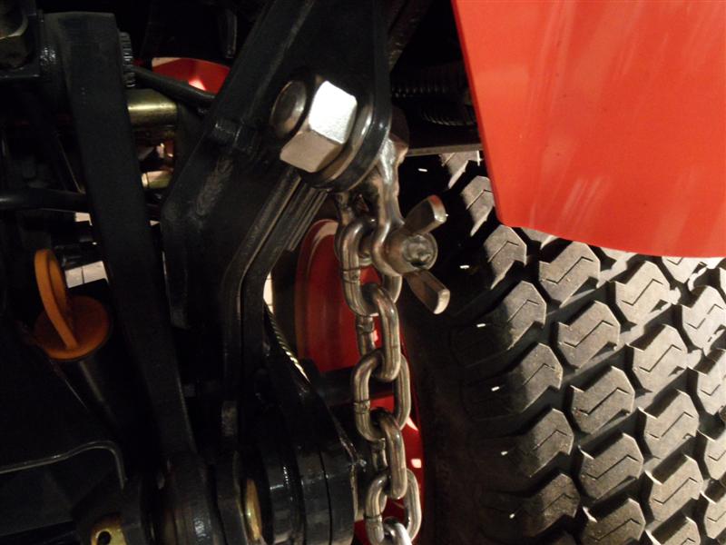

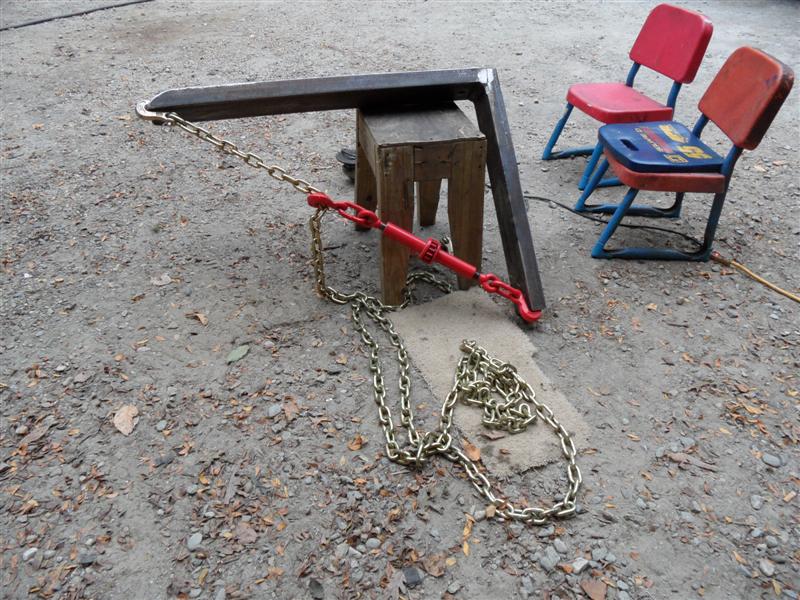

GW; Way overbuilt for sure (my back tells me it's over 100lbs). Despite trying to offset weld shinkage when I nested C channel into the bottom of the forks I had one bend a bit - off 3/16 at the tips. Had to heat it red hot with the torch and beat it like a red headed step child with my biggest sledge to take the bend out. Am sure the lower linkage would fail before the forks. Built with scraps on hand so was not 100% by design. Also set up some adjustable chain with an equalizer link made from a shackle, bolt & two nuts on one side to level out the lower arms - all SS :thumbsup:

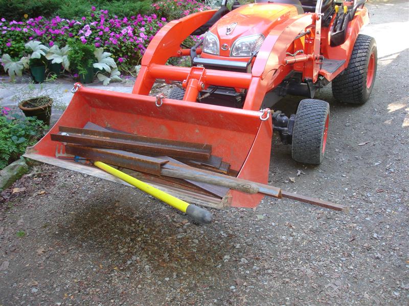

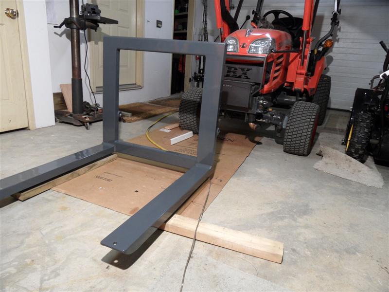

4300; Not sure on the floor & carrier design yet but by the time I'm done those forks are gonna have as many holes in them as my ROPS . . .
The back and sides will be removable, and a swing door also to be locked closed or open - maybe 44 x 44 x 36 tall. All out of 3/4 marine or MDO. Outside painted, edges sealed with epoxy, and inside sealed and left natural as it will get beat like a rented mule. I have four low profile SS tie down loops to mount on the sides of the carrier to anchor barrels or gear when the sides are not on. Would also like to figure somthing to carry rakes, shovels etc.

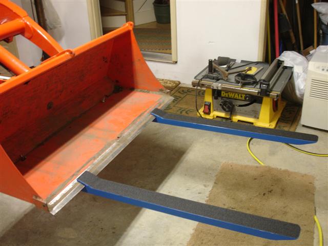

Easygo; Couldn't tell you the material cost as most of it came out of the sheds. I got DOM tubing from Speedy Metals online. Little pricey shipping steel but in most cases it would cost me more in personal time & gas for small quantities. I get bolts & misc fasteners from The Bolt Depot. Pins came from TSC online
The fork channel is 4" x 1 3/4" x 1/4 x 34" long. Bottom has smaller channel nested in it from the elbow to 1/2 the length. as long as I don't load the tips, the tractor would probably tip over before the forks fail. On the list is a precast slab of concrete ballast (I have 7 bags of sakrete I've got to use up before it craps out on me). Also will cover the tops of the forks with 3M skid tape - the stuff is pretty tough - like I used on my front forks.
