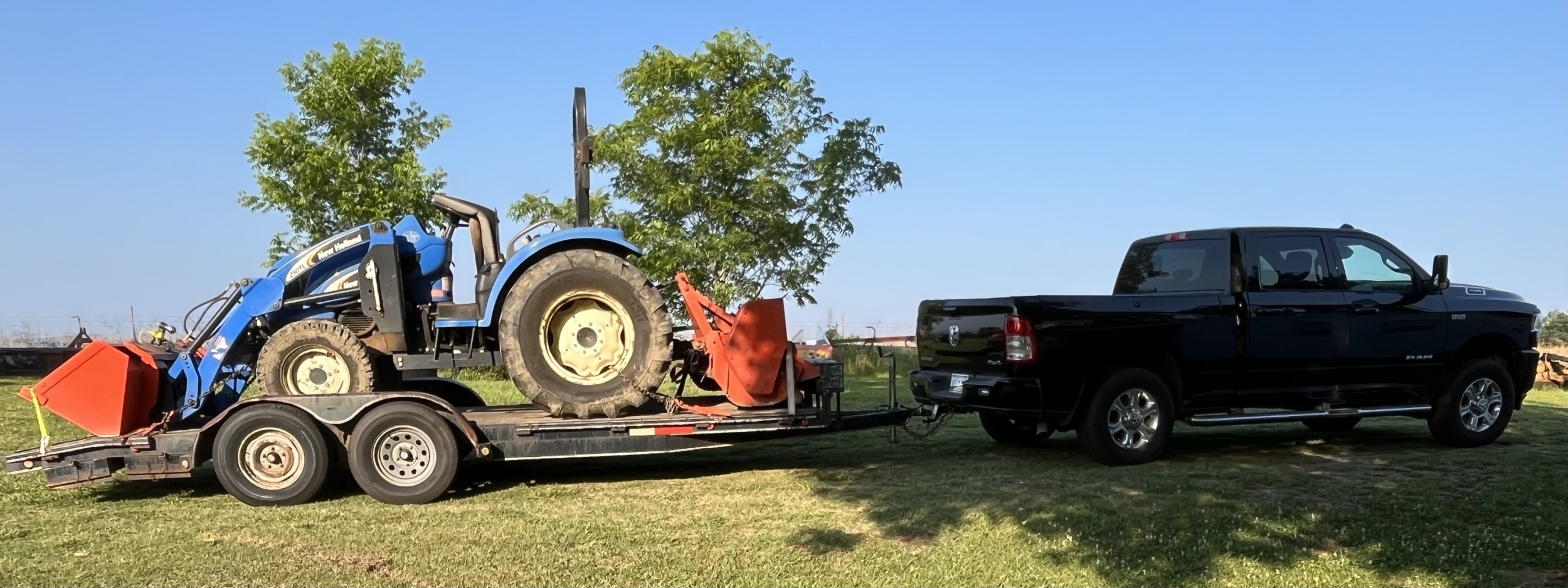

I regret the day I bought a 18’ 7k pound trailer that weighs 2500 pounds back in 2003.
Truthfully it 4500 pounds of payload.
The other issue is it’s to short to really position the load for proper tow weight with equipment (flail mower which is way shorter than your bush hog) and tractor.
That said I have hauled way more than 4.5k pounds.
think a 20’, 22’ or even 24’ would be fine. At least 6k axles if not 7k.
However, on the cheap you could get 5200 pound axles.
My setup with my TC45 w/ loader and Ford 917 flail.
Tractor weight w/ loader, bucket & flail: 6520 lbs.
Note I run load range E tires and trailer has 5” frame rails.

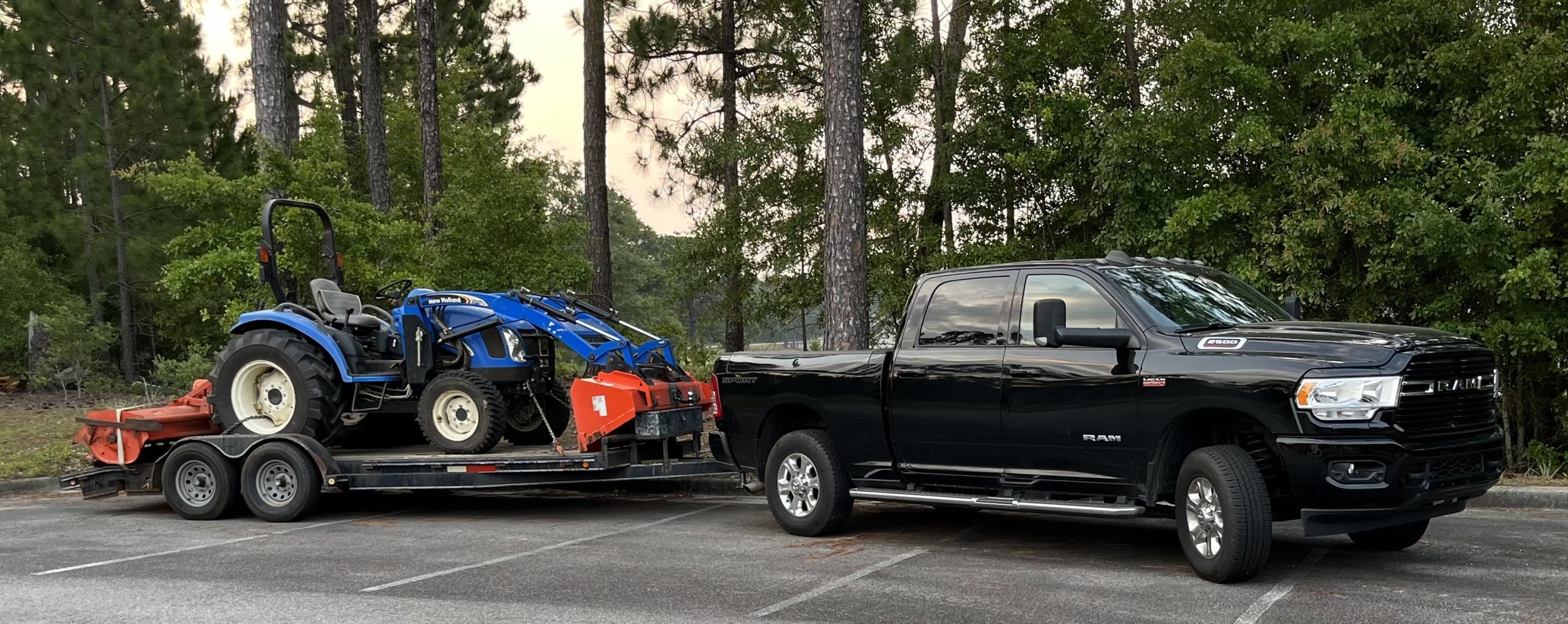

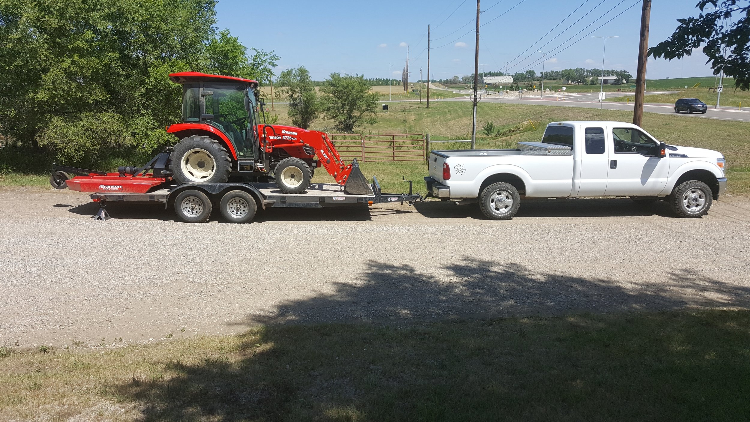

I have a chance to get a Quality Steel 18 foot tandem axle car trailer with winch. I think made in Decatur, IN. It has a steel deck. The axles are both rated at 3500 each for a total of 7000 pounds. I think the trailer with winch could be near 2000 pounds. I would like to carry my 45HP Mahindra 4510 cab tractor, loader and 6 foot Bush Hog brand mower. The tractor combo would go near 7400 pounds. Would this be overloading the same?
I never travel too fast and generally not more than 20 miles. The trailer is not a tilt but has steel ramps. Would they stand the weight?
My advice would be to pass up that trailer.
I can't be sure how much it would weigh, but I can assure you it will be much more than 2000 lbs.
I have an 18' car trailer with a wood deck, and it weighs 1900 lbs. With a steel deck that's at least thicker than tissue paper, you can expect at least another 1000 lbs to that. And the deck will be too short for a 6' brush hog on a loader tractor. How can I be sure, you ask?
Simple:
This is what it will look like.
I would also bet that your tractor weighs more than 7400 lbs, if the tires are filled with ballast. Mine, the one in the picture, weighs 7100 lbs as it sits in the picture. I know the weights on these things because I have weighed them all on a certified CAT scale.
I suggest you look at bigger and heavier duty trailers. My next one will be a gooseneck deckover at least 30' long (34' would be better) so I can bring a couple extra implements if I need to.
