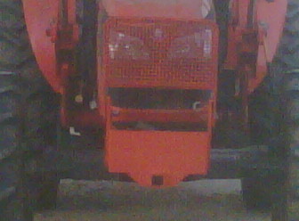

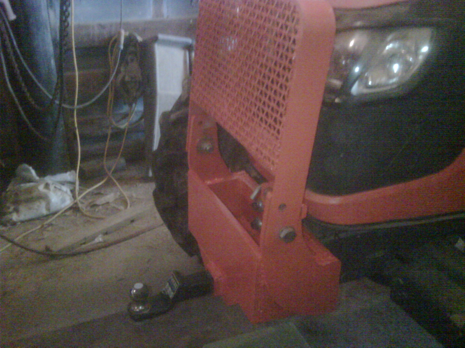

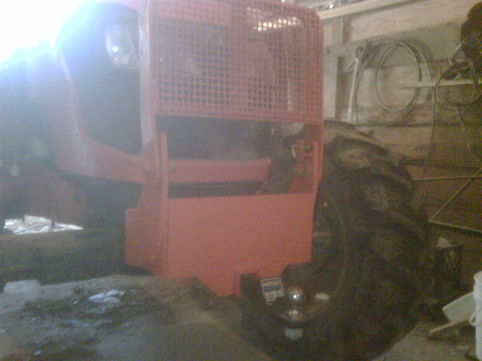

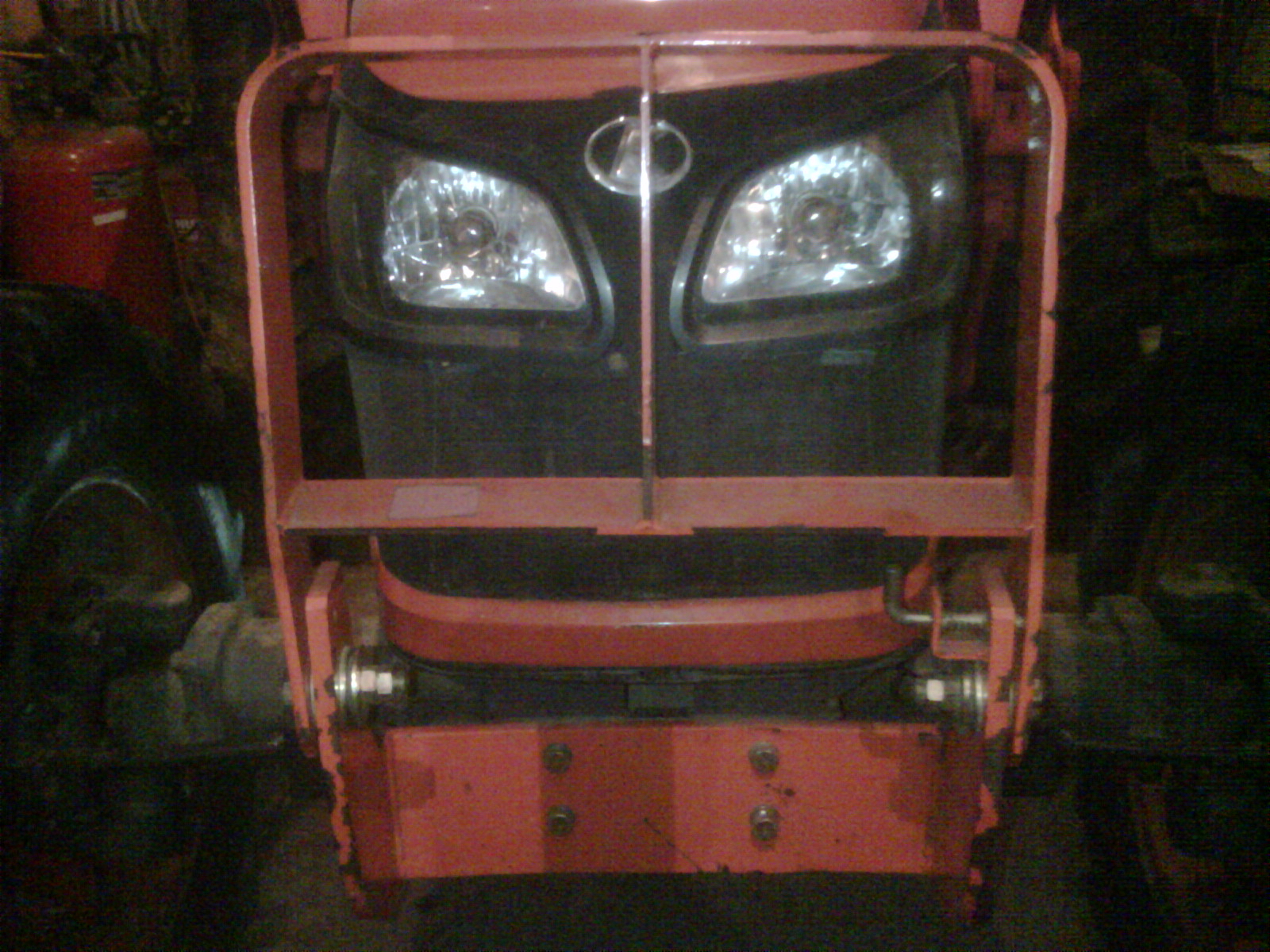

Modified my brushguard on my M9540. First pic is before, the rest are right after I painted, but haven't put the chains in yet. I keep a 3/8" chain approx. 15' long, a 5/16" chain about 8' long, and the reciver hitch in the box. I also, needed more protection for the front of my tractor when using my grapple. I still need to fill in the area b/t my box and the expanded metal.

   / Carrying chains??? #25
That is a nice modification. Good idea about putting the receiver hitch there too.
I'm going to have to steal your idea for my next welding project...if I ever finish the projects my wife has lined up for me. :laughing:
   / Carrying chains??? #26

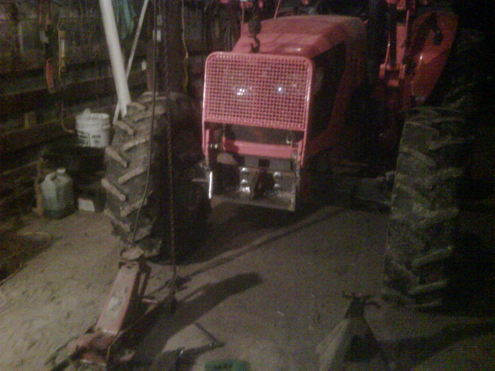

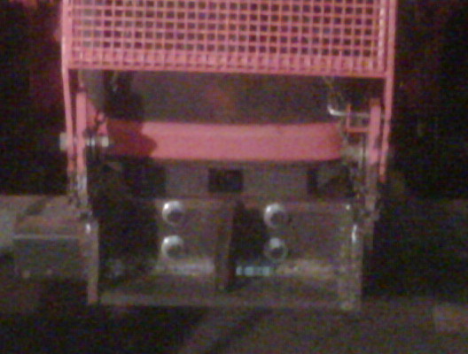

Thanks, I figured you never know when having a reciever there would come in handy. Good luck, my wife keeps me with honey-do's also.
FYI...The chain box is made of 3/4"x6" flat bar on both sides, back, and bottom with front piece being 3/4"x8" flat bar. I wanted it to be heavy duty and I had the flat bar left over from another project. In the attached pics you can see the back, sides, and bottom before the front and reciever were welded on.

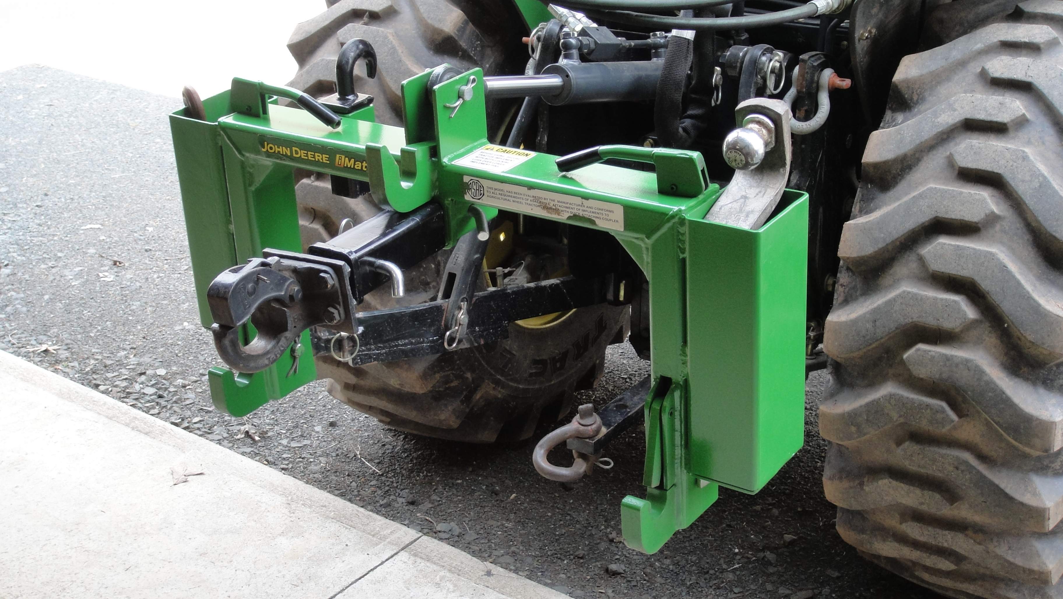

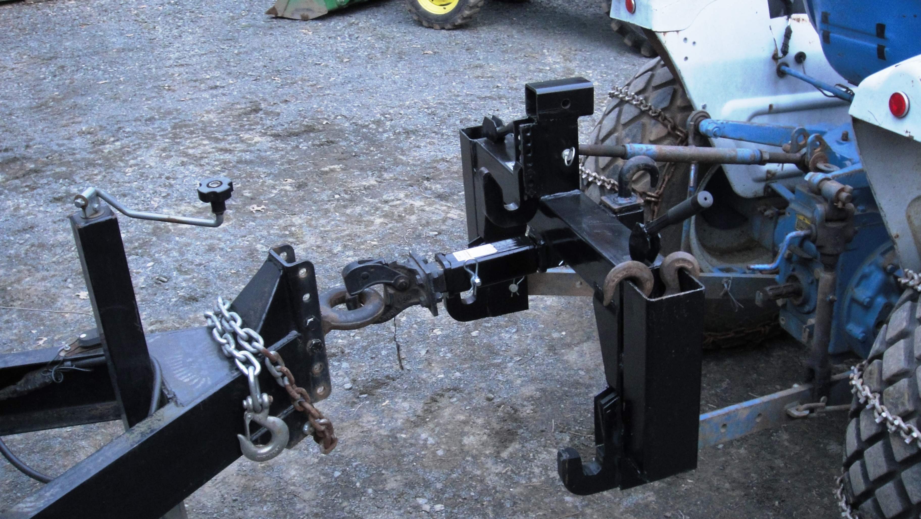

I made boxes for my quick hitches. Along with other mods, works good for me.
JB
