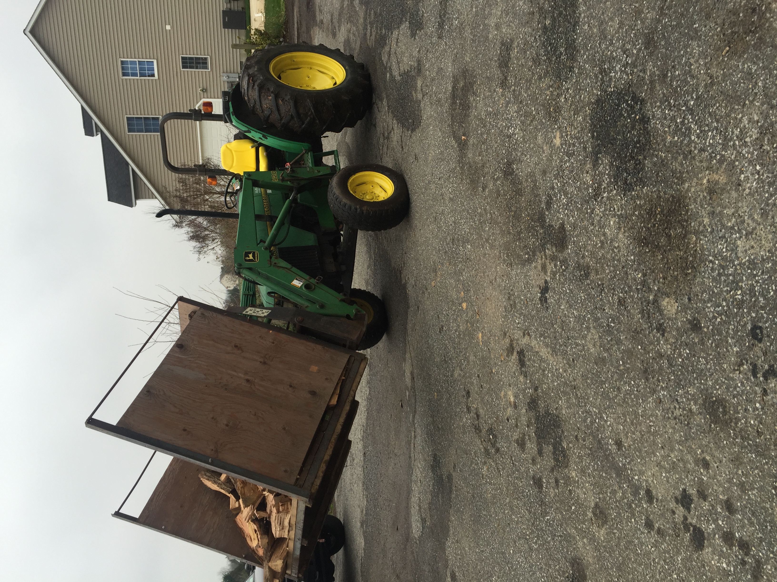

Look for 3pt pallet forks - tractor supply has them (not the carry all) - then build a box or several like the ones in the above posts. The reason I prefer the pallet forks over a carry all type set up is I can drop the pallet and go to the next one. I have forks for my loader as well which lets me carry about a full cord at one time - the boxes I built are 4x4x5 out of 2 inch angle with 4x4's under and 3/4 plywood sides. You can build a carryall plat form as well to carry all your stuff into the woods if you're cutting. This has been the most useful set up for me and my situation - i PUT EVERYTHING ON PALLETS !

   / Carrying Firewood with Compact Tractor #40
So, I own a Ford 1520 with a 3pt hitch and a loader. I work by myself on firewood and most projects. The firewood I get is a 2 mile drive through my field by tractor. I have a John Deere Gator but, I need the loader on the tractor to lift trees and move them around and I'm not sure the Gator will make it cross the creek that I need to cross to get to the area that I cut. I have been putting the wood in my bucket on the loader and I can only fit like 20 pieces of wood in the bucket. I need something to put on the 3pt but I'm not sure what to do. I can get a scrap box blade or metal to use. I'm a mechanic and welder so I am more than capable of making something. Just need ideas. No, I can't just pull my trailer back there because I don't know that I can make some of the turns that I need to. Thanks for your help guys!
