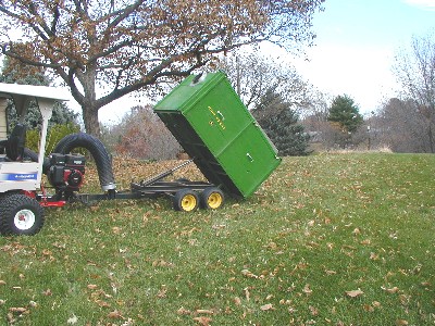

DAP.
I have both the 1 ton and 2 ton Country Manufacturing Tandem Axle Trailers. Both were shipped on pallets by freight truck and required assembly (not difficult).
I started with the 1 ton version (back in 1983) to create the dump trailer for my lawn vac system. (See photo). The 2 ton is shown on the reply below.
I have modified the 1 ton unit very extensively by reinforcing the bed and frame, widening the tread width to gain stability on slopes, and adding my own hydraulic cylinder and bed pivots to get a much higher dump angle than the standard version has.
This unit has served me well as a lawn vac trailer, but I think you would want to go to the 2 ton version which is much beefier if you are going to be hauling dirt and rocks.
JackIL

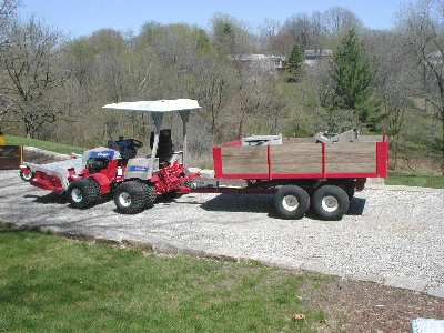

   / Cart for my Kubota? #18
DAP,
Country Mfg 2 ton Tandem Axle Trailer. I installed a 24 inch stroke hydraulic cylinder. The mounting pivots were included as part of the standard trailer--all I did was to purchase a standard 24 inch stroke cylinder, hoses, and couplers. The jackstand is also included.
This is a much heavier duty unit than the 1 Ton Version.
JackIL
   / Cart for my Kubota? #19
Jack, just out of curiosity, do you find the tandem axel more stable or less stable on your slopes than a cart with wheels at each corner?
My lot has a couple really steep spots that I deal with and I have dumped over and twisted into pretzels a handful of the 16 cubic foot tractor carts that come from the hardware stores. I've been looking at larger ones but was never sure if I'd just end up rolling over a bigger more expensive cart.
   / Cart for my Kubota? #20
Bob,
I don't try to go on steep sideslopes with my trailers or wagons. (Trailers have their axles "close together" or are only 1 axle whereas wagons have at least 2 axles widely separated. Trailers impose a significant vertical tongue load on the tractor drawbar, but wagons impose essentially no vertical load on the tractor.) As I mentioned in the previous post, I did widen the tread width on the 1 Ton tandem axle trailer to help stabilize it on sideslopes. With the original design it was on the verge of overturning on 20 degree sideslopes, but never actually did overturn. Note how tall it is. It holds 42 bushels of grass clippings so it is naturally going to be tippy when almost loaded. However, with the widenend stance it has been fine.
I don't think there is a clear case to be made that wagons are inherently more stable than trailers with respect to sideways overturning. For pure sideways tipping, the tip angle is approximately given by the Arctangent of the ratio of Half the Tread Width to the Height of the Center of Gravity. The wider the stance and / or the lower the CG, the higher the slope angle has to be to tip.
JackIL
