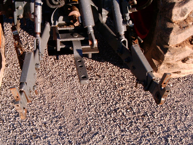

   / Carter's ez-hitch #2
Has anyone used this? I am considering it. View attachment 465159
I used a set of them for a couple of years. What would you like to know? I don't use them now since I traded tractors that have telescoping lower links and stabilizers, but they were pretty handy on my Kubota L3400hst that had solid lower links and turnbuckle stabilizers. On the plus side they do not make your lower links any longer so your PTO shafts will all still fit. On the minus side they ride higher than the ball ends of your original link connection point, so make sure your lower links can go as low as you will need to make connections to the draw pins on your implements.
I did not have any problems with that, but it could be for some.

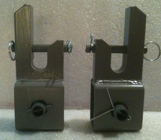

The ideas is the same, but the design is different and they sell for some less. To really be useful one needs the gizmo that holds the 3 pt apart at the proper distance. I've since bought a Landpride Quick Hitch, and even that has some complications for fitting every attachment that was purchased beforehand and before switching to a larger Kubota.

Agreed. It is somewhat simpler than a Pats. And as I pointed out, the Carters do not extend the lower link length. They also do not auto latch. But since you have to get off to connect the top link with either, I do not see that as much of a disadvantage.

I "used" mine for less than a year. I just might be the only one but, for me they were anything but easy.
Some implements were too low so I had to park them up on blocks just to get back under them.
They would hang up on the lynch pins and pop them off. Tried other things but that didn't work well either and was always hanging up on them.
They wouldn't work at all on some equipment hookups that were boxed in which you had to slide a pin through the lift arm.
Not enough clearance for them to hook up on all equipment.
I was actually working harder each time just to hook up my equipment. I was worn out before I could even start working. Finally I said, the h3LL with this. I took them off and WON'T be putting them back on.

I have both Carter's and Pat's. I like the Carter's on my Kubota 3400 because it raises the height of the lift arms a bit, and I'm using implements that really are designed for traditional cat 1 ag tractors. If all of your implements have pins that are the same distance a part, these and Pat's work well and are quick. If you don't, you'll need to adjust the distance between your lift arms when switching implements, which takes some of the 'quick' out of your attaching. If implements don't have much space around the lift pins, then these or Pat's may present a geometric problem. Overall, I like the Carter's. Haven't managed to damage them in more than 5 years of use. Pat's are a little more complicated, and I've bent some of the parts on those. If you have extendable ends on your lift arms, I wouldn't bother with either type. I don't have extendable arms on two of my tractors, so I find these handier than nothing.
   / Carter's ez-hitch #12
I felt the Carter's were very useful and decreased my swear word vocabulary. I also made up bent washers for all of my implements.This is almost necessary for proper operation to prevent the from trying to slide off the ends. I used a bungee to hold the arms under tension, and used the turnbuckles for fine adjustment.
Bottom line: better than solid links. Not as good as a true quick hitch. Carter's Not needed if you have telescoping lower links and stabilizers.
   / Carter's ez-hitch #13
I prefer the carters over Pat's for thefact that they self-align and swivel with the the implement pins. The pat's system is held rigid via jam bolts so they don't move or twist as easy when trying to connect to an implement that isn't level with tractor or where the pin spacing is different enough between implements.
I have both options but have settled on the pat's since I have a couple of implements where the increased height of the Carter's was an issue.
   / Carter's ez-hitch #15
Mine stay on the tractor and I'm satisfied with them. I had to cut the heads off the mounting pins and weld a washer in its place - the pin wouldn't fit in a captured-pin setup in my winch.
Mine are 6-8 years old now and a bit floppy but still work fine. I don't use anything to keep them a certain distance apart but sometimes a stick to tip them upright if they flop to the side. Agree you might need to block up an implement to get under it later, but that's easier then extending a driveshaft. Excellent customer service from the Carters, too.
