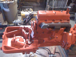

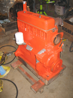

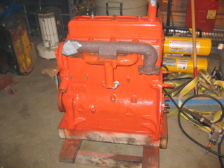

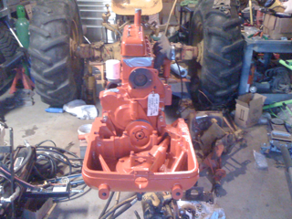

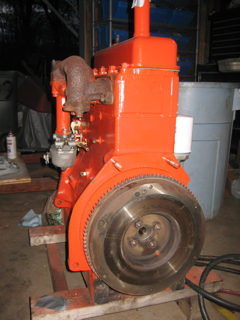

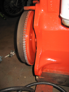

Here is the completed engine assembly. I was going to do the rebuild myself and post more photos, but for an additional $400 bucks the shop did the assembly, and they warranty their work. I couldn't pass on that.

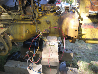

#22

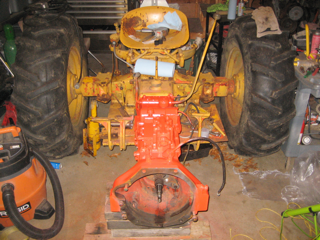

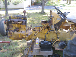

While the engine was in the shop. I moved the back half of the tractor into the garage so I could start to clean this nasty, dirty torque tube. Here is the machine prior to clean up.

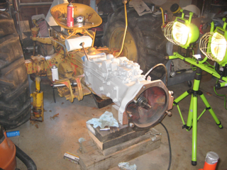

   / Case 310B taredown/rebuild

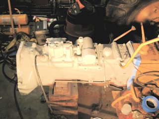

#23
I used a pneumatic needle paint chipper/de-scaler. These things work great. They get into all the tight spots and clean them right up. I degreased the area and applied primer.

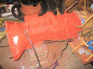

#24
Then it was time for the Flambeau Red, now that's better!! This was last winter so a couple heat lamps made all well.

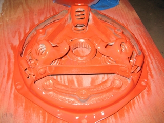

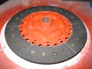

#25

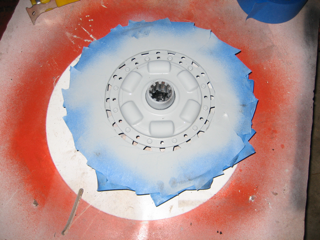

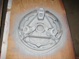

Then it was time to clean up the clutch parts and the fly wheel. The new parts engine I purchased came with a flywheel, clutch plate and pressure plate that were like new compared to my original ones. These were bead blasted at the engine shop, so they are ready for paint.

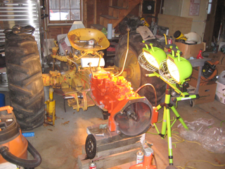

#26

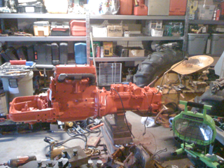

This was the point that I hung the engine on the tractor. I had a little trouble getting them together because of some edges that I had to file down on the main shaft spline's. So the engine was all bolted up. I didn't take a photo at this stage.

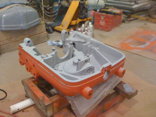

#27

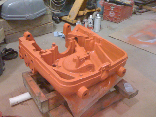

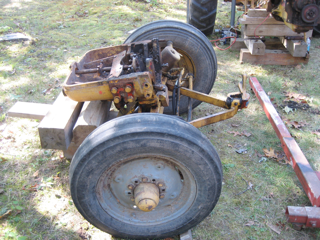

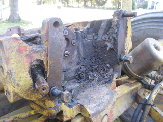

Then it was time to clean up this mess. The front end was filthy. Caked in dirt and oil. The 1" drain holes were plugged solid it took some time but I cleaned it up pretty well. I was going to bolt it up and use it as is for a while, with plans to tare it down in the future but my father talked me into just doing it now. So I tore down the front end.

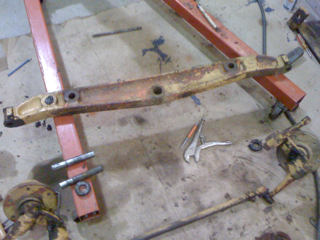

#28

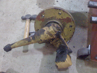

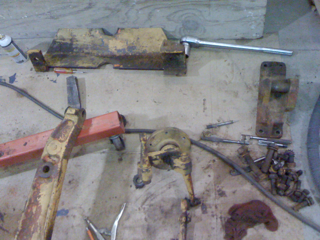

Here are some of the front end parts removed and cleaned. I used the needle chipper again on these parts. Man the chipper works great.

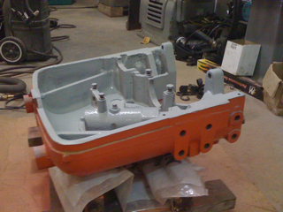

#29
My father Joe has been a huge help with this project he cleaned this front casting to get it ready for painting. This was a tough job. After needle chipping the paint away and a ton of degreasing it was finally ready for paint.

#30
Then I was able to bolt it to the engine.
