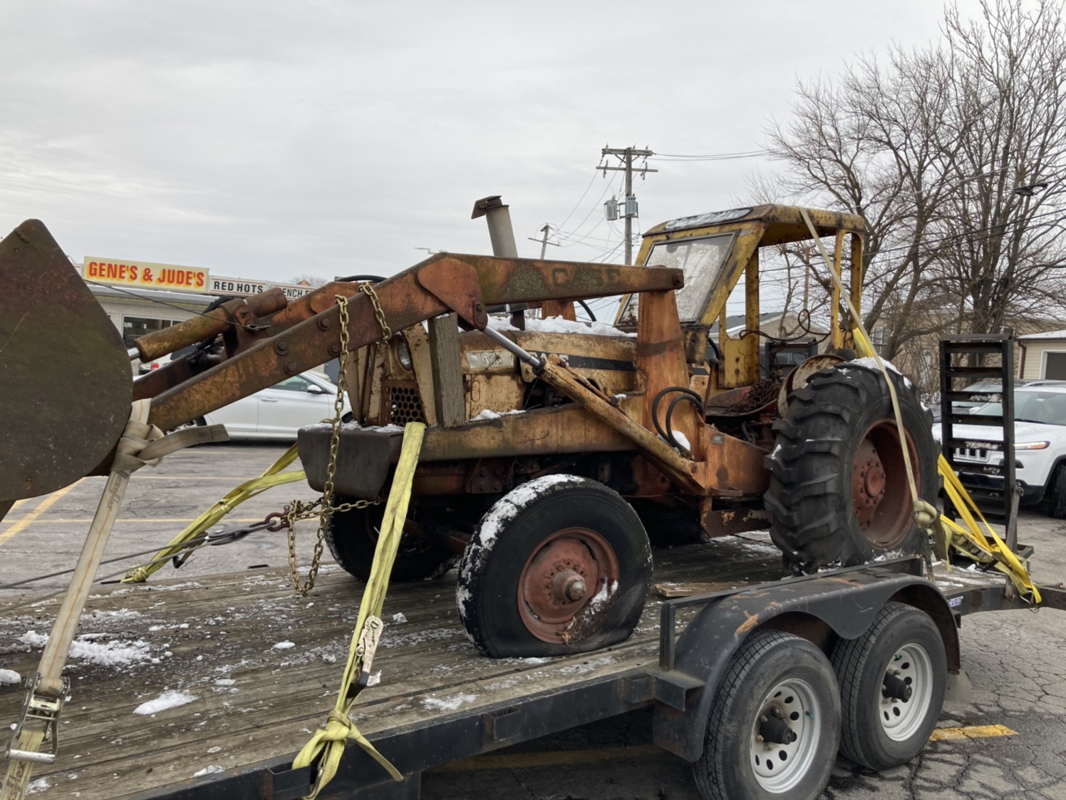

Thanks for the info. Here is a pic that the current owner sent me. I have my work cut out for me tomorrow. We will see if it is worth the trouble. It is frozen to the ground in ruts. *
/ Case 430 model
Well we got it loaded up and got it home. Was not able to figure out how to get the tractor into neutral
. Had to drag the rear tires up on the trailer. The center shifter seems like it’s in neutral and you can feel it going through the gears but there’s no markings left on the case to say for sure.
Any ideas why the rear tires may not move. I know the brakes are not locked up because they will shift a little bit back-and-forth. Something in the gearbox is definitely not disengaging and it’s probably because I don’t know what I’m doing.

More than likely, water has seeped in around the gear shift lever and has the transmission partially filled with water. With age, the shifter boot gets cracked, and lets water in. It sounds like there's enough in there to be up on the ring gear, and not allowing the differential to turn. Hopefully you have a warm shop, and be able to get it in there. At some point, drop the diffy plug, with a large pan (something like 10 gallons) underneath and let it drain.
Here is a link to more than several manuals for a 530 Case. The 430 and 530 are close enough, they share many similarities. Case 53CK - Manuals This will get you by, until you find the proper manuals for it.
When you get the serial number, you can go to the Case/IH online parts catalogs, and select the model that fall within the serial numbers listed. Search 43 | MyCNHi US Store to familiarize yourself with it, and its function groups
Enlarging the picture, I can see it does have the manual shift reverser/shuttle shift. Word of warning, don't haunch on that lever very hard, and make sure you are completely stopped, before changing directions. The collar that surrounds the shaft, that shifts from forward to reverse, is made out of a cast, pot metal type material, and wear very easily. And, there is a very small spring/roll pin (like 1/16th" 3/32") that holds it on the shaft, that either the hole gets elongated in the softer collar, or will shear. If there is some slop in that shift lever, then one of the above has happened. You'll need to pull that shifter's cover, to see what I mean. Wear points will be evident, once you look at it.
On my 310B, it had been haunched on enough, they broke the shift shaft, and someone did a poor job of welding it back together. I ended up getting another used one that had some wear, but not broken. I drilled the hole out larger, and put a big enough roll pin in it, I could tap a smaller one inside it. Luckily, I found 2 on ebay for $35 ea. Got the second one for a spare, just in case, and let it go with it, when I sold it. But the first one held up for the 2 years I owned it. When as it should be, shifting will be somewhat crisp, and no slop when in either forward, or reverse. Again, just be at a complete stop before changing directions. The #2 reason for having good brakes, to be able to do this.
For as tough as those tractors are, that shift linkage, and the brake seals are the weakest points I could see in that style tractor. As far as the engine, and rest of the drive train, they seem to be near bullet proof, if you operate it responsibly.

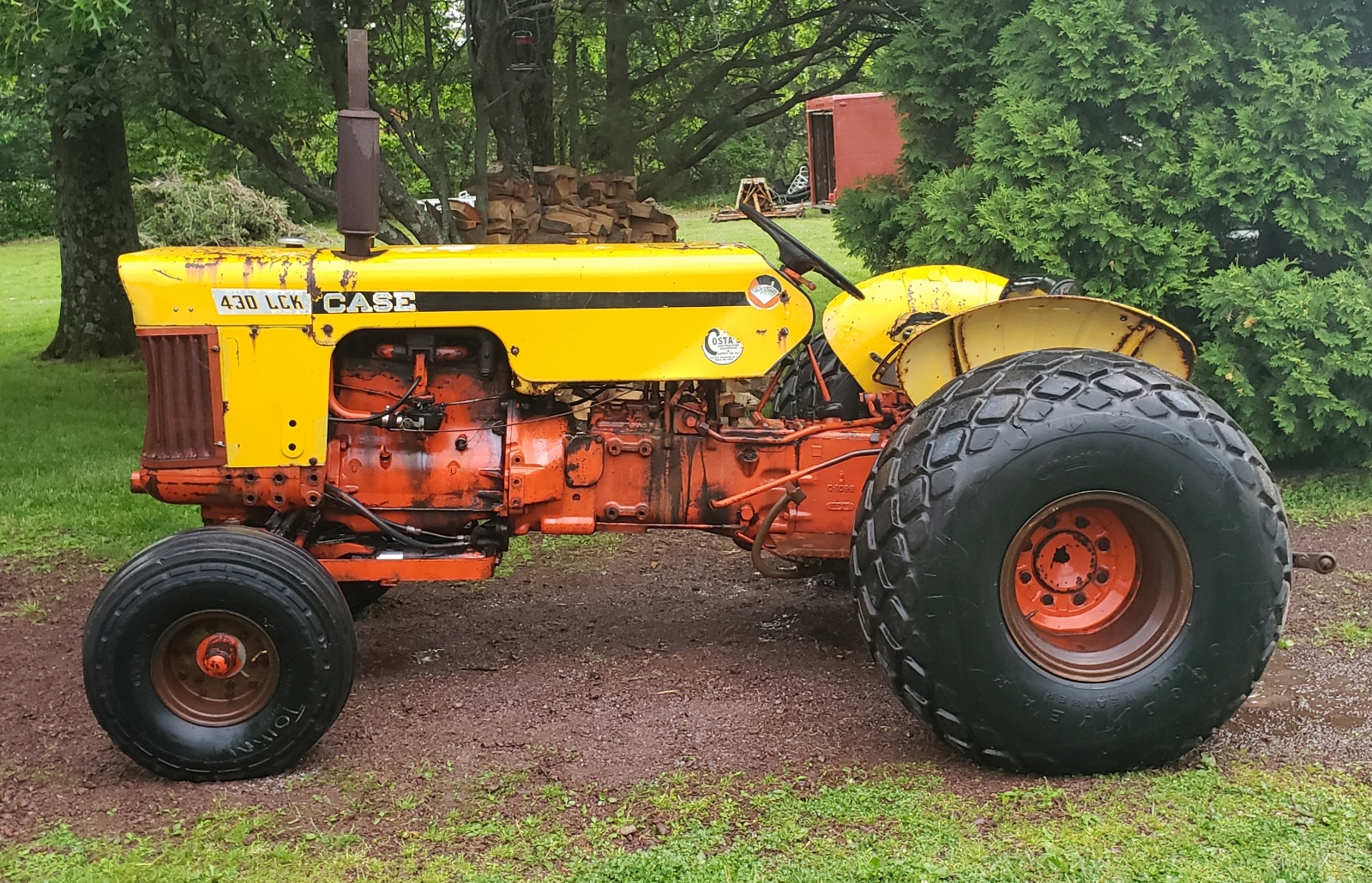

This is the 430LCK (445) that I’ve had since the middle 70’s. I just gave it to a friends son along with a 72” Woods finish mower. This one had 4 speeds and three ranges, and a sort of live PTO. The sort of was that there was a hand clutch that would disengage the traction allowing the PTO to continue to rotate. It also has a draft control. It was extremely reliable and served me well.
/ Case 430 model #19
Right off. There is something about the long wheelbase that is attractive. These tractors evolved over considerible time to do what they were expected to do, better and better. I'm not so certain that nowadays that has become more about marketing. Maybe not so much in the Ag sector, but certainly in this exploding consumer segment.
