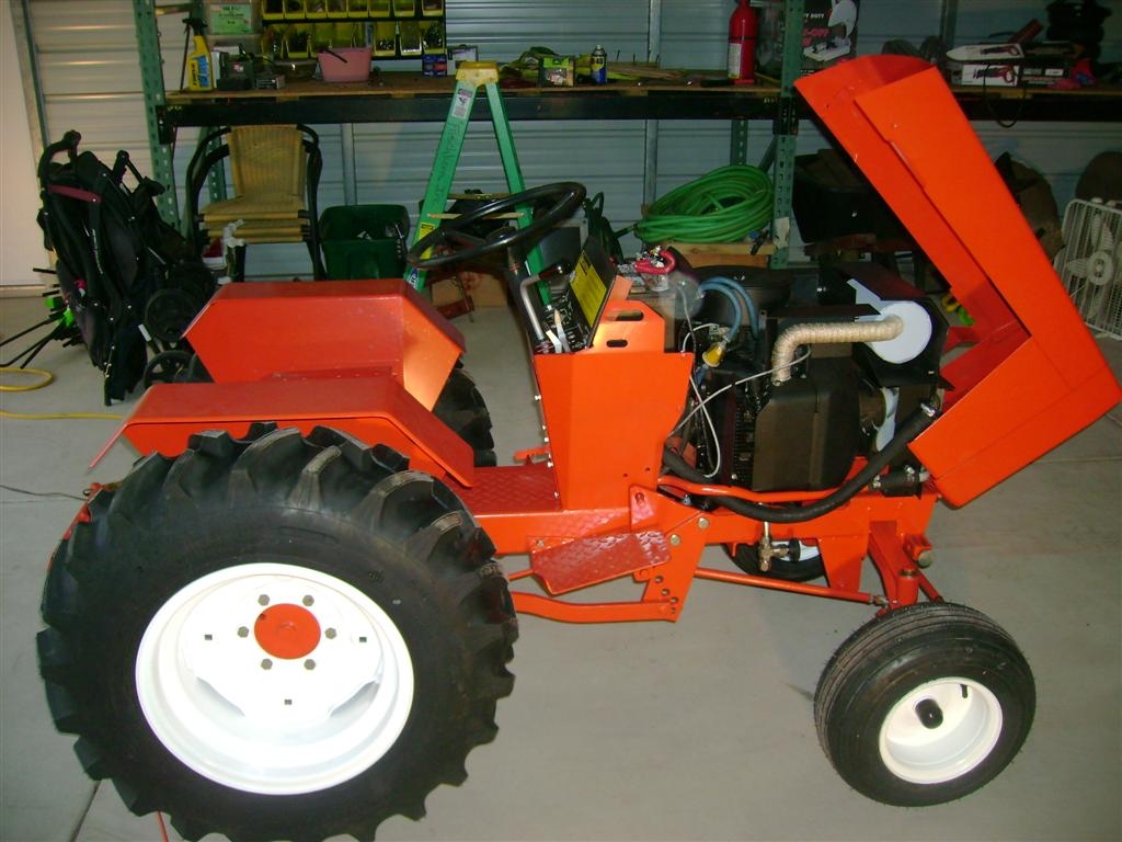

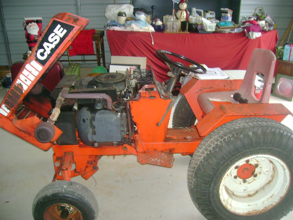

Do this and you wont have a problem or even have to get off the tractor to shift between hi and low. Let me preface this by making sure that you understand that the tractor should be stoped to change between the two. If the lever will not move, that means that the gear teeth are hitting each other on the edges. Place the lever in nuetral and push forward on the travel lever and return it to the stoped position, then try to use the gear lever again. This should work in 1 or 2 attempts. Usually takes no more than 5 seconds to do this.
Here is a before and after pic of mine. Remember what you were told earlier, you will be required to actually work on this thing to make it work right, but there is alot of help to be found to help you along.
