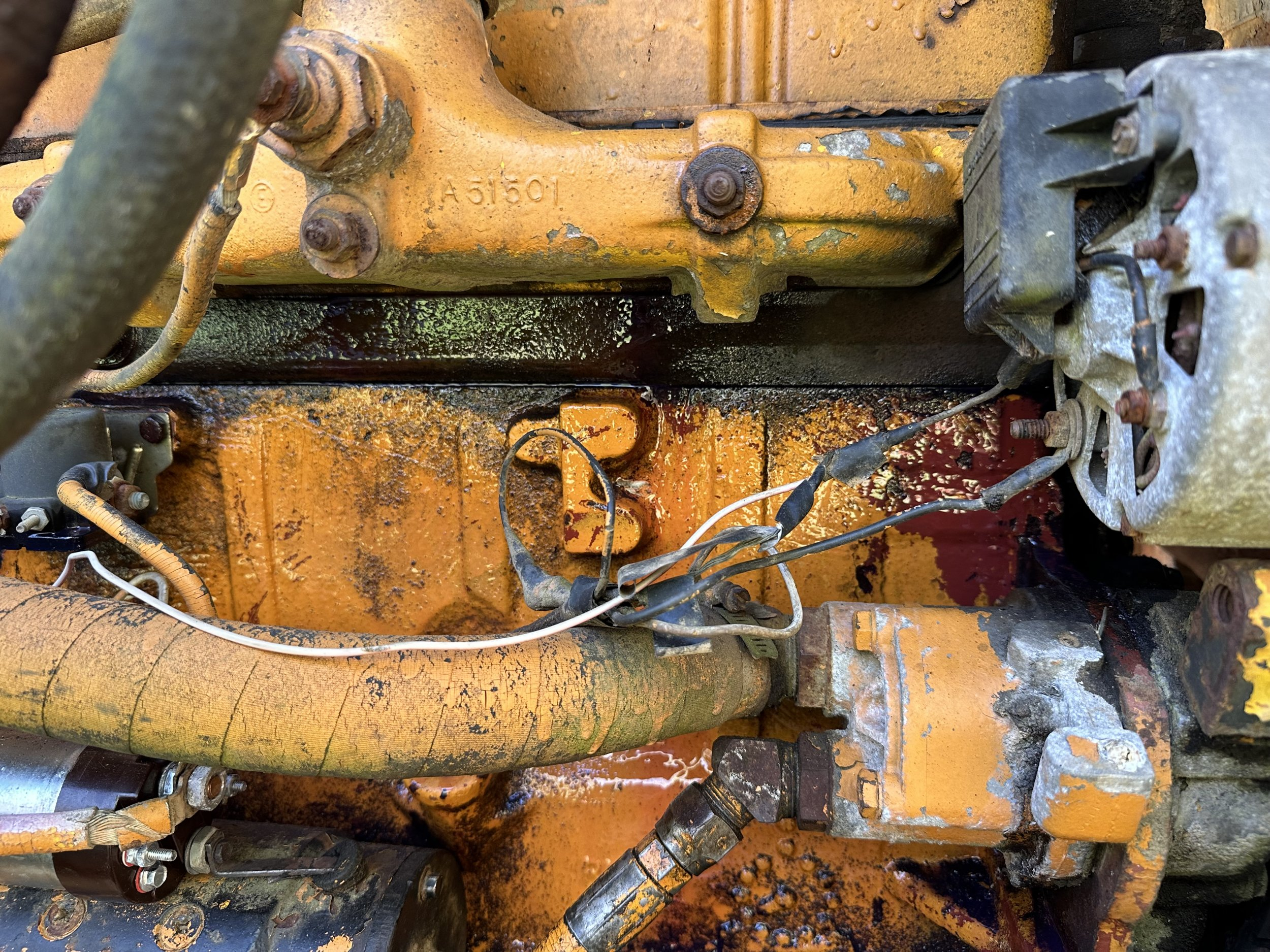

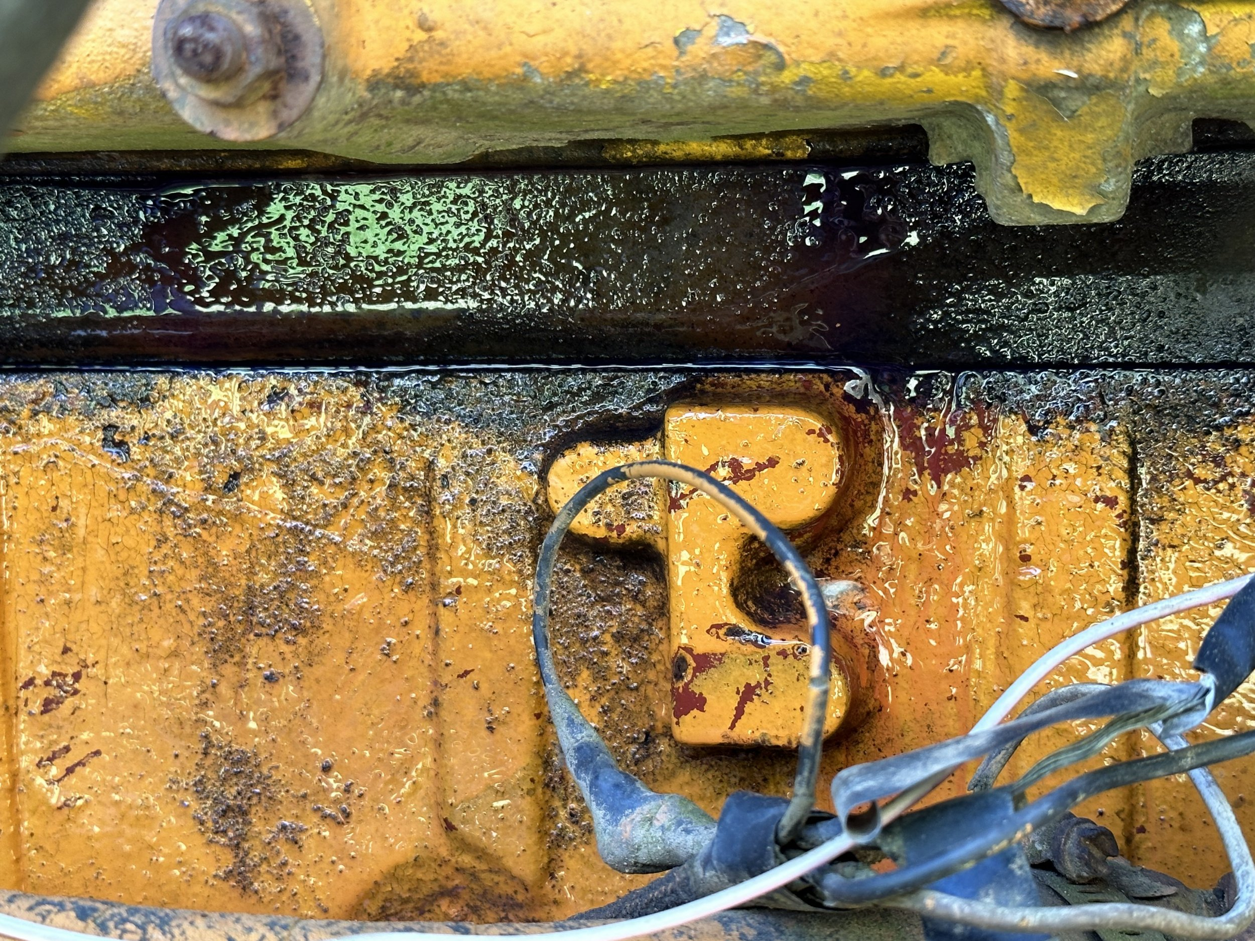

   / Case 450 Dozer
#11
I finally got all 4 injectors out. I poured over a gallon of Marvels Mystery oil in the injector holes. I’ll leave it set for a couple days but I don’t have high hopes. I noticed that the Marvels was seeping out of the engine between the head and block.
