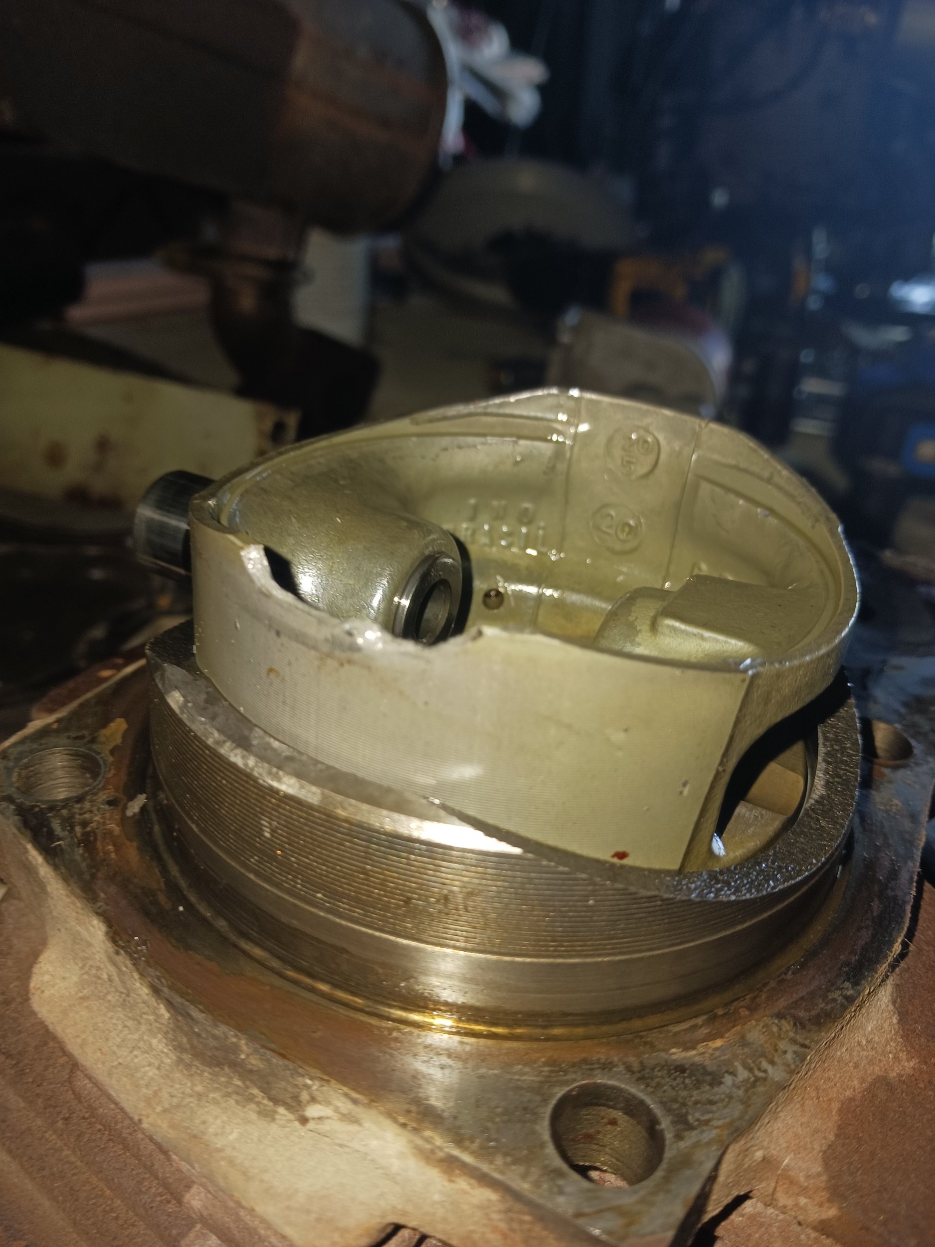

I've had some help from one of my daughters (visiting from Vancouver BC). Let's see if I can post pictures: First pic shows what I saw when the head was removed. Second shows damaged cylinder skirt. Third shows damage to piston. Fourth shows some deposit of metal from the con-rod. Last one shows the con-rod that was still attached to the piston plus some bits I was able to fish out of the crankcase once I took the cylinder off, That small item beside the con-rod worries me because I have no idea what it's for. I may have to split the crankcase to find out what it is and if it can be put back. What I fear is that it broke out when the other parts broke apart and that damage is not reparable. 20230705_112006[284].jpg20230708_124655[275].jpg20230708_124706[274].jpg20230708_124617[276].jpg20230708_124859[273].jpg

You will have to remove the PTO and cover on that end of the engine to reassemble so I would do that to see what else is damaged. Not sure what that piece is part of. If that rod was starting seize what else is scored?
   / Cub Cadet 1811 - Need Advice Removing Engine #15
The cylinder has been sitting with water in it for some period of time. So major rust damage, the crank and the broken rod pieces shows lack of lubrication failure mixed with water damage. And cylinder skirt damage from the rod hitting it.

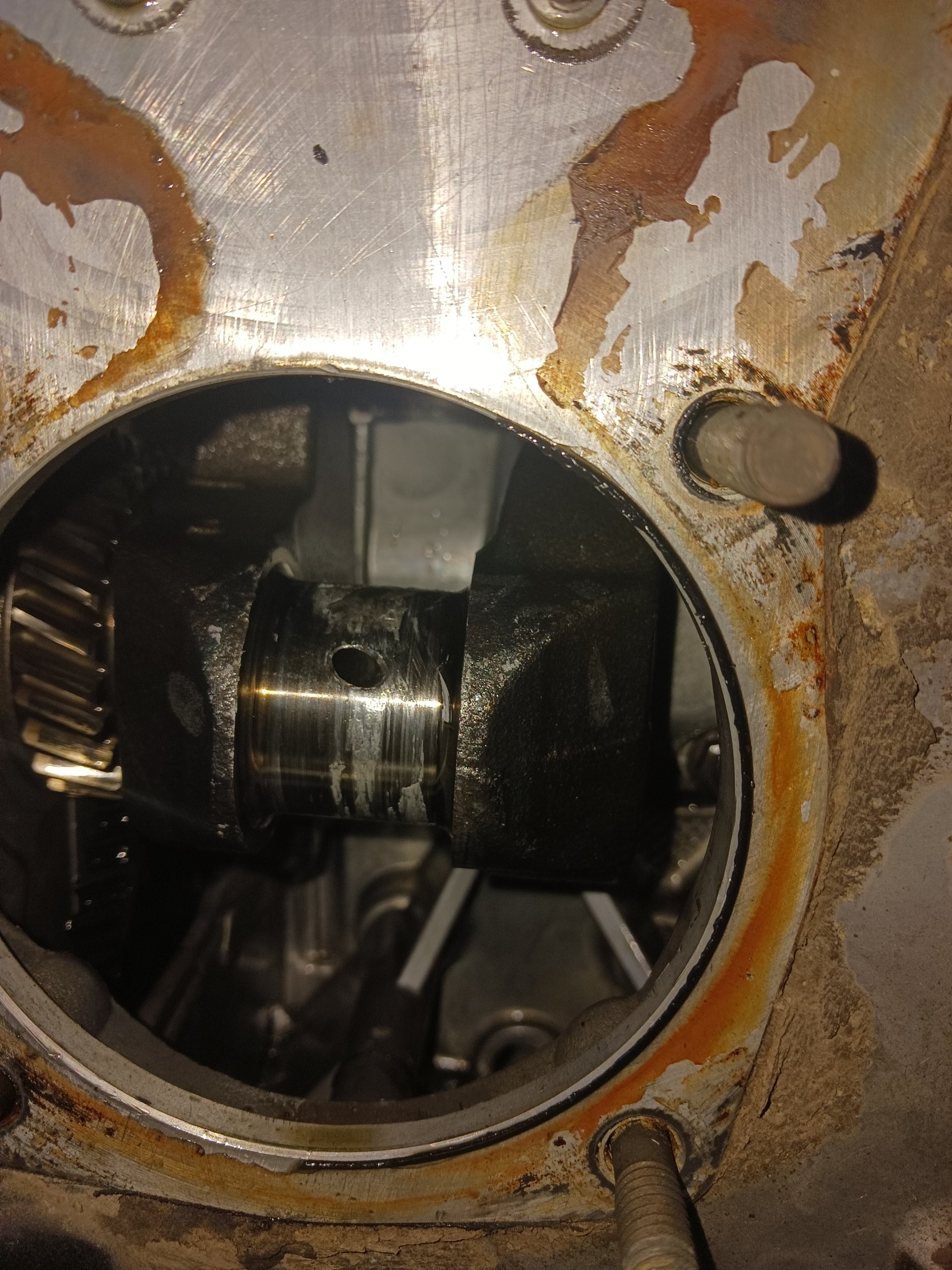

Here's a plan to determine whether the problem started with lubrication deficit. Fill the crankcase with enough oil for the pump to pick it up. Spin the crankshaft with a drill for a few seconds and watch for oil to emerge from the opening in the crankshaft clearly visible in the picture. If there is oil there then the issue lies elsewhere. If not, I would need to find a way to clear the obstruction(s). Thoughts?

#18
I got a few quick minutes of shop time in just now and I am happy to report that after some back flushing and shots of compressed air, we have oil at the opening for the connecting rod. I'll still have to try to find out what other damage is hiding in the crankcase. Still looking for a way to gain access without splitting it. Next move will be tipping the engine on the side and removing the mounting plate from the underside. It's an oily greasy mess in need of cleaning up anyway!! If there should happen to be an oil pan to remove, that would be helpful. :giggle:
