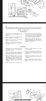

Here are the pics. This pulley won't come out as it is. I'm hoping that the change in weather/temps will help pop the case off. If this happens I think it all can be removed as one piece.
OK, gotcha', I was thinking you couldn't get the pulley to budge at all on the crankshaft.
But, yes, that pulley is all one piece what you're looking at. So again yes, the front end will need to be removed to get it to come forward to get it off.
One of those things you look at and think if the designing engineers had moved that piece it's butting into just an inch or so forward, it would have come right off. It's always been my theory that engineers should have to actually work on 15-20 year old machines like this in its present stage, keeping a mechanic in mind, maybe they would build into their design a way to get something like that pulley off without having to do so much extra work to replace something as simple to replace as a seal. But that's just my opinion...

I think it is the timing cover behind that pulley and sleeve. I gingerly tried getting it come with taps and penetrants but it won't budge. All the bolts are out as far as I can tell but it just won't let go. IF I can get the cover off I might be able to slide the pulley back in the recessed area and slide both the pulley and cover up and out.

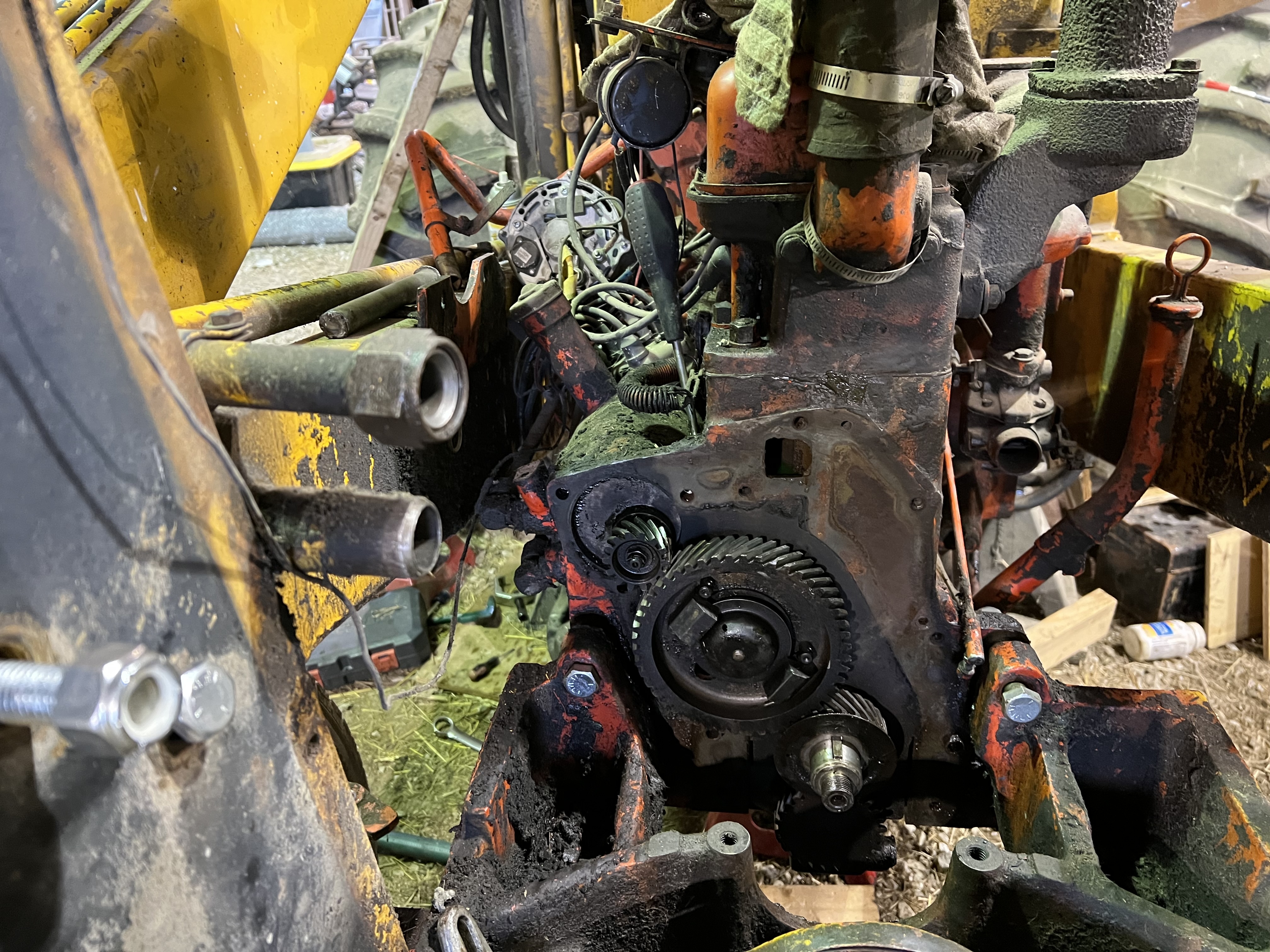

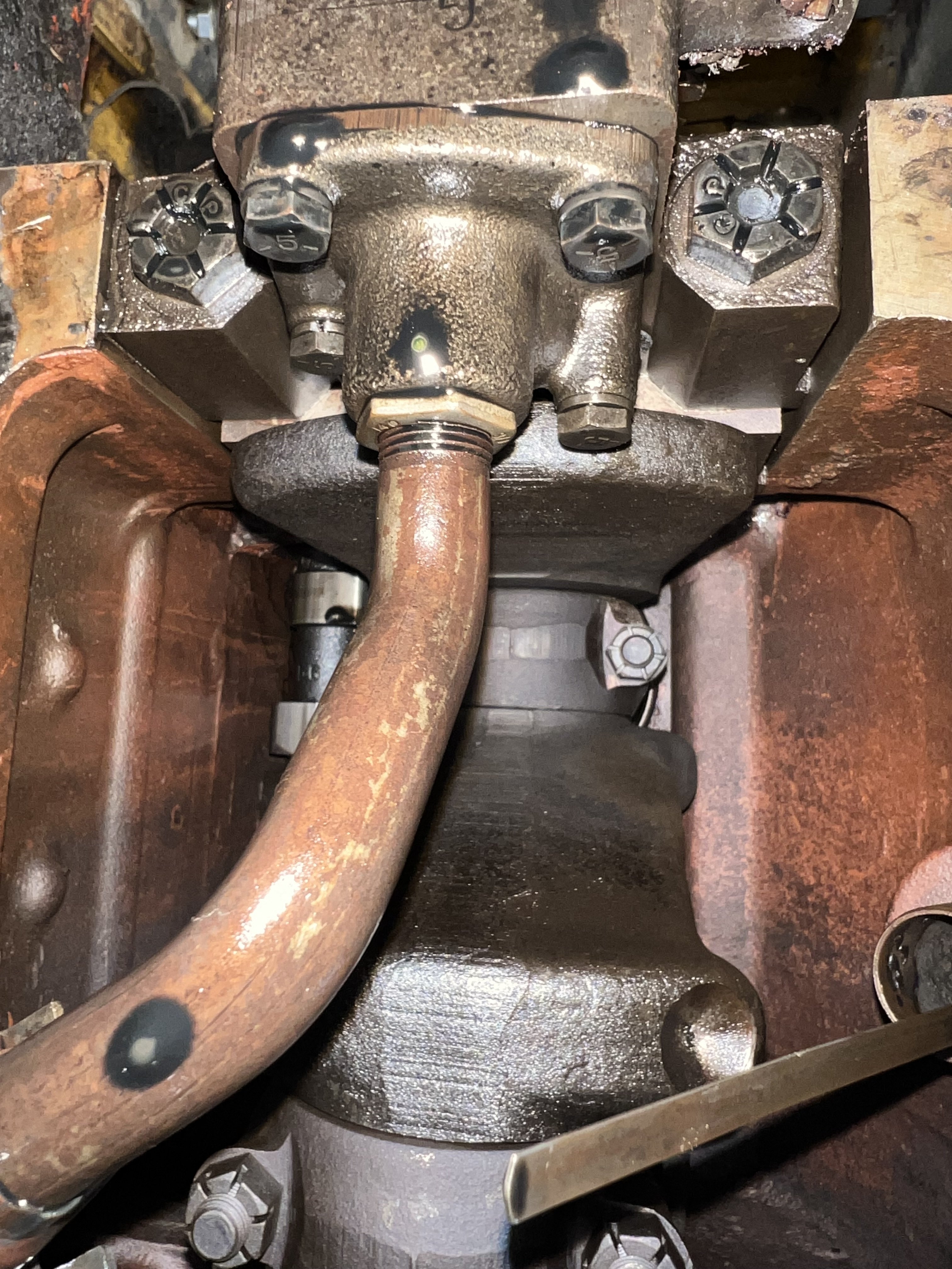

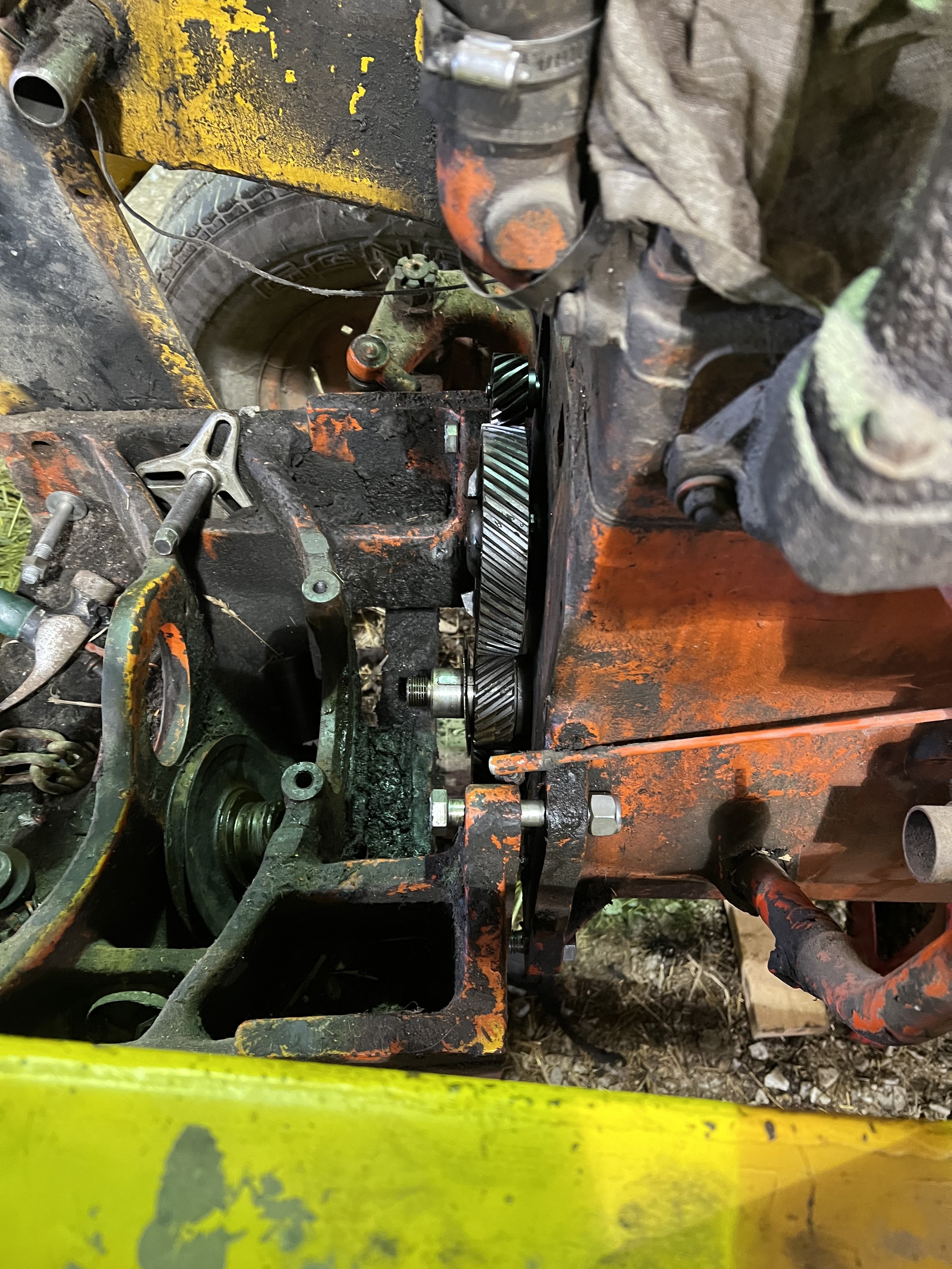

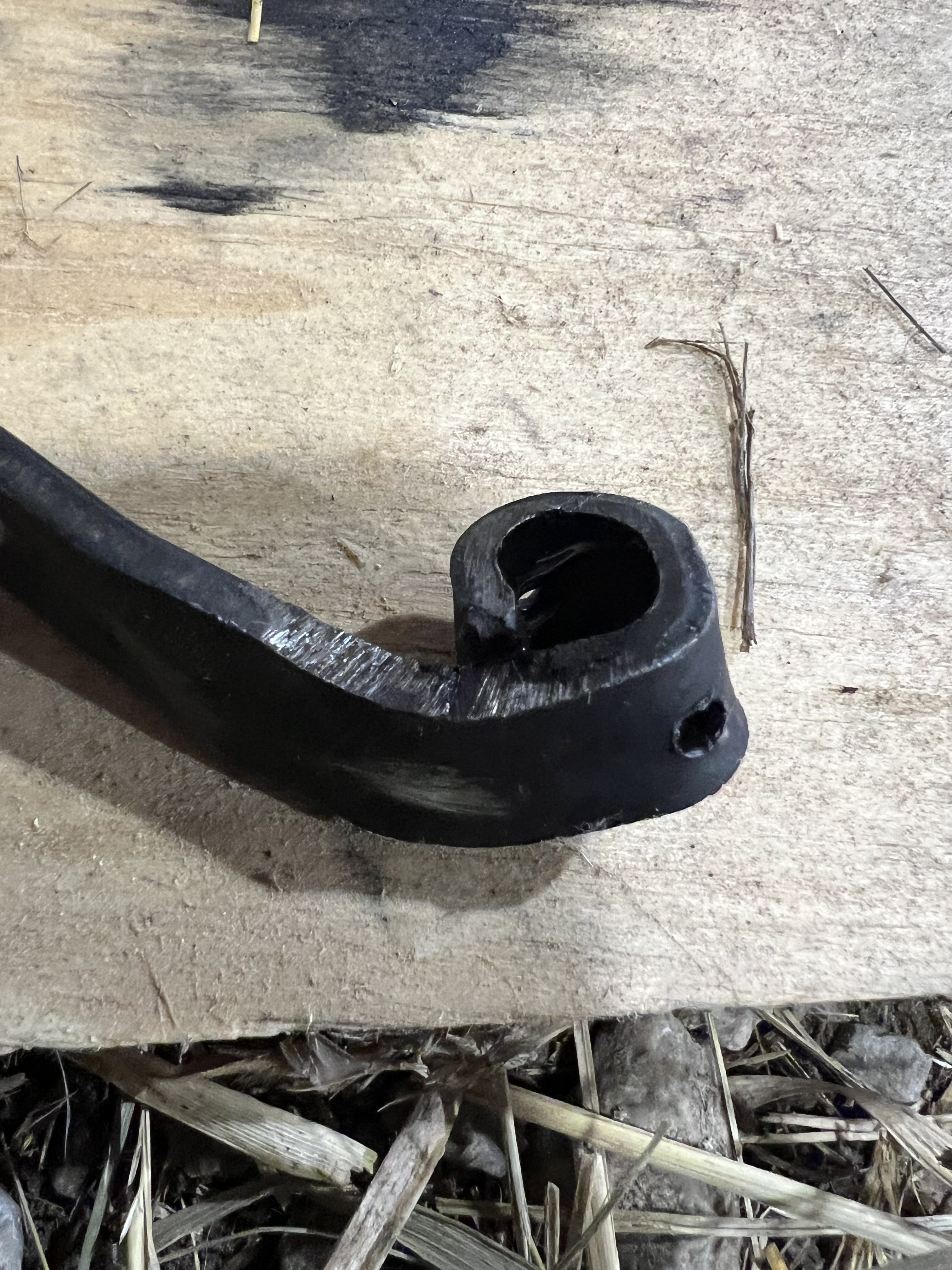

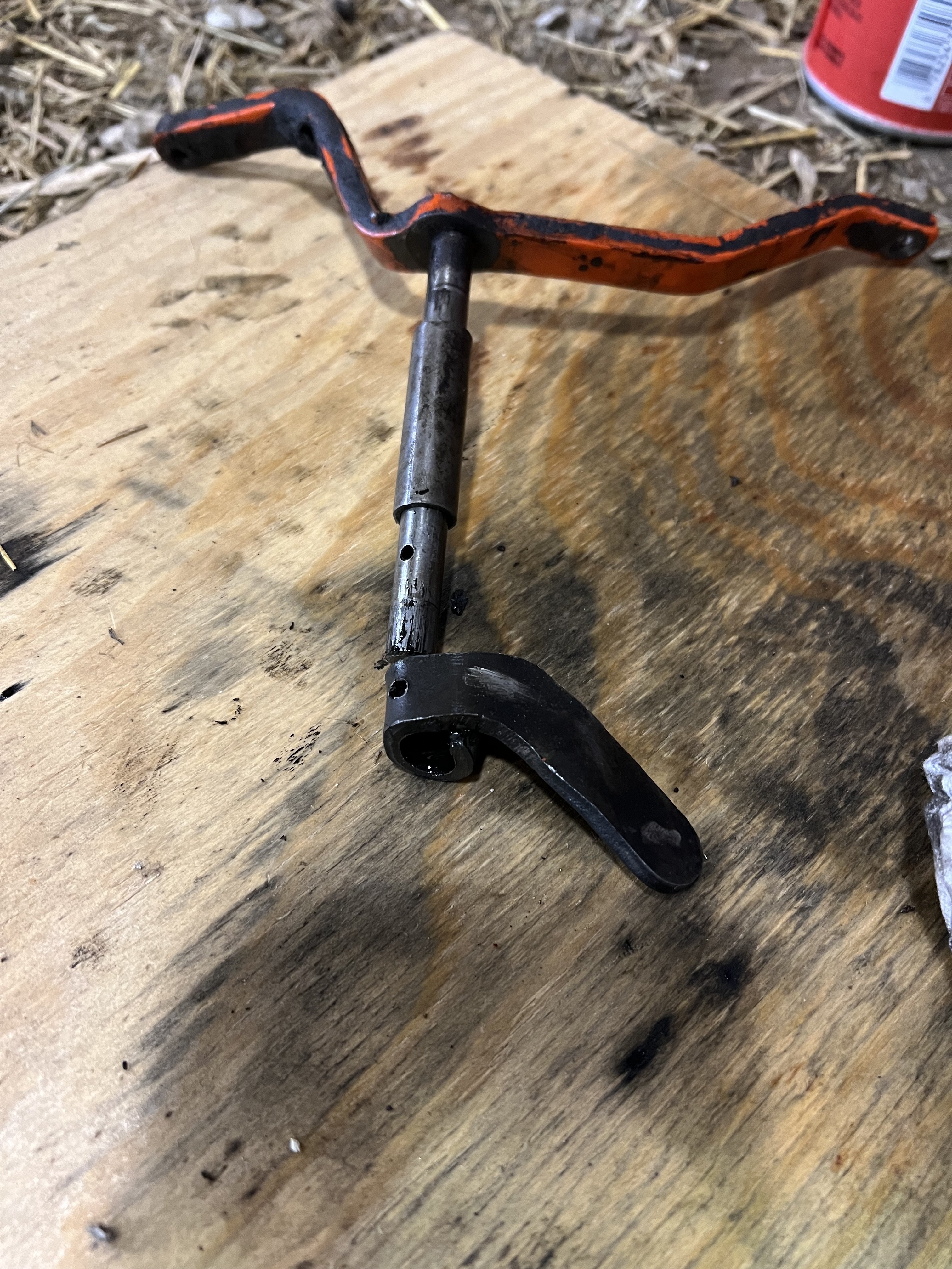

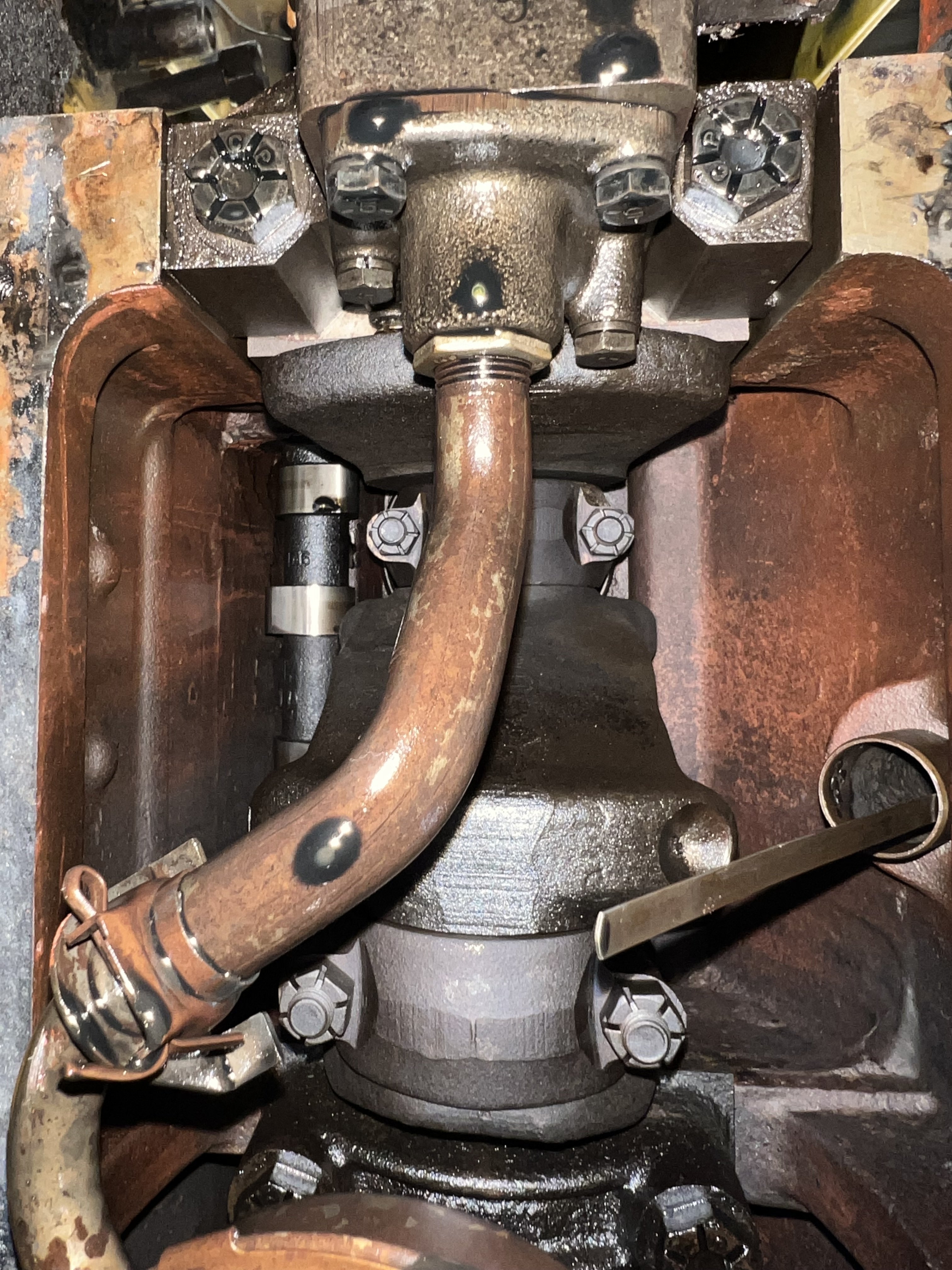

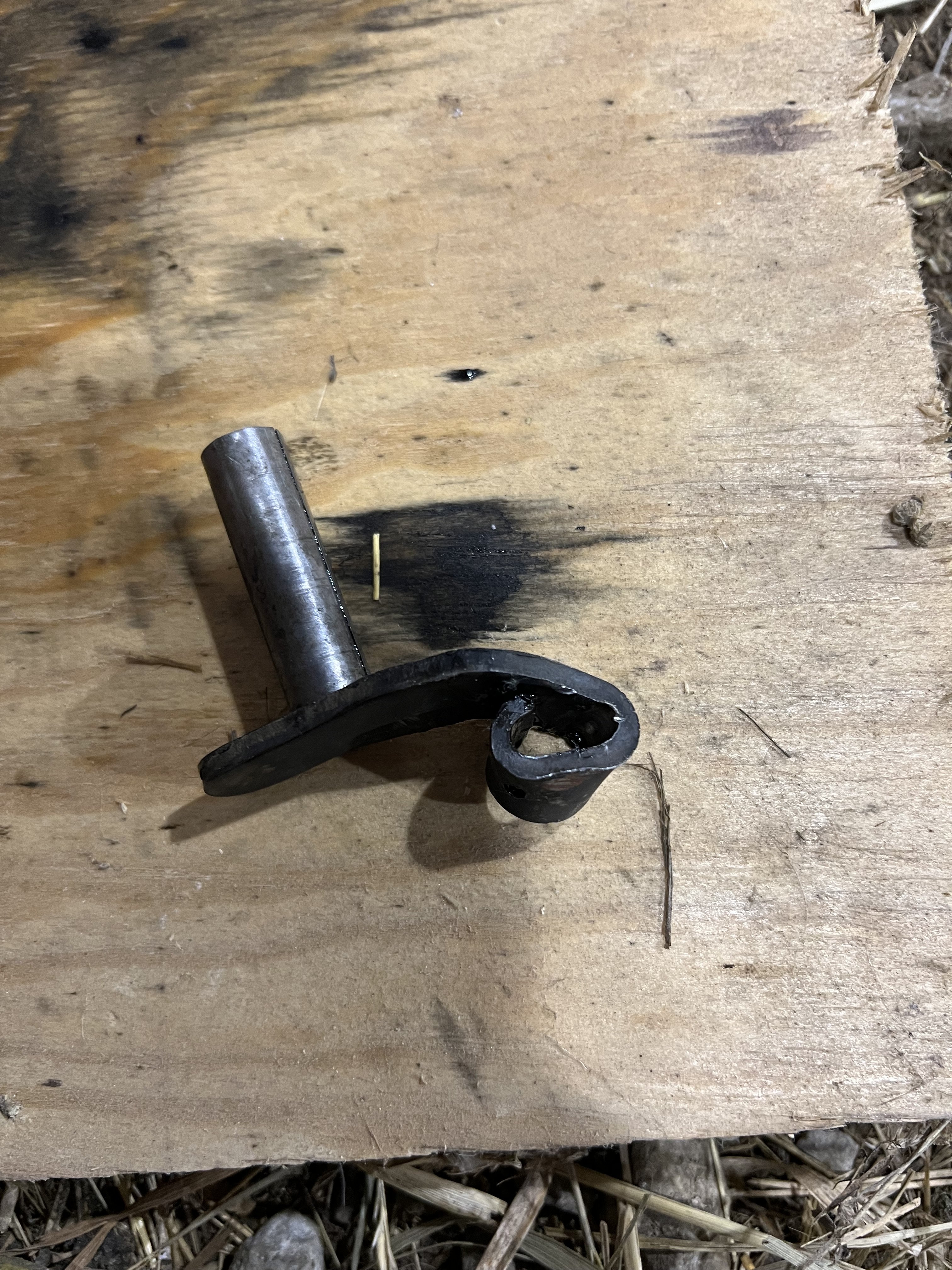

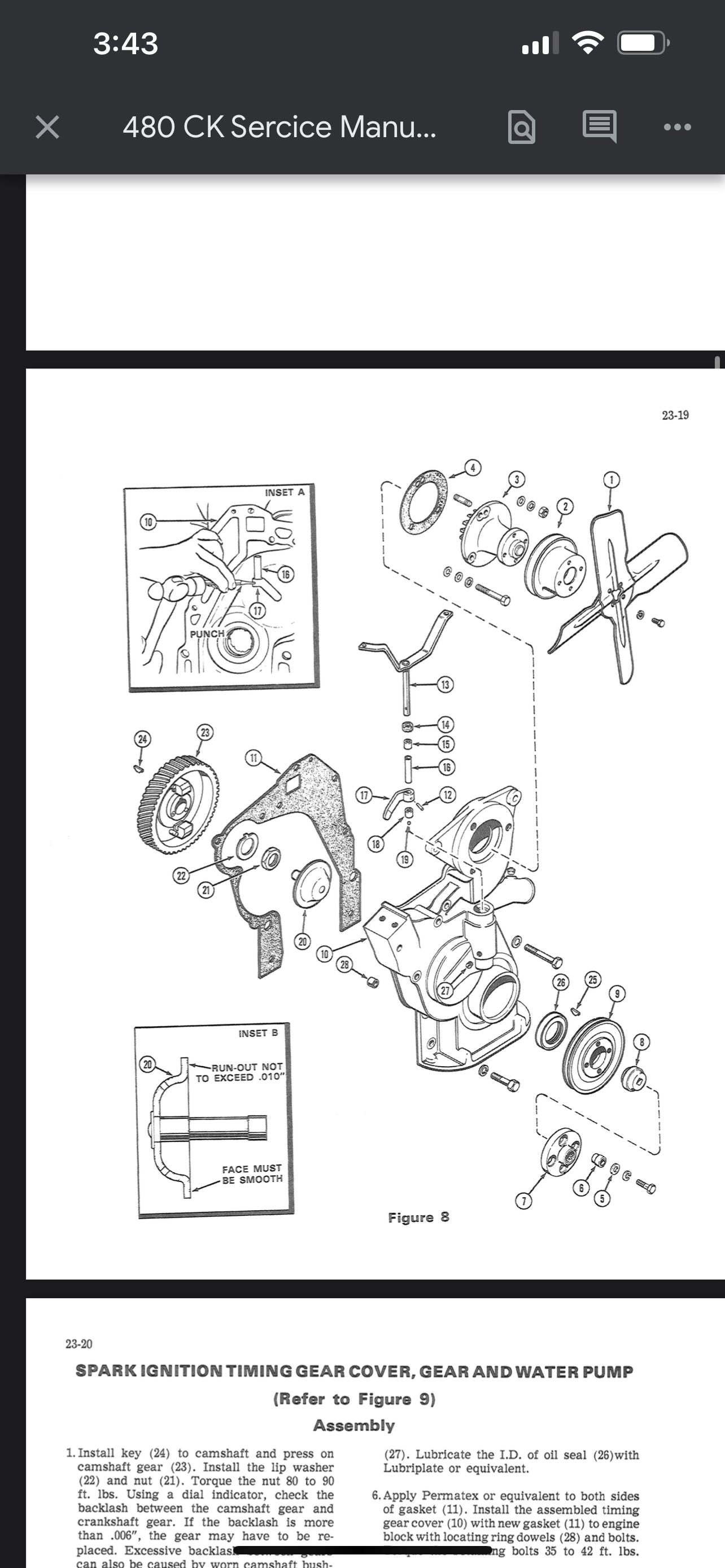

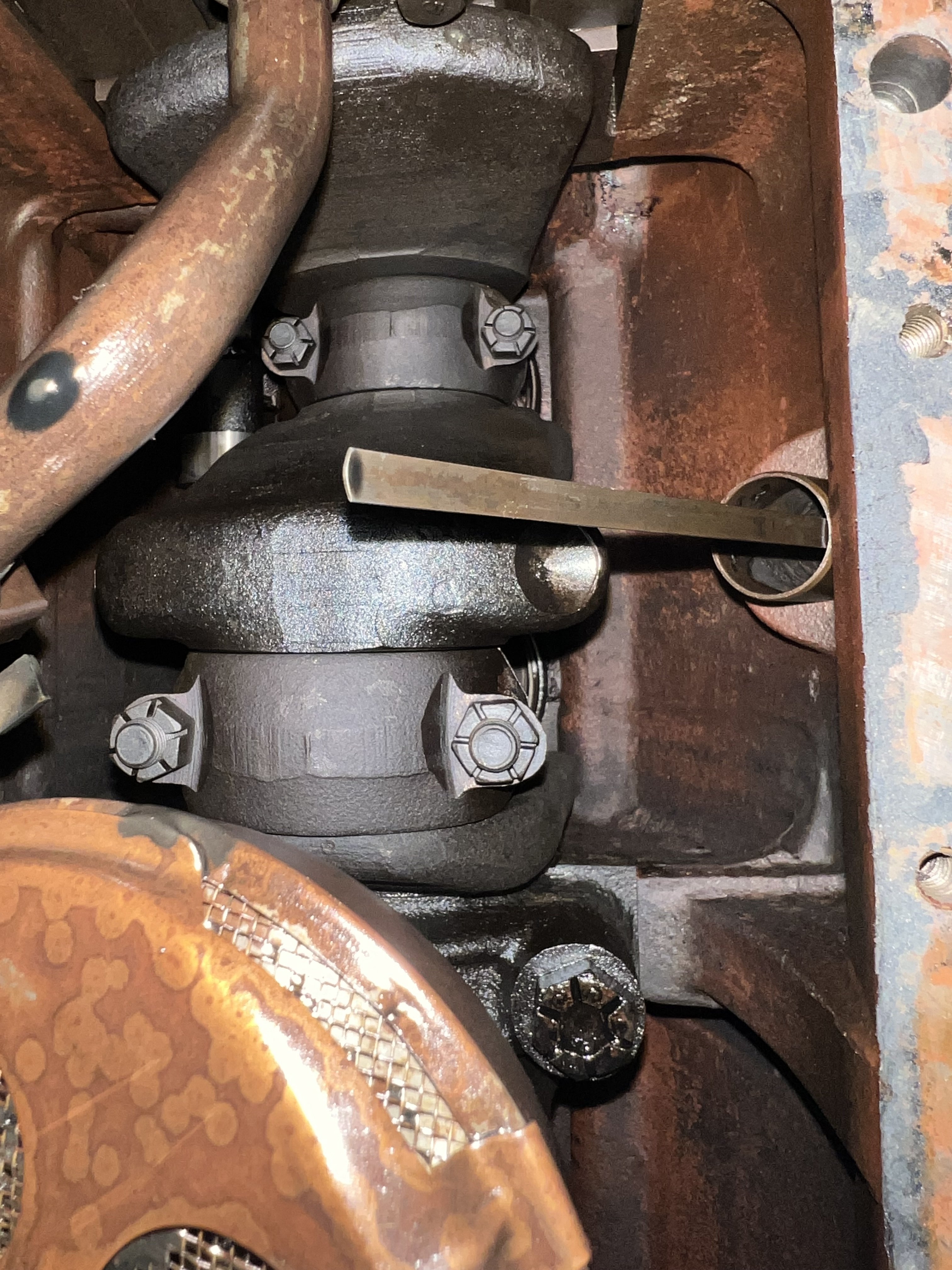

I managed to drop the oil pan and found what appear to be governor parts. I did pull the governor up and out before the cover came off so they probably fell to the oil pan then but I’m not sure how they got bent and scratched so badly. Tractor has ran for some time, well before I started pulling things off. L I will have to check case for replacements. There was also coolant in the oil pan.. Not sure where to start on that one.
Had to split the tractor to get front cover off and didn’t see much wrong as far as I can tell. One cracked tooth probably from me thrashing around with the cover.
I am going to try to order gov parts and oil pan seal tomorrow.
Any ideas here are greatly appreciated. Aside from replacing gov parts and seals I don’t know what else to do here. Pics for reference. Anything jump out to anyone?

And with a shot of brake clean I found the ball bearing that the governor sits on. Gov weights move freely.
Maybe it is carb issues all along?

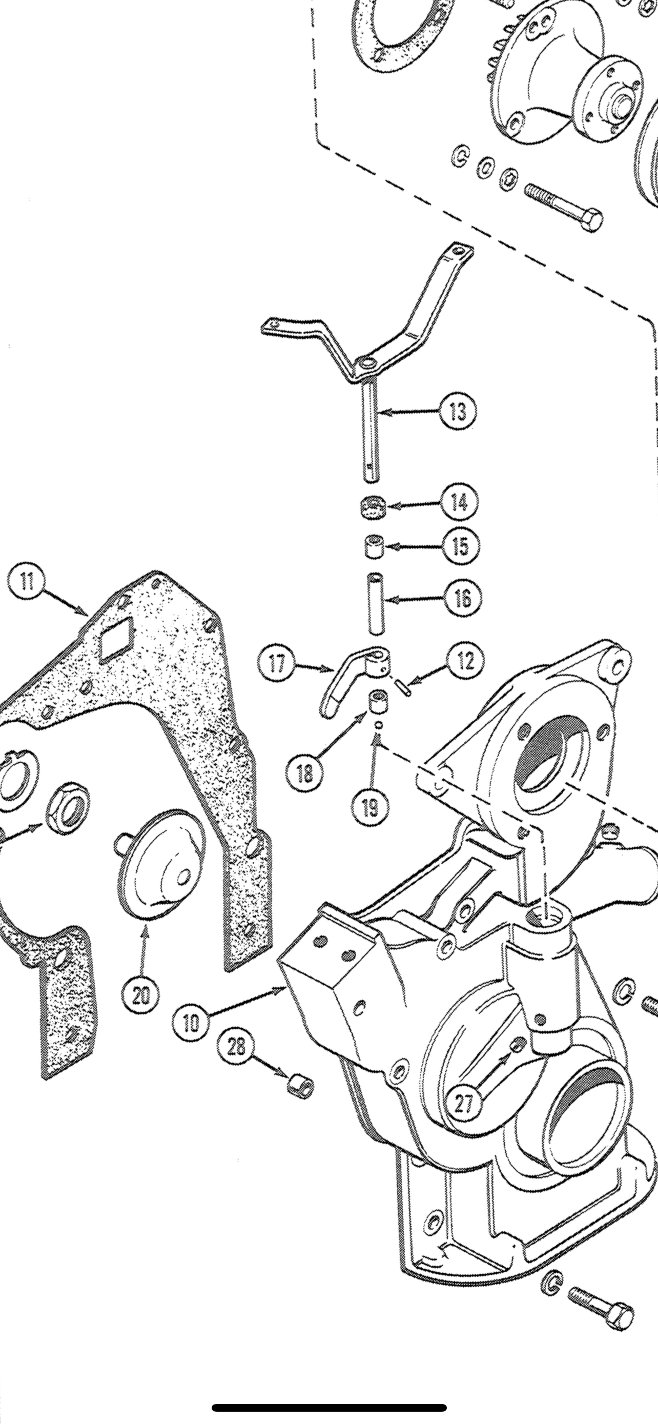

Did the roll pin come out to let it drop or go up to damage it like that..?? Seems it would have sheared it if it got caught on something.
I checked Case Construction, and it says N/A. Saw a used one, but when you go to the site Roberts Tractor Parts Camden, OH) it shows it's out of stock.
