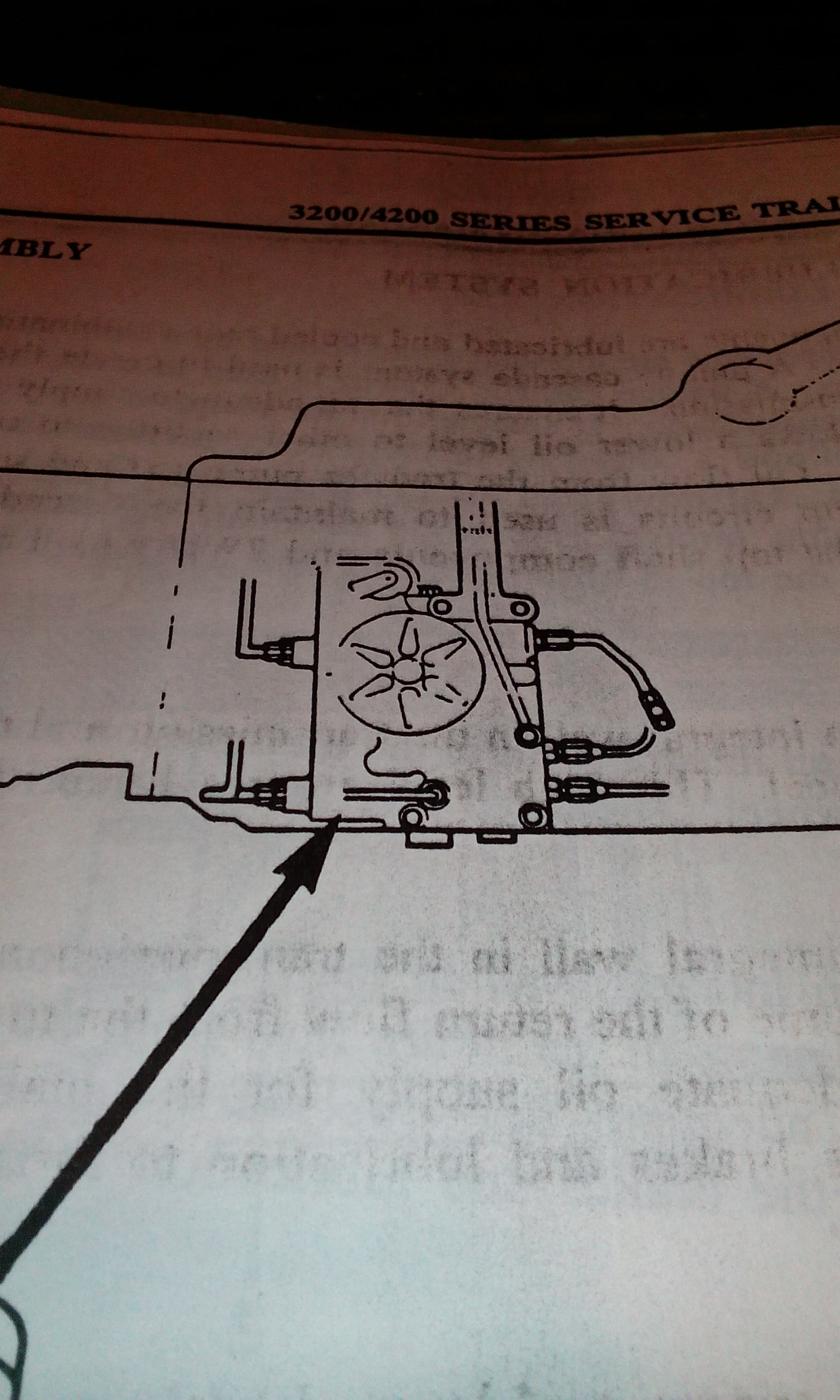

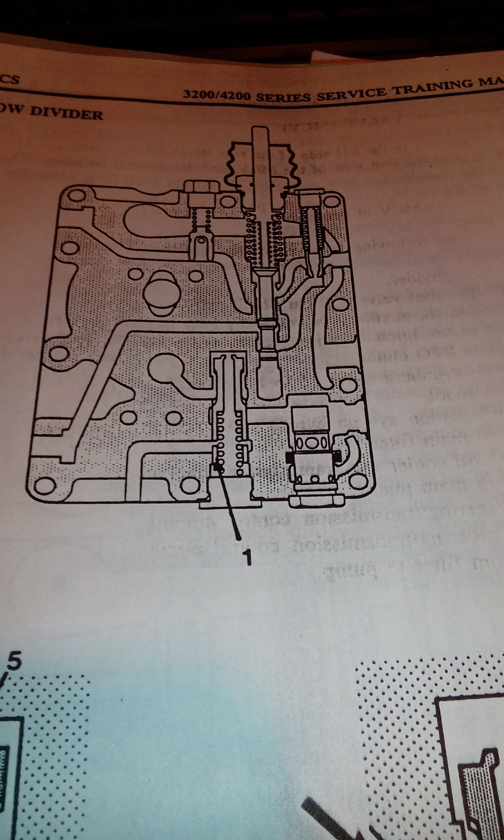

   / case 485 - little to no hydraulics #4
Under the hydraulic filter is a valvebank called the mcv (multpil controller valve ) and it you lay under the Tractor you will see a few plugs going in it from the bottom . Remove the front plug and the spring ...then you put a bucket under the Tractor and start and rev the engine until that valve pops out
Perfect thanks. Will climb under there and let you know what we find.
   / case 485 - little to no hydraulics #6
Thanks. Those images are very helpful.
Thanks again DLTrekkers. This is very helpful. Do you think I should start off by checking the priority valve first?
My thought, which might be dead wrong, is that if the power steering is using the same hydro system and it works ok the issue is probably with the valve and since if it was clogged at the filter it would affect the steering as well?
