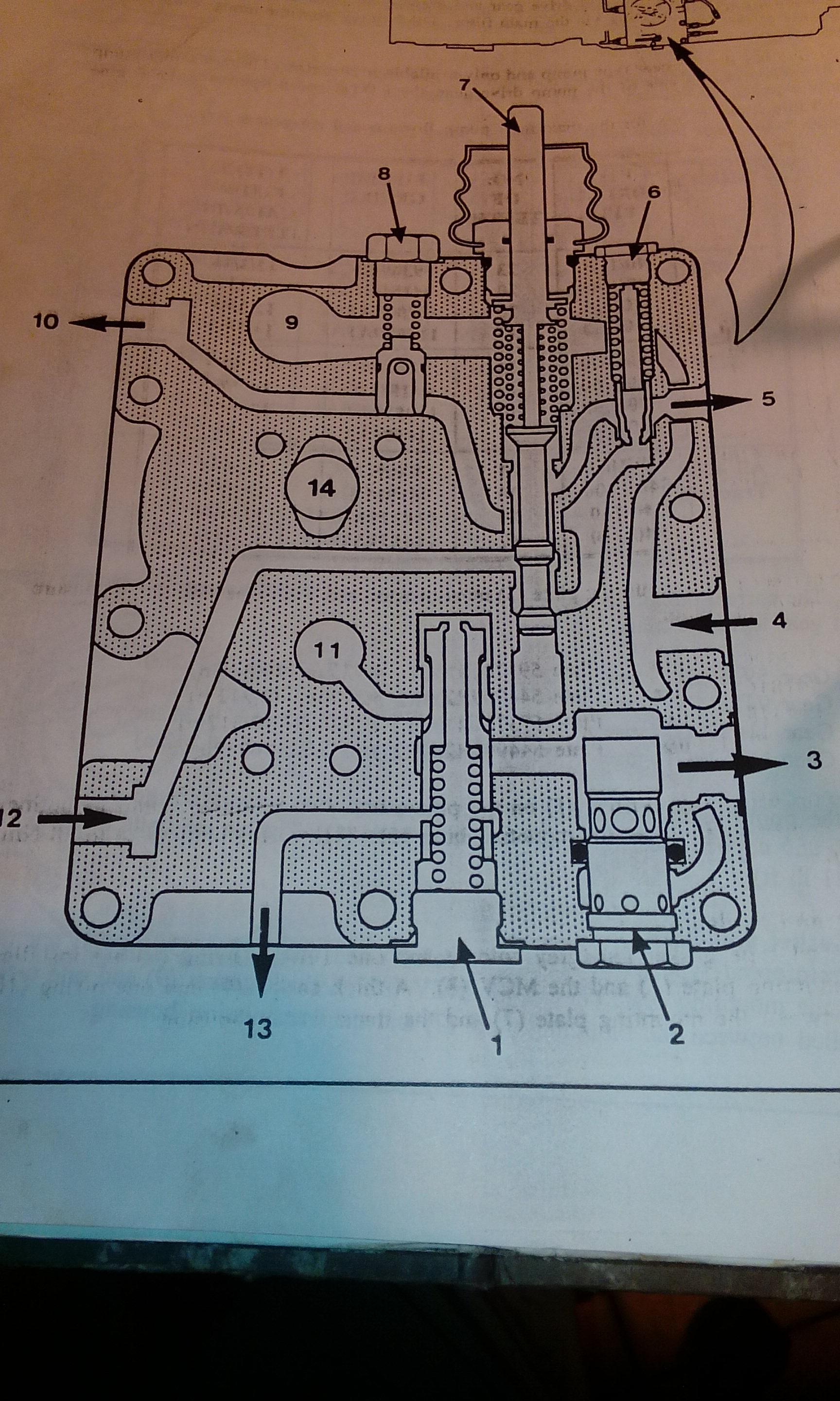

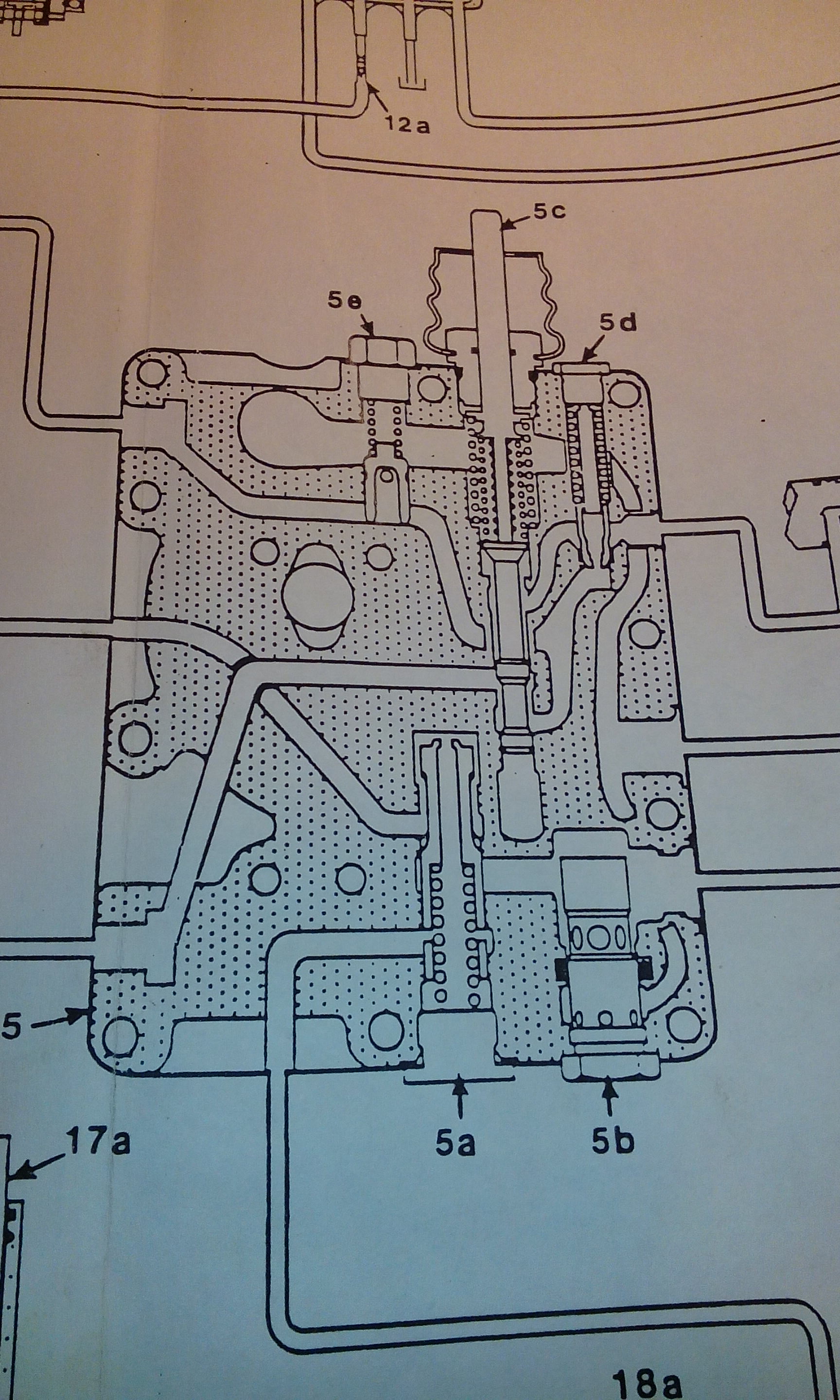

12 is return oil from steering
3 and 4 to and from hitch
5 to pto pack
11 supply from pump
13 supply to steering
2 pilot relief valve
1 priority flow divider
   / case 485 - little to no hydraulics #23
Thanks ! The seal that the mechanic actually replaced was the main pump seals, and I think that that is the problem. If it was any valve problem it wouldn't work correctly for a single moment but it did work nicely for 5 minutes. Going to check those valves and then I'll report.
And I must mention that he didn't use any type of gasket between the MCV and the transmission, he made one from windshield sealer.
   / case 485 - little to no hydraulics #24
windshield sealer. is ok between casing and plate but between plate and MCV IS CRITICAL TO USE GREEN SEAL AND REINFORSD GASKET

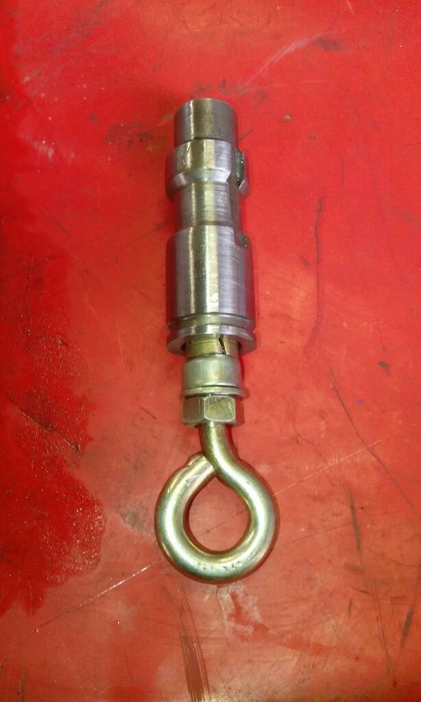

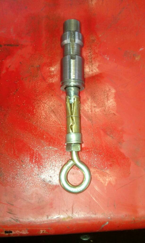

I am having a similar problem. I have removed the plug and spring. I put a bucket under the tractor and it is spraying hydraulic oil everywhere, but the valve has not come out. Anybody have another suggestion to remove the valve?
   / case 485 - little to no hydraulics #29
rawbolt/expansionbolt 8mm tightern in hole and lever out...then polish till it do not stuck anymore.
   / case 485 - little to no hydraulics #30
Genius! Thanks a million. I will try that when I get home.
