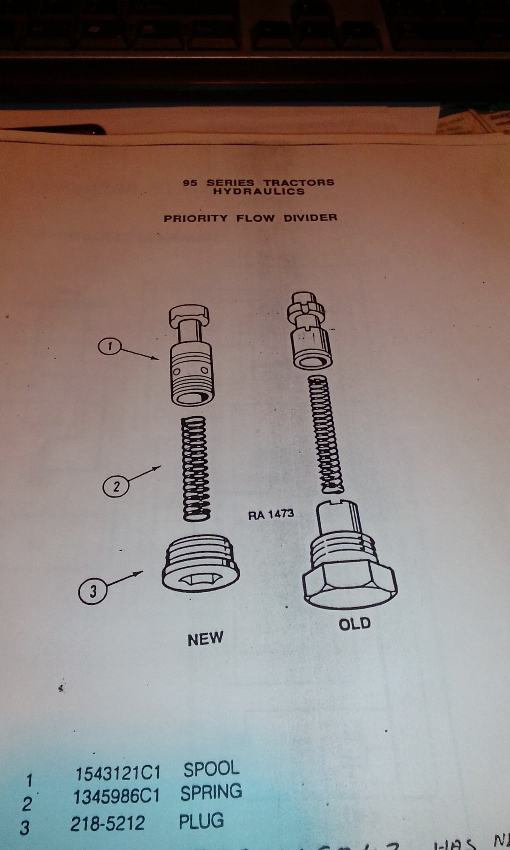

When priority valve is stuck the steering will work ok at lou rpm s and good at hi rpm s but allels will not work well. So ....check priority valve first.

Thanks for the fast answer. In your opinion it's a valve that is causing this huge mess? When you refer to priority valve are you talking about the flow divider? If you are, is there any special metod to insert it? I think that the piston goes in first and then the spring and that's all. I still need to check on the pilot relief and then I'll report. I just think that it is quite odd that the PTO starts sometimes when the lever is on the off position.

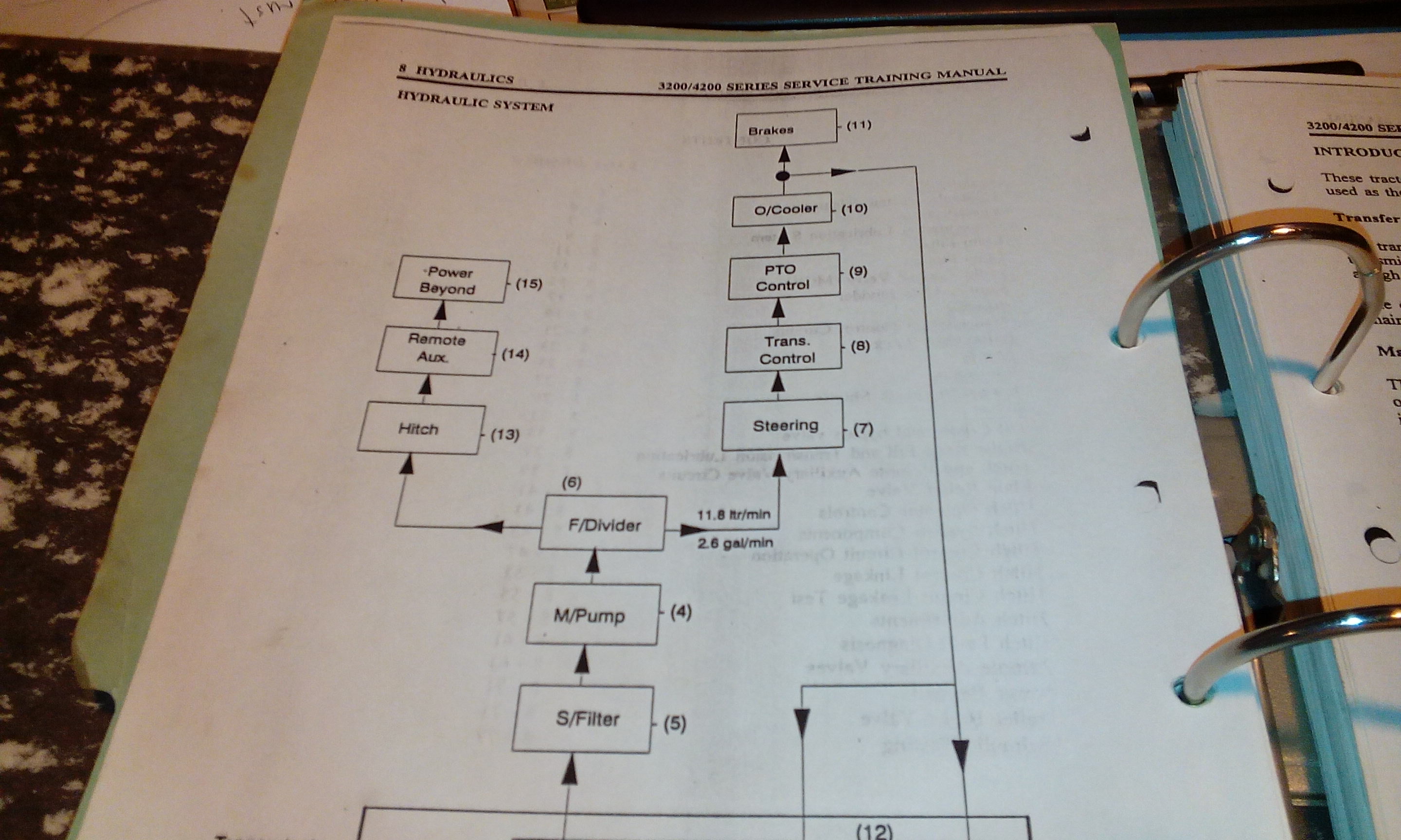

I'll recap what ive done to date since it seems like there is now 2 threads.
Neighbor has Case 485 FEL fails to lift/curl, 3pt fails to lift
Power steering works at low high rpm
Rear PTO works and when was engaged caused 3pt arms to drop.
Hydro fluid is full
Priority valve was removed cleaned and reinstalled, was clean, no difference.
Tractor only has 650 hours!!
It seems like it is a valve related issue but not sure where to look next.
Thoughts on next troubleshooting steps?
Thanks in advance for your help.
Sean
   / case 485 - little to no hydraulics #20

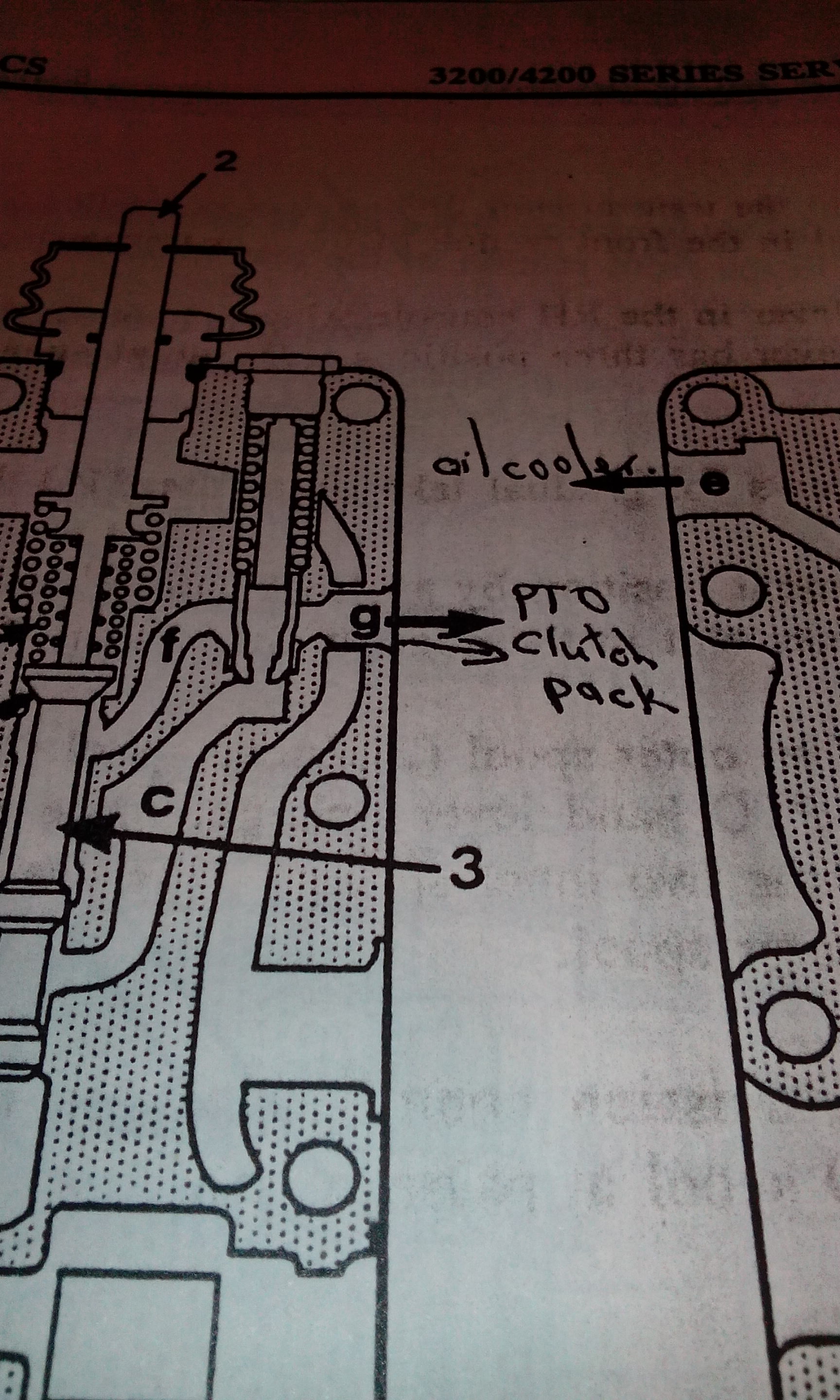

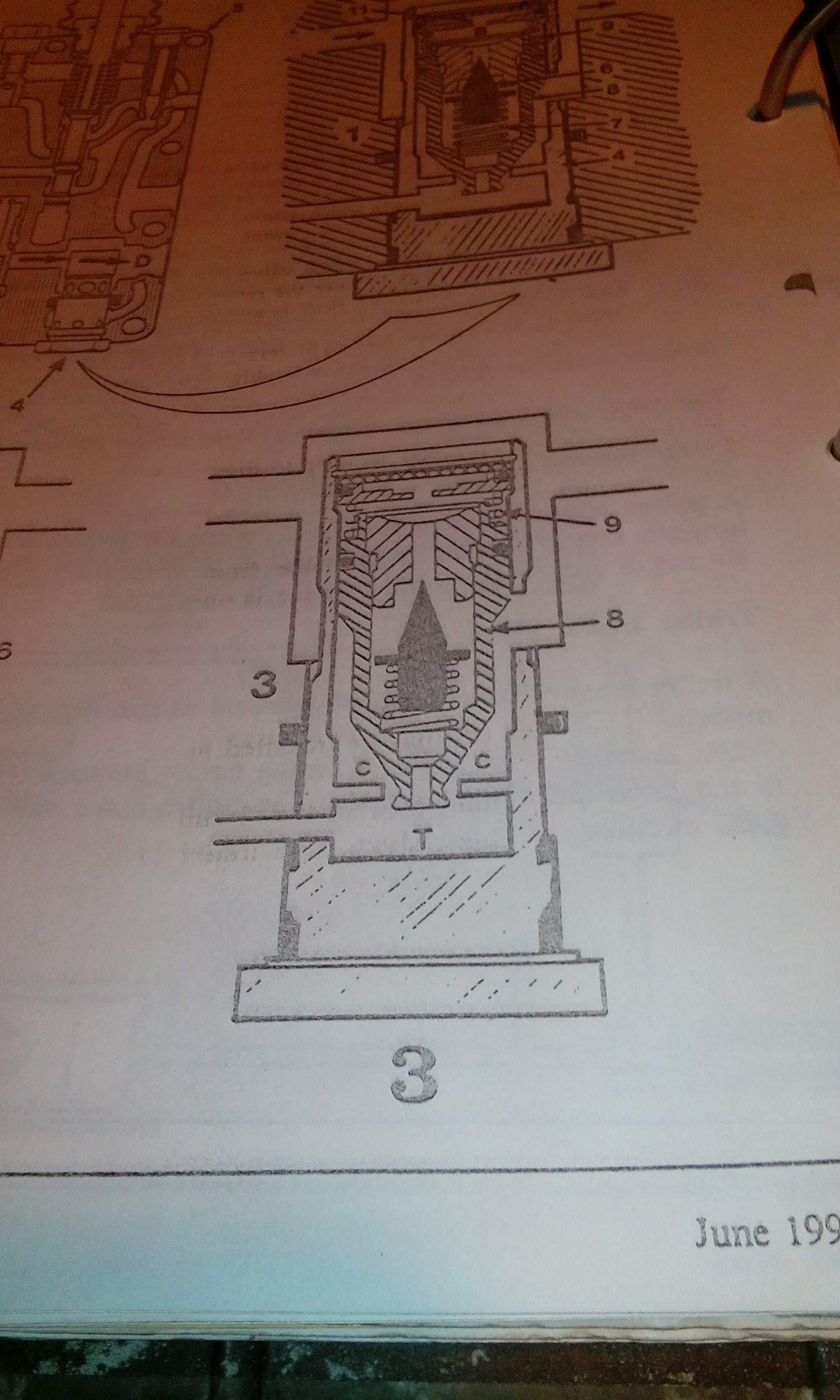

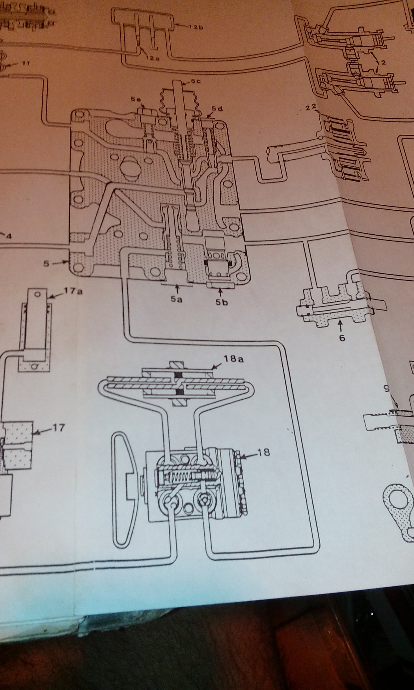

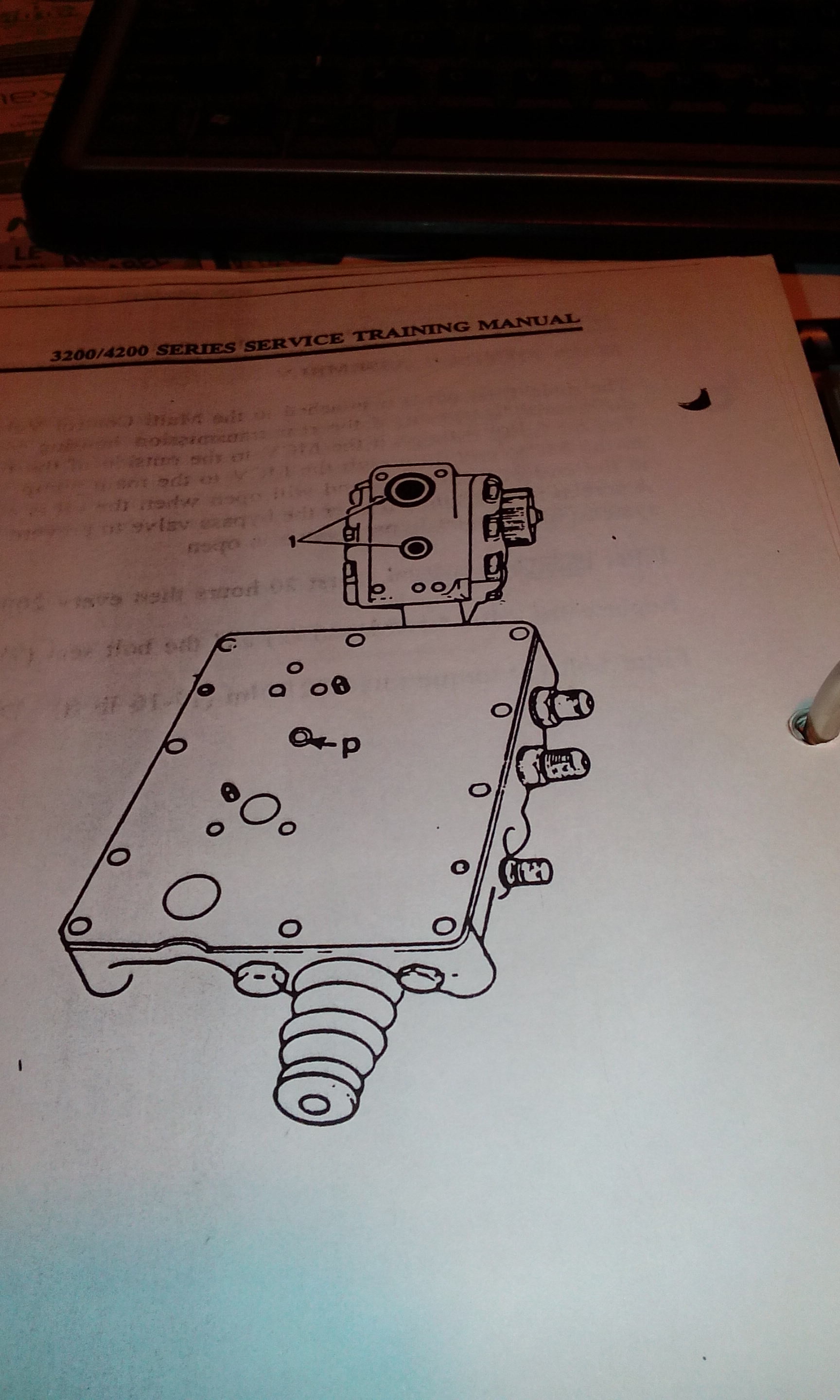

If all do not help... drain oil and remove hydraulic filter and then MCV and then remove pump from MCV taking care to check o-rings. Then split plate from MCV and inspect gasket (should be a reinforsd gasket) and a green teflon washer. Then strip MCV and clean all ports and channels.Some scraped old gasket could be bolcking a channel . Iwill post a pic on the next post
