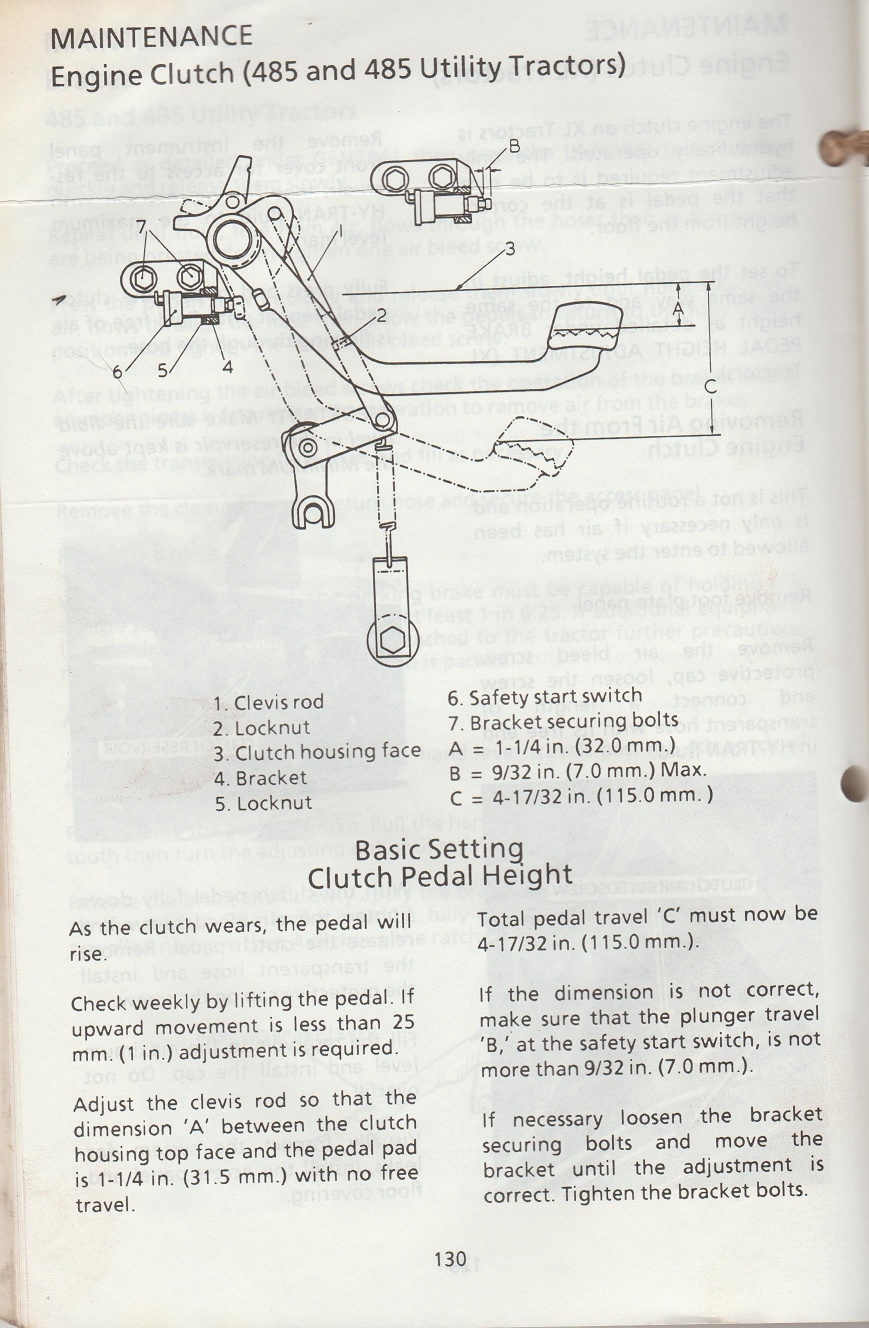

I am finding that my power is somewhat cyclical on my tractor when driving and especially when pulling my box blade. Motor and rpms stay consistent but power/pulling is weak and cyclical. Is my clutch going out on me or does it just need an adjustment? I have no other issues with it going into gear etc
Any help appreciated! Thanks!

Could be both, but try the adjustment first. If you've been operating with little or no free play on the pedal, the clutch is suspect but may still have some life left. Try adjusting the clevis on the rod leading down from the pedal. Unscrew the yoke a few turns until you have an inch or so of free play on the pedal and see what that gains you.

Free play is generally the distance you can depress your clutch pedal with two fingers. At that point you should be able to determine that the throw out bearing is in contact with the pressure plate release levers. Provided the pedal return spring(s) are functioning properly, you should be able to see the shaft entering the clutch housing rotate just slightly, sometimes you can actually hear the contact internally.
The concept is when the adjustment is too tight, the throw out bearing can hold pressure on the release levers, not unlike when you push the pedal down part way. This reduces the grip on the clutch disc. If you run it that way long enough, the disc material wears down, pretty soon the tractor stops pulling. Sound familiar?

Self adjusting clutch should cause the pedal to lift higher as the clutch wears.
Likely need a clutch, pressure plate and flywheel to make it work like new again.

Is this the self adjusting clutch you're referring to?
/ Case IH 485 Clutch Issue?? #9
Linkage looks correct, you have to adjust pedal height with turnbuckle "11"
Eventually you run out of adjustment and the clutch is toast.

From my 485 operator's manual
