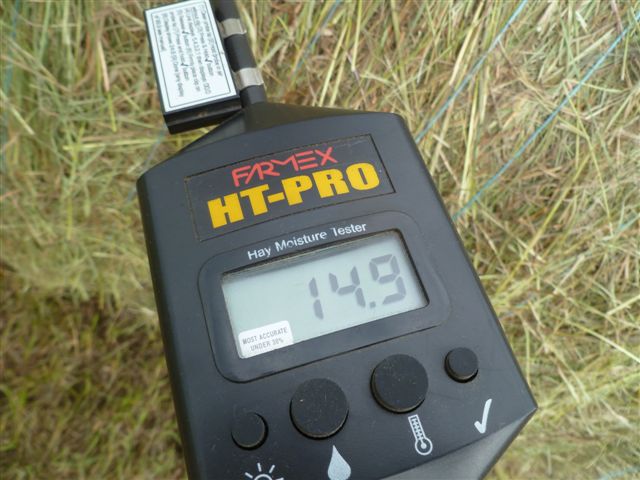

What moisture level is the hay you're trying to bale? . Hay and especially grass hay over 16-17 % moisture has a tendency to start wrapping on belt rollers with just about any brand baler. I suggest to get a hay moisture tester and start baling when the hay is 15% or less
Balers used to make silage bales(high moisture) have scrapers on every roller to prevent wrapping/buildup.
