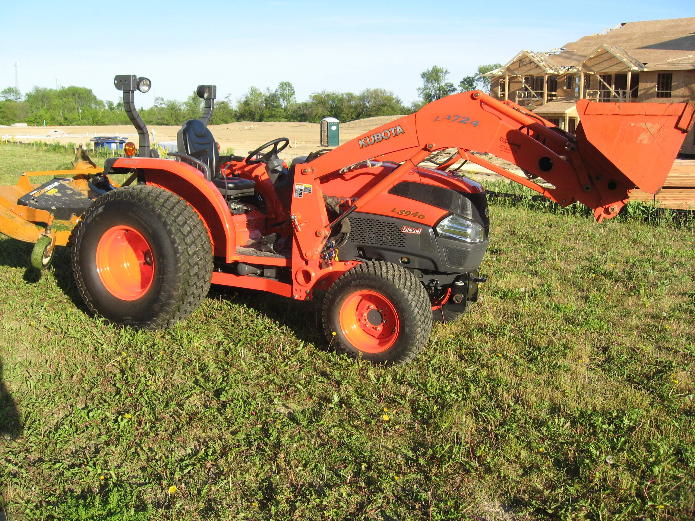

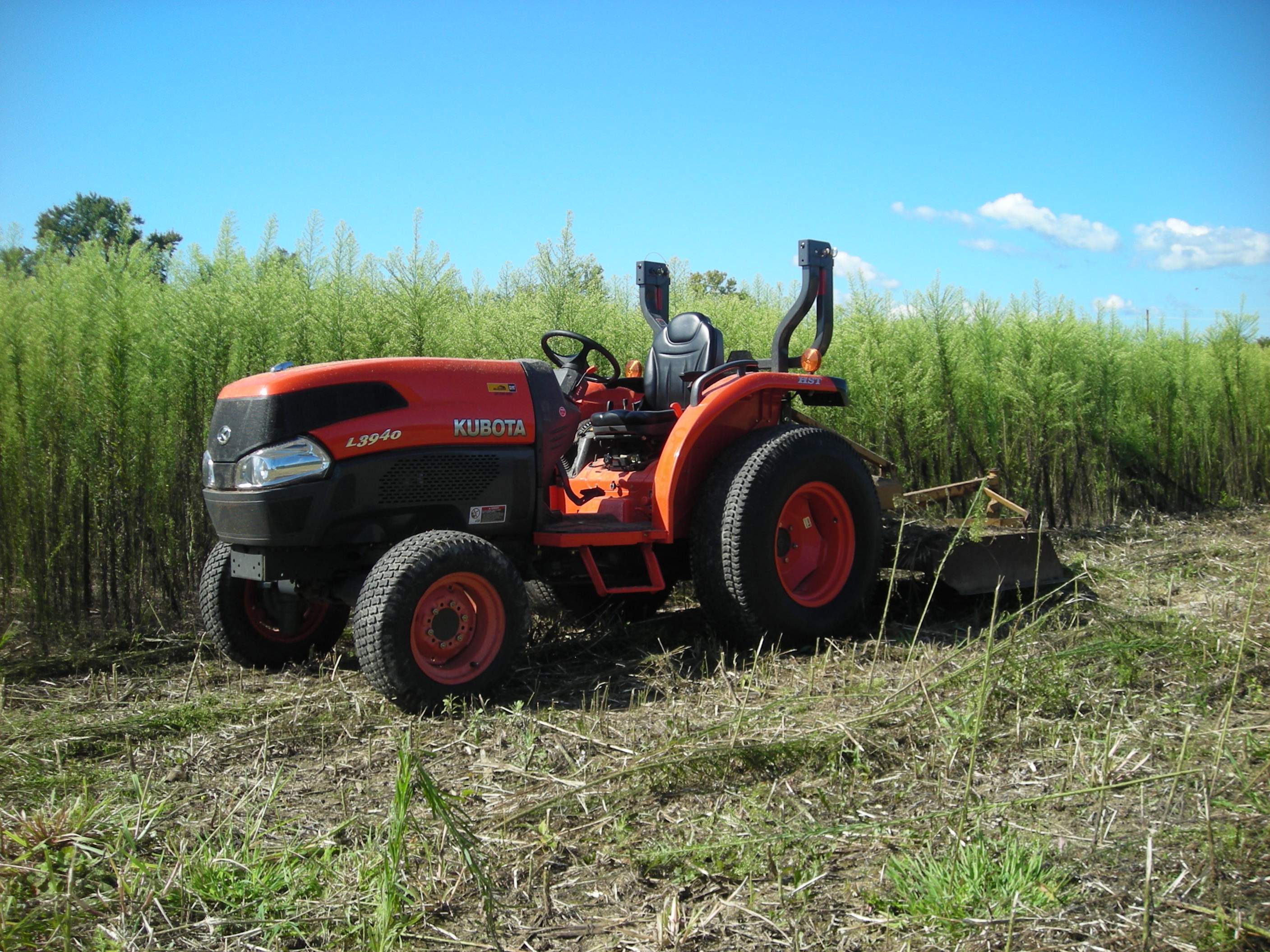

I think you would only notice the 5hp difference if you did bush hogging with a 6' cutter in TALL and HEAVY weeds or had a high pto demand like a high kw generator. I am not sure what the difference is in loaders, but there is nothing I have not been able to pick up in the 6' bucket of my LA724 loader. I am a seasoned operator, and I still use the auto-throttle, H-DS, HST response control, and occasionally stall guard. Sure, I am pushing the L3940, but that is because I have one and have driven others and find the Grand L series tractors to be the most useful to operate. My advise, drive both tractors before making your decision, then don't look back. Philip.
