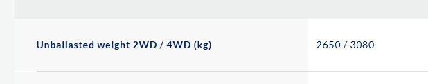

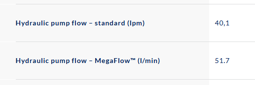

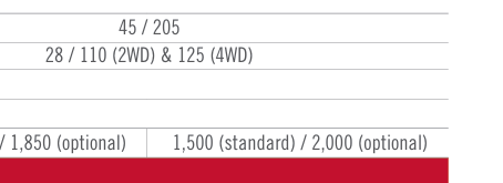

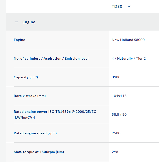

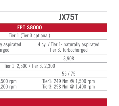

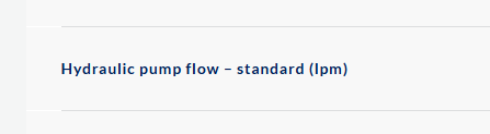

Case JX75T vs New Holland TD80 which one to buy?
Appears the JX75T and TD80 referred to are not a North American models, most on this board are US/Canada. Looks like they are similar tractors with same basic engine. New Holland is a little heavier and 12x4 standard. CaseIH slightly more hydraulic flow base, NH has optional mega flow. NH has way higher 3pt capacity 3565kg versus 2000kg.
