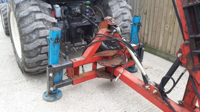

I use my Boomer with a Cat 2 Protech Post driver, which is about the maximum lift capacity possible for it, it also has a heavy loader on the front, and I take it up and down steep tracks, no problem.

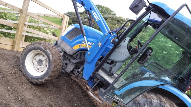

My boomer is up to 808 hours now. So I've put over 400 hours of hard work onto it, including 500+ tons of material hauling over 1/2 mile distances. So much so, all the pins in the lewis loader I have have shattered from using it like a digger and leveller laying down chalk, crushed concrete, sand, clay.
Recent issue I had was not being able to select forward or reverse. I solved it myself, little rocks had wedged under the accelerator which has a potentiometer in it, it was keeping the foot lever depressed enough that it would say RP on the screen.
In terms of moving around, set hand throttle to 1500rpm, then set Cogs power to 35% for hills, in 4WD it goes up very steep hills no problem. I have entrances to paddocks which will 3x wheel the tractor, so you sometimes have to lock the rear diff. It's 50Bhp, don't expect 15 mph going around hills. I get to 7-10mph on relatively flat hilly paddocks, I think it would do 15mph on flat roads no problem at all.
Safety concerns, make sure you put feet on brakes first, then put hand brake on if stopping on steep hills. If the engine switches off, the vehicle will roll backwards by iteself, but idling it will stay still on any hill. In fact, slippery service, I had the issue of the back wheels not turning at all, I had to give it throttle to stop it skidding sideways down the hill, you don't need brakes with the CVT, as it always comes to a complete stop very quickly.
