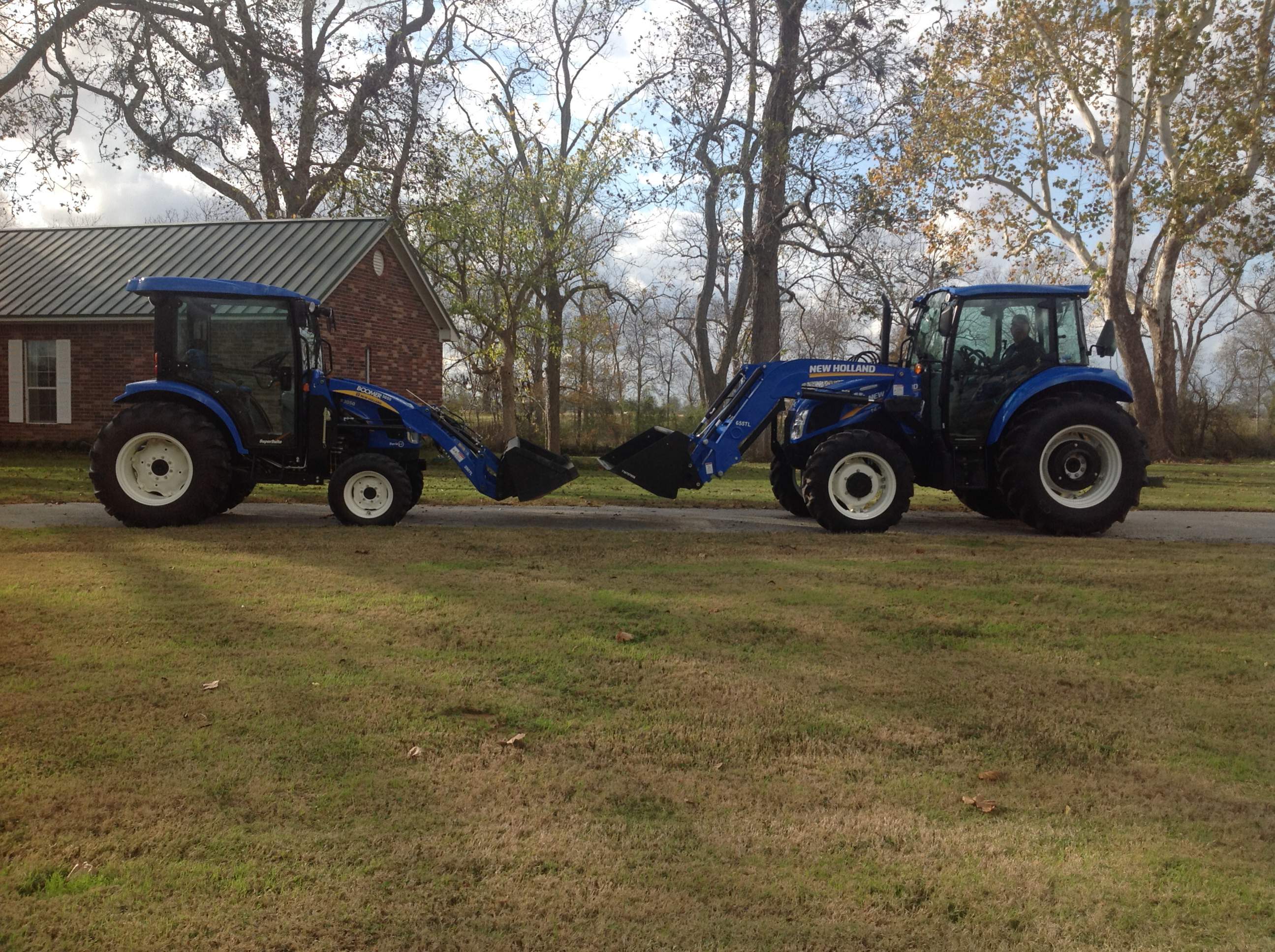

My self and another member Jackfrost both bought Boomer 3050's with CVT about, a year and a half back and both of us traded them in within a year due to huge technical problems and dangerous use conditions. We both opted for the standard sized T4.75 with 12 x12 transmissions. Look up either of our tag names for a lot of information. Bottom line for me is no more CVT transmissions on anything below 100 HP. I was serious enough trading the Boomer 3050 in to take a huge financial hit. I have also noticed that my local 2 NH dealers, one who carries over 50 units on his lot, no longer has any with CVT transmissions. Below is a picture of the day I traded in the Boomer 3050 with CVT for the T4.75 with 12x12 transmission.
PS- I have a hard time believing someone would go to all the trouble to change the computer ratio/speed settings 2-3 times per minute manually while trying to get some serious work done on a slope. Another reason I did not like the CVT set up on the New Holland Boomer 3050 was the toggle switch adjustment for the cruise control. My home orchard has 850 foot long rows and while mowing having to toggle down and then toggle up turning at the end of each row multiple times per row became really time consuming. The toggling does not take you back to the speed you were going before automatically and you have to toggle 2-3 times per turn. That times over 200 turns per mowing becomes a huge hassle. Just to mow my small acreage once involved changing CVT speed ratios and the cruise control toggle switch too many hundreds of times. For open fields with very long straight runs the set up would be fine but in my case was a huge hassle. I own 27 tractors at the present time from a 17HP to 550HP and will not ever use a CVT transmission again. Working a active 2800 acre farm is not play. Your mileage may vary....;)
