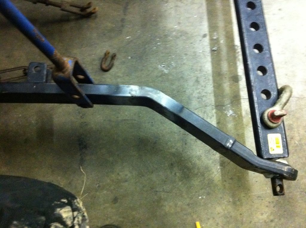

Per Request, I measured my lift arms on my S373D Beaver tractor.
See attached pictures.
Refer to the thrid picture: By loosening up the sway chains (plus bushings to step up from 5/8" pins to 7/8") you can use Cat 0 attactments. The problem is that the where the top link attaches to the tractor is too high, so the top link and bottom arms are not parallel and the attachment does not go up level. I plan to add a third attaching point to the tractor bracket to allow the cat 0 lift link to attach right above the PTO shield. I will need to lengthen my top link as well.

Thank you very much! Is the distance for your cat 1 implements 21" or 26"? I've noticed some sub compact implements are 21 inches between the eyes instead of the standard 26".

Is your drawbar setup 26" wide or 21" wide? I can make a 21" cat 1 drawbar fit with my Existing arms, but it won't work on my back blade or box blade, hence why I got a 26" wide drawbar

Gotcha. Sorry I assumed that was cat1 Stuff. Do you think there is enough room for the arms with another 2 1/2" on each side? I was given a 4' box blade and bought a 5' scraper blade and they are 26". I would like to use them instead of selling everything and staring over...

One thing that I've done for my B6000 Kubota and one of my Yanmar machines is to reverse the pins on the implement, so they face inward instead of out. That seems to work well and allows the smaller machines to fit standard category I implements.
If that isn't possible (some configurations of implement pins can't be reversed and still function correctly) you could go with the cheap replacement arms. Instead of heating them and bending them yourself, I would go to a steel yard. The guys around here only charge a couple bucks to use their vast press. They can just crimp some bends directly into the arm, and it would be precise, repeatable, and consistent.
The cheap replacement lower arms from Agri-supply I've bought work ok, but they are definitely flimsier material than OEM. I would expect to bend them trying to back fill with a box blade. It would be worse if they had a bend in them. The Beaver is light enough that you'll maybe be able to get away with it, but if they have a thicker heavy duty option and you're planning on pushing with the box as well as pulling, I'd suggest going with those.
   / Cat 1 Three Point Lower Lift Arm Dimensions #10

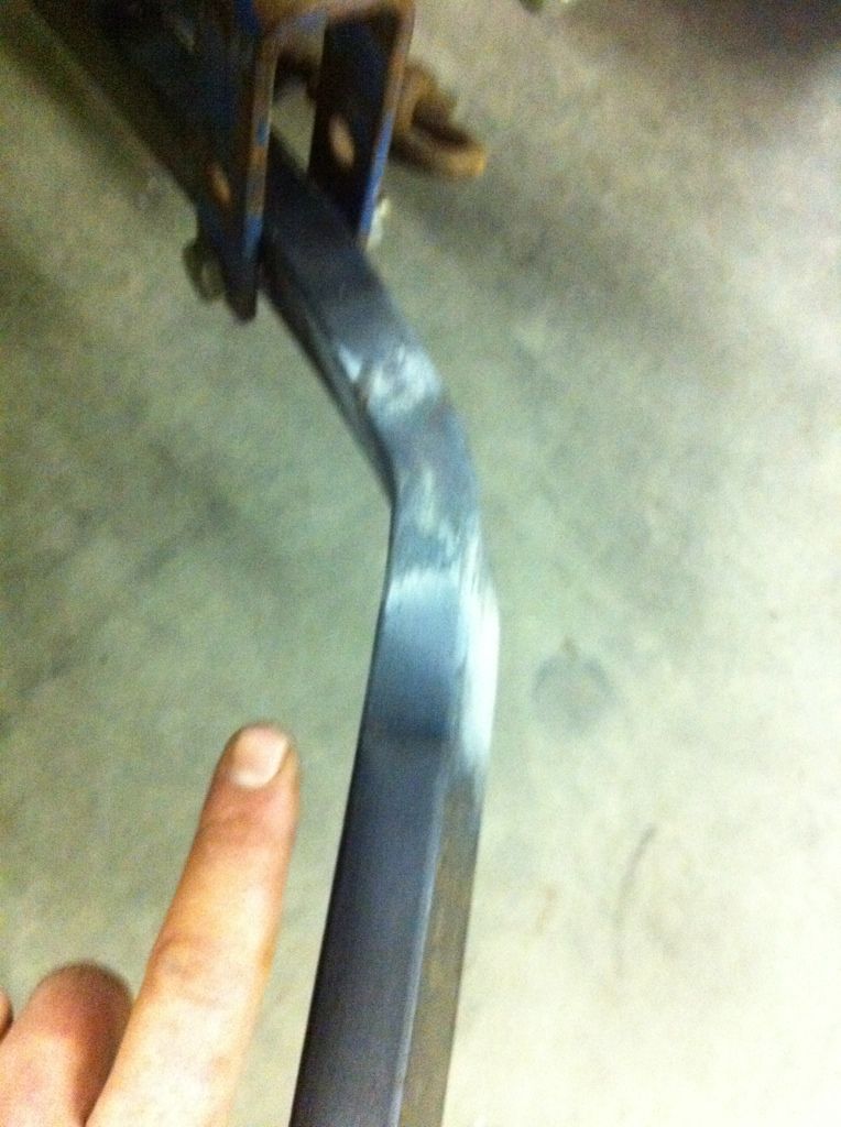

I was going to get a set of the yanmar arms as suggested, but a buddy gave me a set of brand new John Deere lift arms off of a 4000 series tractor. They were straight other than the ends. Did some heating and used a press. Thanks for the pics and measurements. Just need to weld on some tabs for the sway chains.

You going to want your ends perpendicular to your hitch bar otherwise they will not fit into attachements that have 2 brackets you put a hitch pin through (vs just a pin sticking out).
Otherwise they look good!
   / Cat 1 Three Point Lower Lift Arm Dimensions #12
Yeah. We ran out of acetylene, so I'll have to wait until this weekend to fix the ends.
