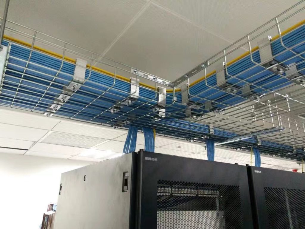

you do realize that wiring cabling trays are steel or aluminum. they run for 100's of feet in many, many buildings. including telephone companies and internet provider facilities. the cat6 wires are laid in them.
and in metal stud buildings there even run thru walls horizontally in conduit. wire-mesh-cable-tray-advanatages-1024x768.jpg
   / Cat 6 Wiring and Electrical Wiring #38
A cable tray is ribbed or vented, whatever you want to call it and not surrounding the cable. Just saying. But one metal strap will destroy the performance?
Looked at the picture. Interesting that the trays are wire racking. Is this for cost? Many old trays were solid metal. IF there was any truth in CAT 5, not being supposed to be installed in metal, this would make some sense.
and in metal stud buildings there even run thru walls horizontally in conduit.View attachment 687213
And on top of that have you considered that Cat5e and Cat 6 cables are often bundled together in large bundles. How about all of that copper wire surrounding any single cable?
