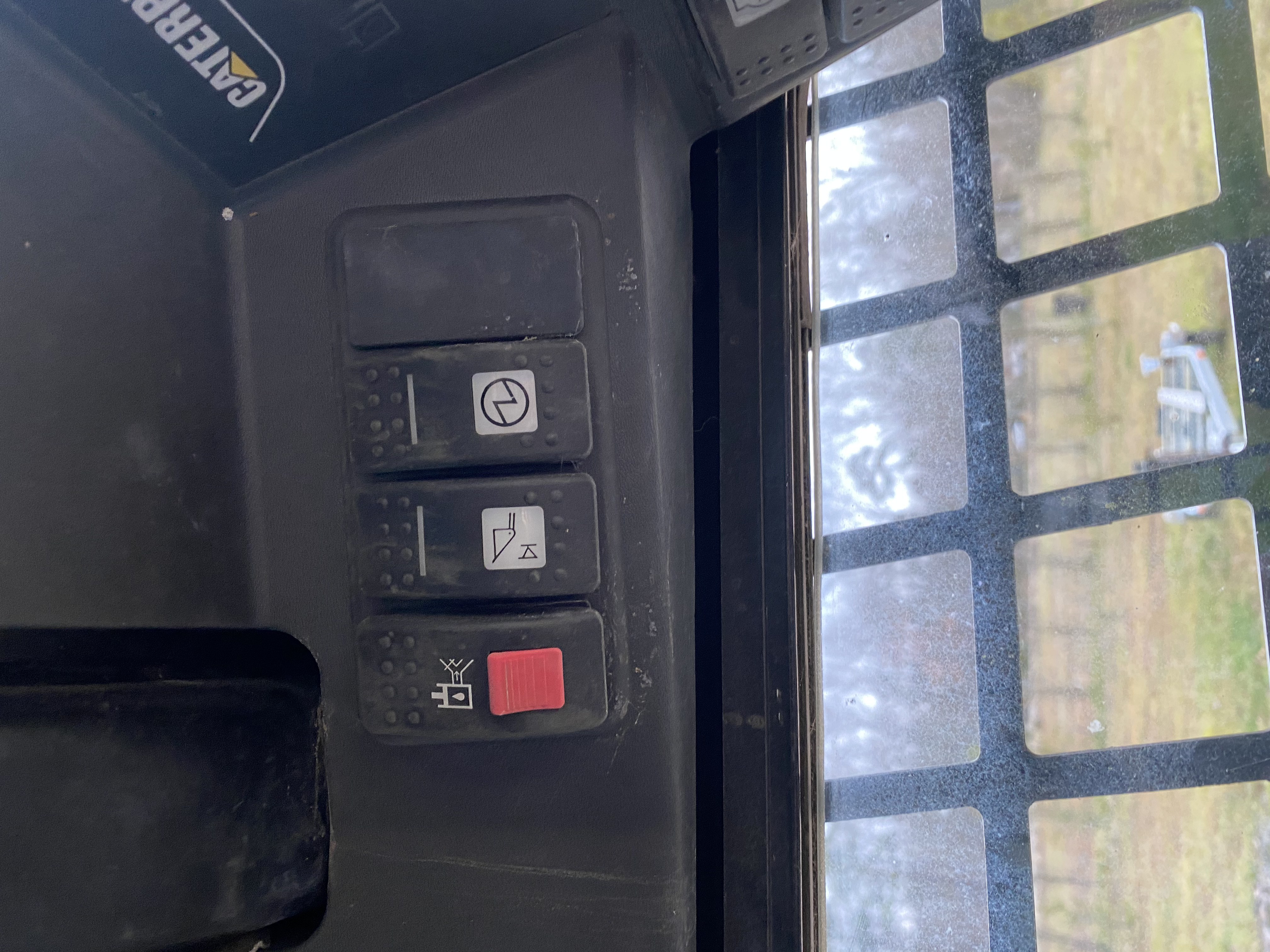

I have a Cat 262b there is one switch I cant figure out what its for. Its the one that looks like a Z in a circle. Anyone ?

That switch is not present in my 279C2 operator manual, what does your's say about it?
   / Cat Skid Steer control question #4
Maybe Ride Control. The current symbol for that is a tire over bumpy ground.

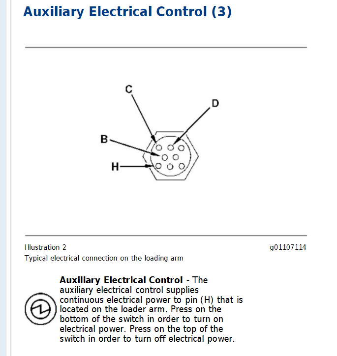

Auxiliary Electrical Control - The auxiliary electrical control supplies continuous electrical power to pin (H) that is located on the loader arm.

Ahh makes sense - thank you !
