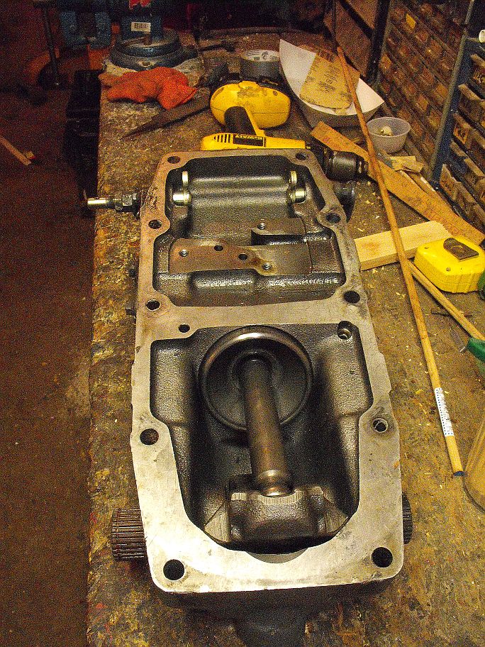

Well, we pulled the housing last weekend and now I understand why it's a $700 part, I also have a better understanding of what goes on inside the housing. Since I don't know the proper names of the components, I'll use terms I think we can all understand. When the 3pt is raised oil is pumped into the reservoir behind a piston about 4" in diameter. In the face of the piston is a recess that a ball-end pushrod fits and the other end of the pushrod is connected to a crank attached to the lift arms. As oil is pumped into the reservoir the piston is pushed up the cylinder, pushing the pushrod, acting on the crank raising the 3pt. When the 3pt is lowered pressure is relieved in the reservoir and the piston retracts.
Only a small part if the housing is actually pressurized and naturally this is where it cracked. We didn't pull the piston since we didn't have a ring compresser to reinstall it but it slides smoothly through its entire travel. As has already been suggested, all things point to 1 of 2 possibilities: a. failed safety bypass or b. overlift of the 3pt from either pushing or backing into something.
My boy drives for UPS and when he delivered to the welding shop he told them what had happened and they said they had just welded a cast housing on an ag tractor so they were confident they could fix it but until they see it, who knows. My BIL is supposed to drop it off today.
I forgot the camera but took pics with my cell phone but can't figure out how to get them off the phone into the computer. Tried emailing them to myself but they show up as .mp3 attachments :confused:

I was able to get one pic off of my phone for what it's worth, hoping to hear from the welder today... stay tuned

Well looking at the attachments it is a spring/check ball set up. It has to freely move to release hyd pressure. It has been suggested it might not have done that correctly
