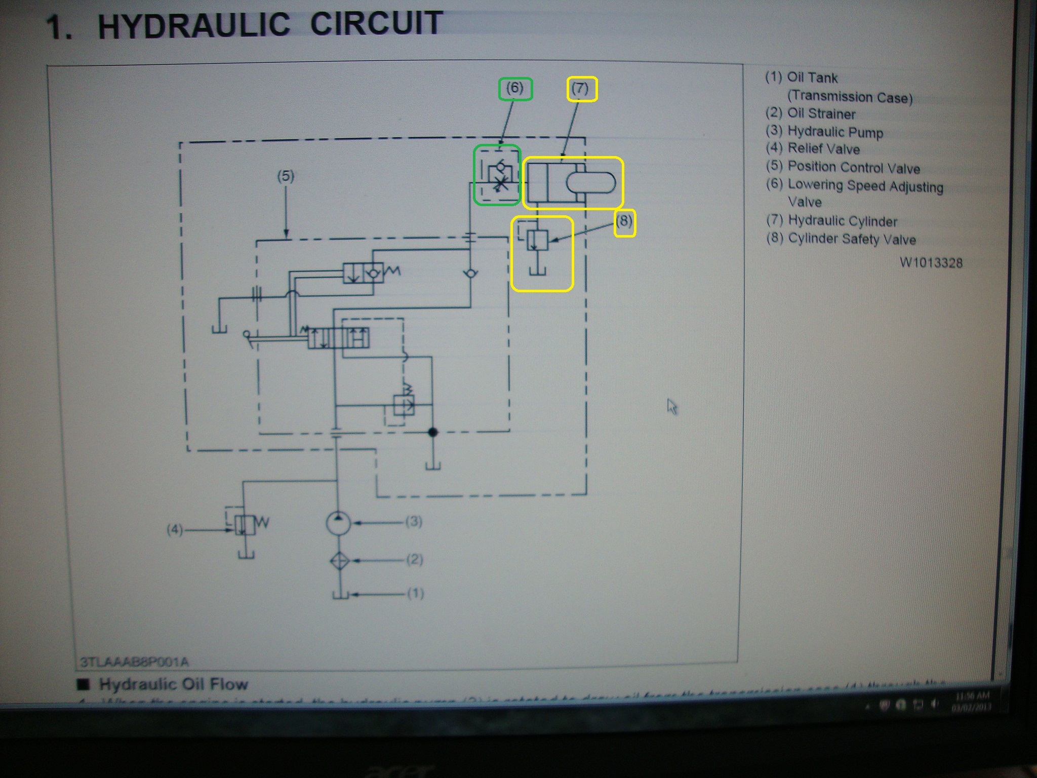

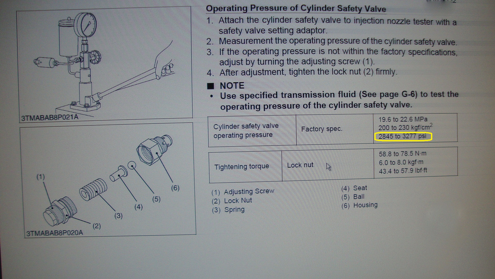

Well looking at the attachments it is a spring/check ball set up. It has to freely move to release hyd pressure. It has been suggested it might not have done that correctly
Thanks, DFB I'll take a look when I get it back.

I asked all the yards if they had any insight into what would cause the part to fail and they all said the same thing, safety relief valve. So regardless of whether I buy a new case or a used one, the safety relief is getting replaced too.

I strongly believe now that the failure was due to over pressure from a failed safety relief not from over pushing with the 3pt (they hadn't pushed with the 3pt at all the day of the failure), even a new part would fail if the safety fails. Also,someone suggested that there was a reason they're called "junk" yards, well I've bought alot of parts from junk yards in my life and just because a vehicle is junked doesn't mean every part of it is junk, IMHO.
