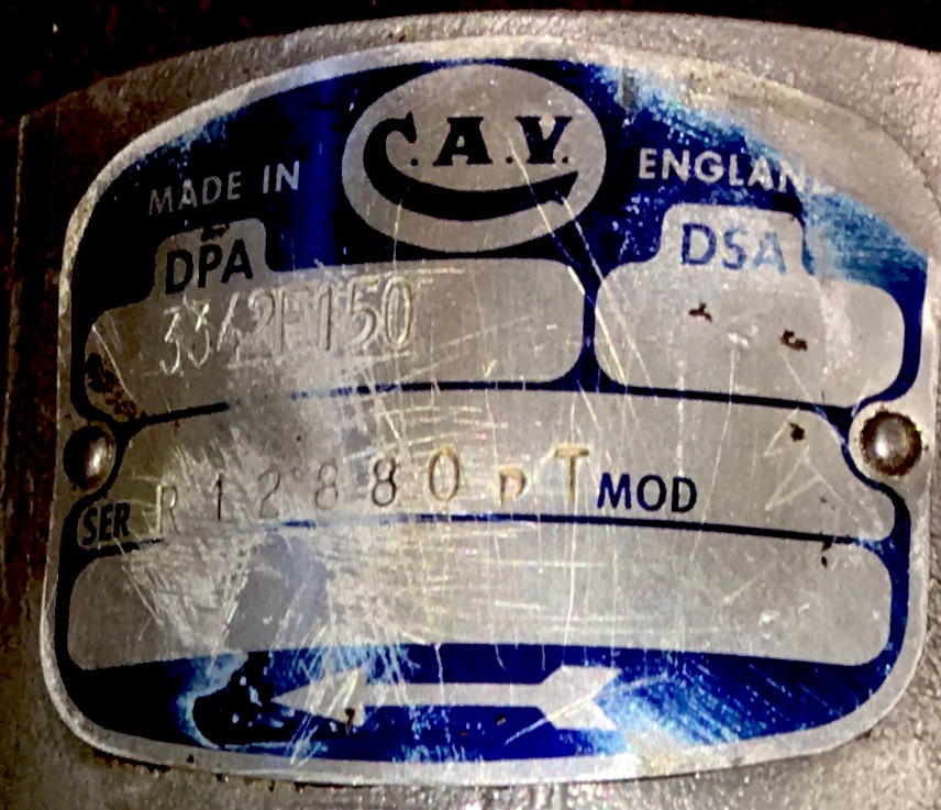

The # is 3342F150
Thanks for the offer. Apart from the FIAT shop manual's bench test data and picture of the governor plate (for pin position), I haven't been able to find any data for my pump. Almost like CAV tried to keep it all secret!
I can see what you mean about the slot now. Found a cutaway drawing that shows it just acts as a fuel duct.
Still, it's strange given that when this fault first appeared all I had done was replace the cover gasket and shaft O rings. I can't remember changing the spring position. Perhaps age is getting the better of my short term memory again...

The spring hooks up in the TOP hole on the gov.. & the back hole on the throttle..

No I didn't touch the rod nuts, I was well aware of that measurement from reading the FIAT manual. I did check it BTW, 54mm, (just within spec).
I removed the 2 little studs instead, seemed the obvious way to do it anyway.
So my spring settings were correct: top hole of the governor plate and back hole of the throttle lever (the one closest to the lever). Thus it appears I am back to square 1. I was hoping I was wrong and you had the silver bullet... Thanks for confirming the settings anyway.
Any other clues? Remembering back to the beginning of this story. At the time I discovered it wasn't getting fuel to the injectors, all (and I mean all) I had done was remove and replace the cover to fit a new gasket and O rings to the 2 shafts... :-(
I guess it could all be coincidence, and something else has failed at the exact same time. However when I stripped the pump for the re-seal kit a few days later, there was no evidence of damage that I could see. No debris, shaft turning smoothly, vanes OK, no thread damage etc. Weird! Working well before, then sudden death for no logical reason. I guess a bench test would reveal all. Perhaps a bit of muck has found its way into the orifices leading from the MV?
So I guess I'll have to pull it off again and investigate. At least this time its all clean and I've been there before. :)
