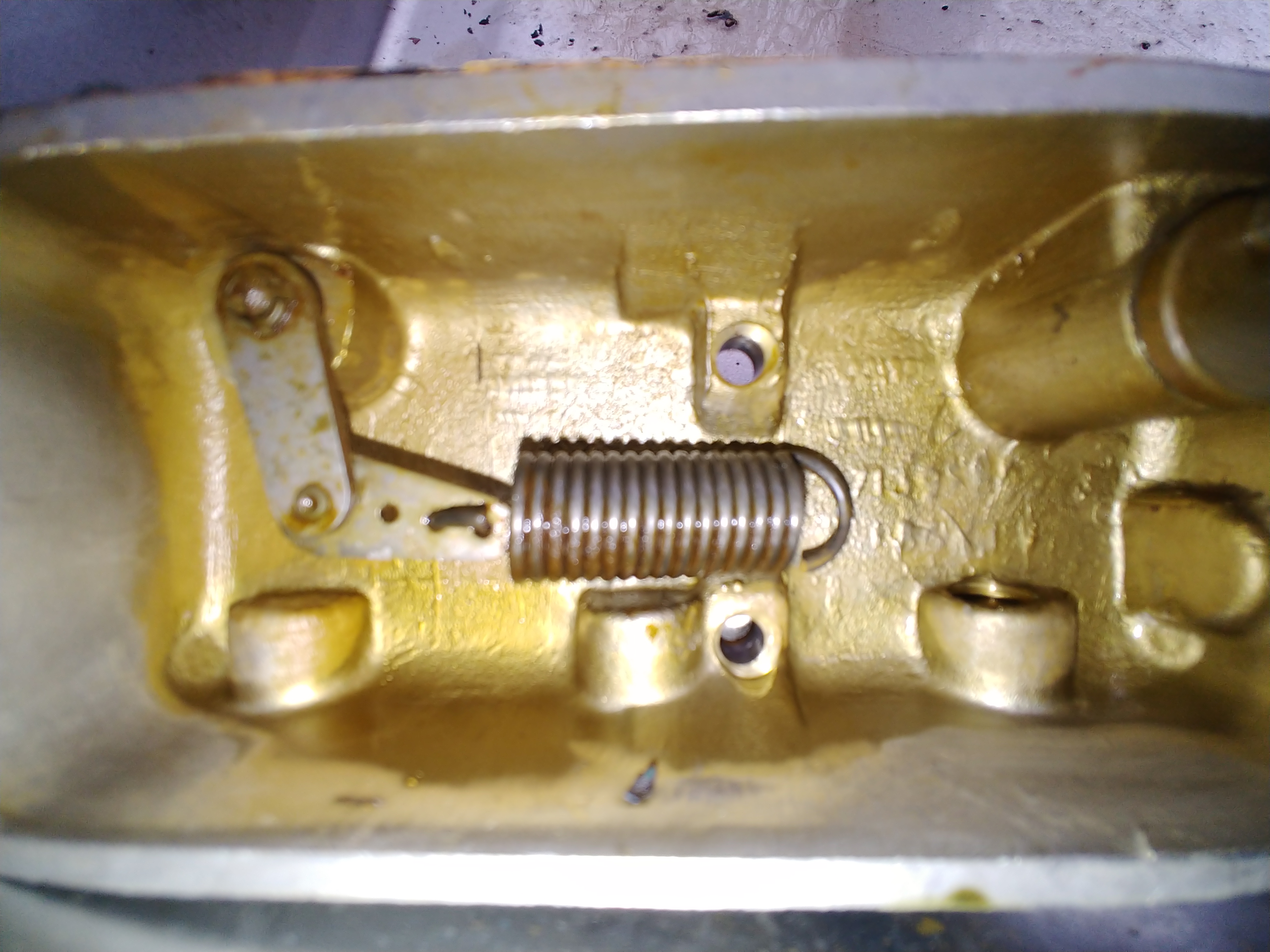

AAAHHH.. the plot thickens.. I "think" I know what happened..
You see the spring is in the #3 hole.. When you put it back on.. the spring HAS TO BE in the center of the lever..
Or actually visa versa.. the lever HAS TO BE IN THE MIDDLE of the spring coils.. NOT on the outside of it..
Give THAT a try..
I know this is an old thread but I have found it useful and thought I would add this;
At first I did not understand what TPG was saying here until I removed the cover from my pump... 20190420_151107.jpg
