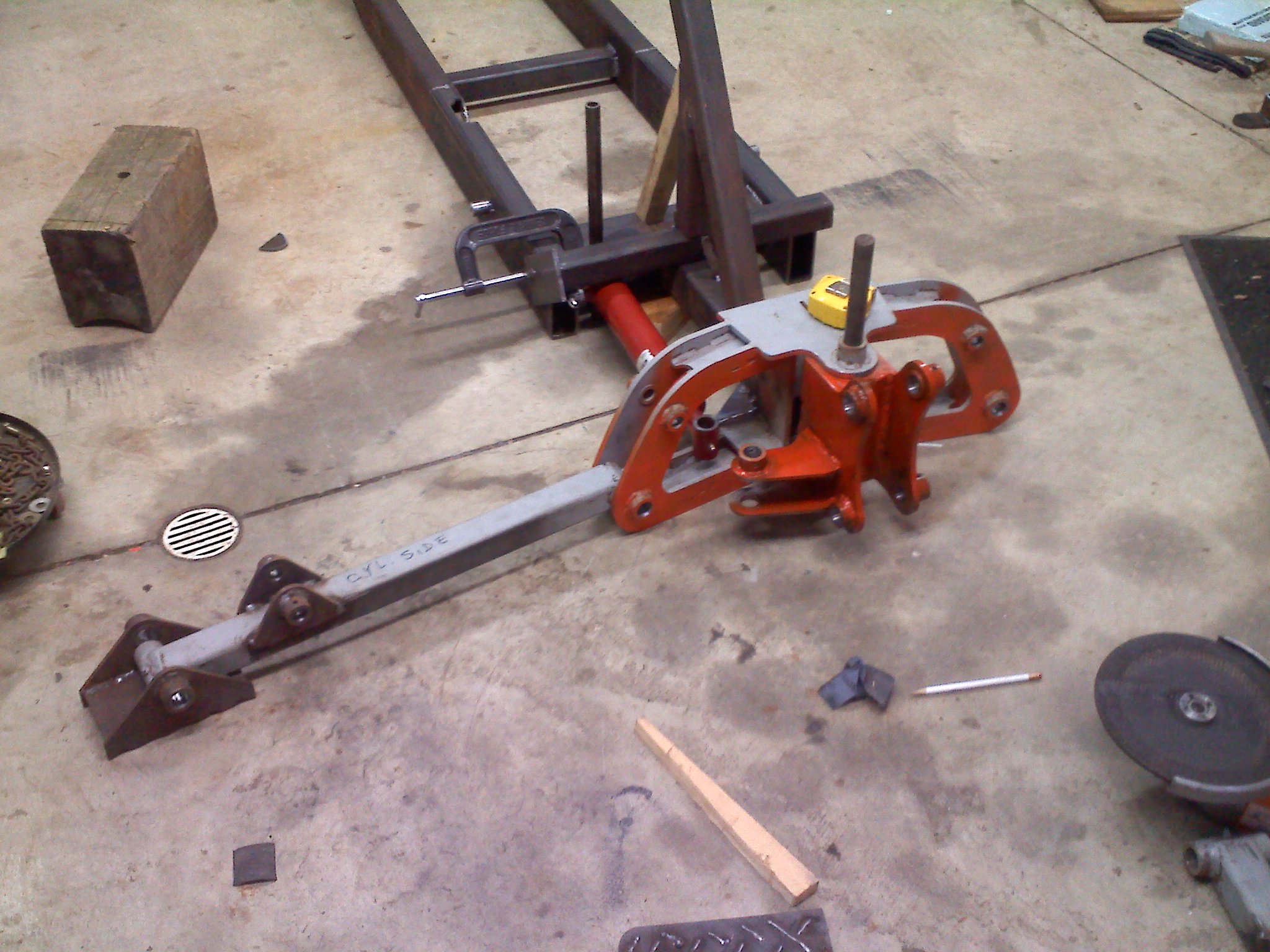

An project up date...got the sub frame done...a few, self created, issues with the front mounting, but is done now! bolts on the the front two 5/8 dia. on each side...the rear has 1 inch stubs that fit into axle brkts.
next step...weld hoe base to the sub-frame.

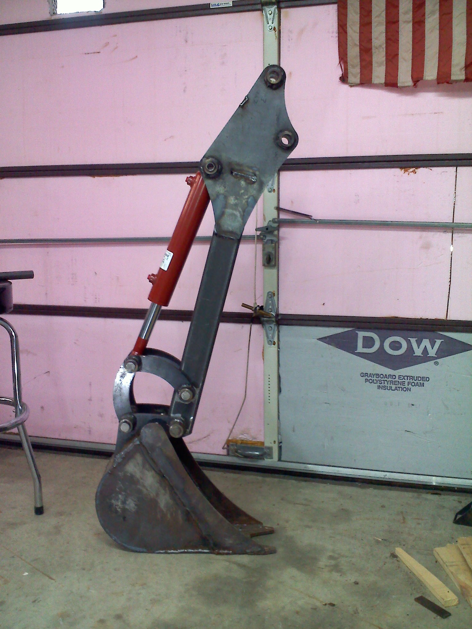

made a little more progress in the garage...

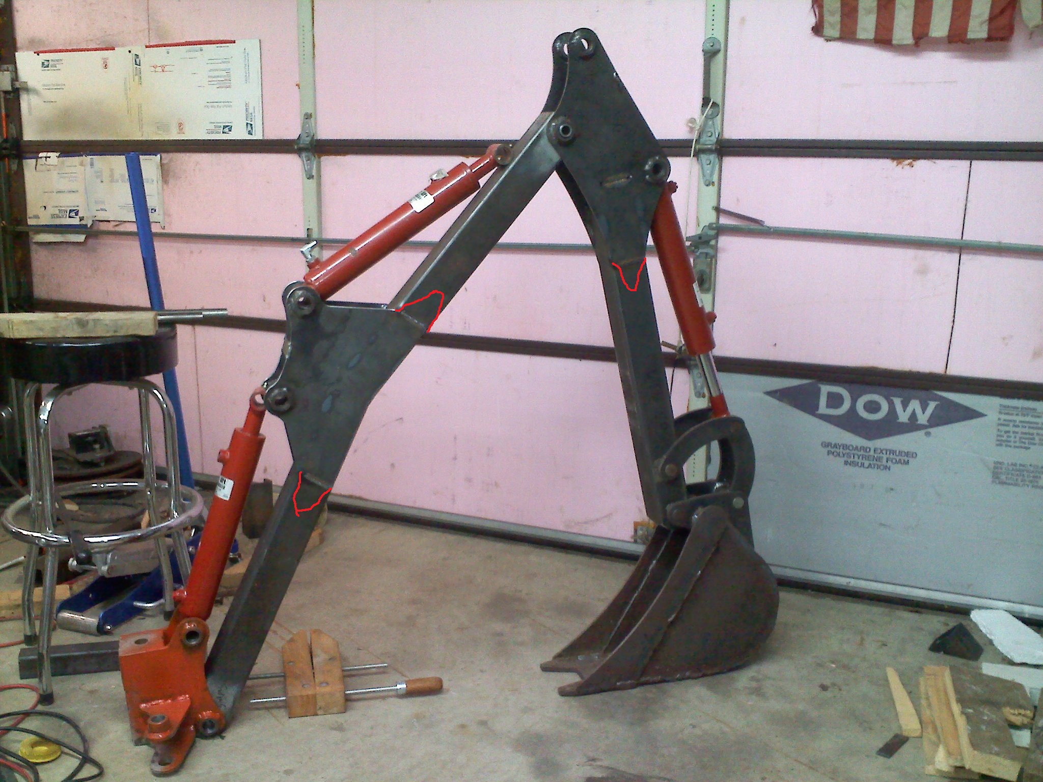

a few more pictures...
arm mock-up
stabilizers with center section...
starting to look like a backhoe....:cool2:

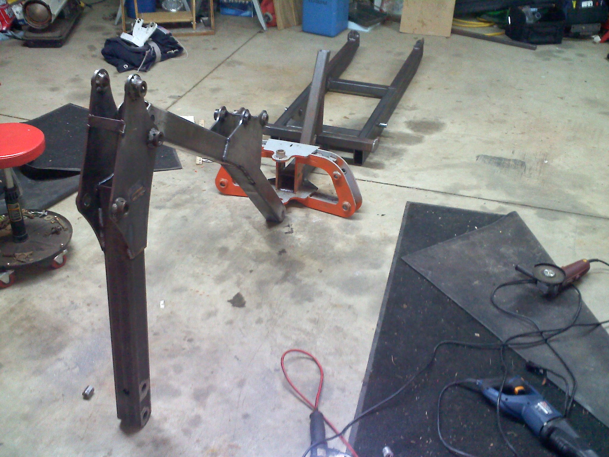

You mention CDP so I assume either the pivot weldments were bought from them or cut to their template, I just find it odd that the ends of the pivot weldments are straight were the get welded to the tubes. I was always taught that you should never weld straight across a boom or arm on ground engaging equipment, commercial machines like Case or Deere go to extremes to eliminate straight welds on their hoes and front loader arms. I realize this is a much lower stress application , it's just that CDP seems to have done a good deal of engineering on this and I'm surprised they left it out.
Picture for clarity of what I'm talking about: hoe arm mockup.jpg
