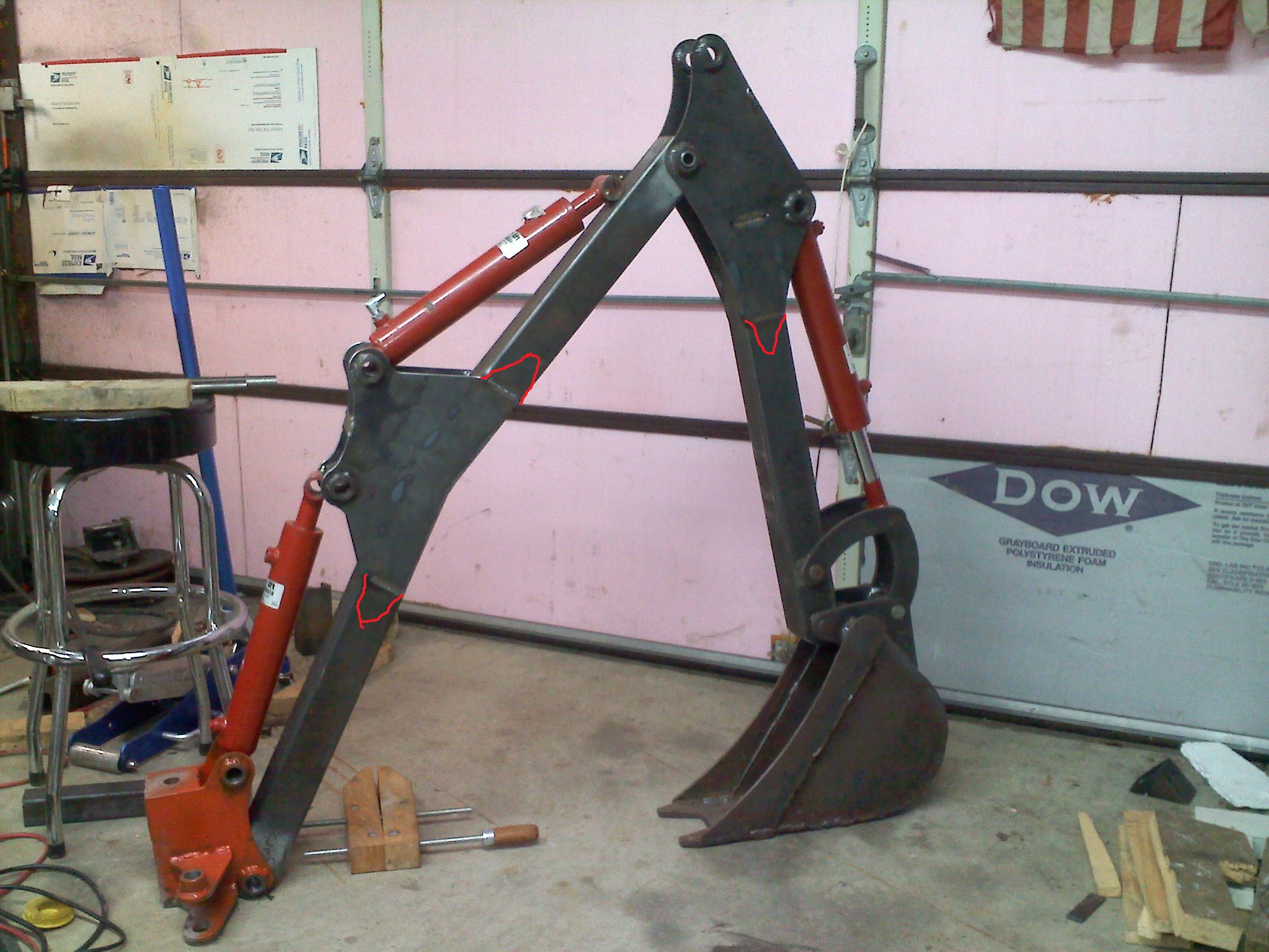

Looks great ! I like that the pieces have the modern style as see on a commercial backhoe unit.
You mention CDP so I assume either the pivot weldments were bought from them or cut to their template, I just find it odd that the ends of the pivot weldments are straight were the get welded to the tubes. I was always taught that you should never weld straight across a boom or arm on ground engaging equipment, commercial machines like Case or Deere go to extremes to eliminate straight welds on their hoes and front loader arms. I realize this is a much lower stress application , it's just that CDP seems to have done a good deal of engineering on this and I'm surprised they left it out.
Picture for clarity of what I'm talking about: View attachment 299830
Ray
Ray,
Yep, bought the plama cut parts, and now that you mention it, I've seen that on hoes. Thanks for the marked up photo.
I do have to say that all other hoe kits are the same way (straight across) the arms welding. But it would make a better looking and strong unit if they did add the taped to center side plates.

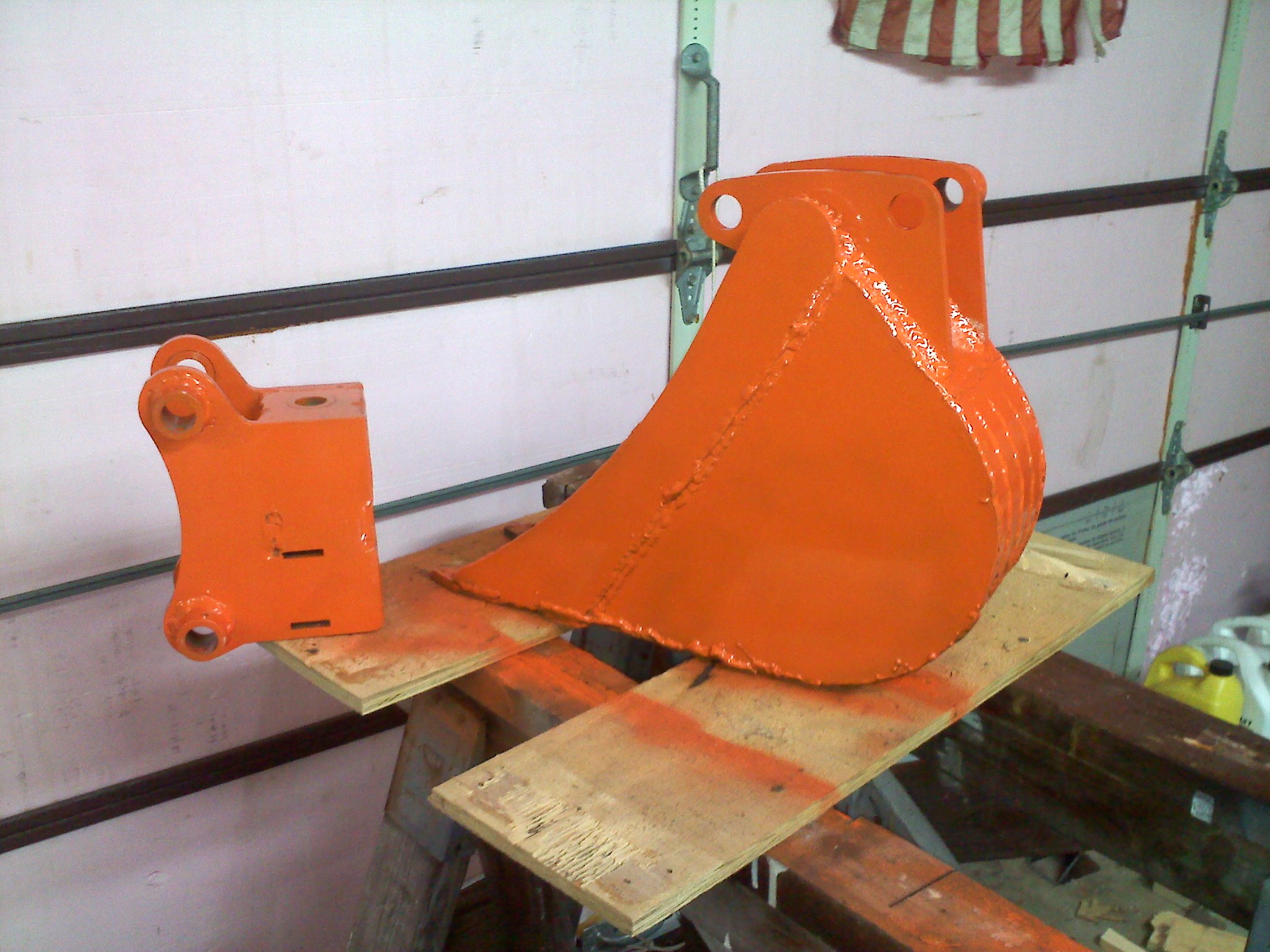

A little painting yesterday...
also got 0.035 wire for welder to do some 3/16 thickness welding.
