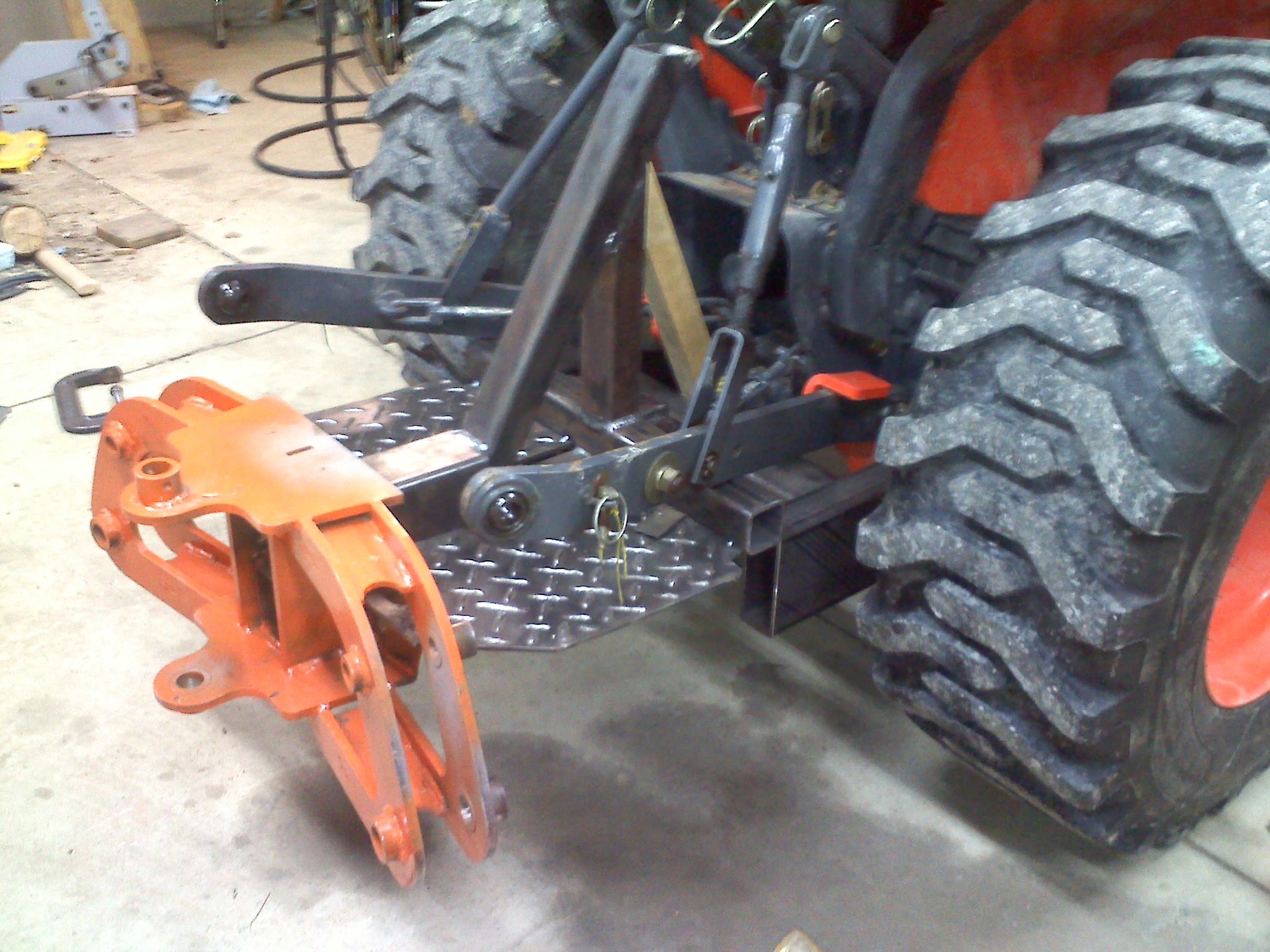

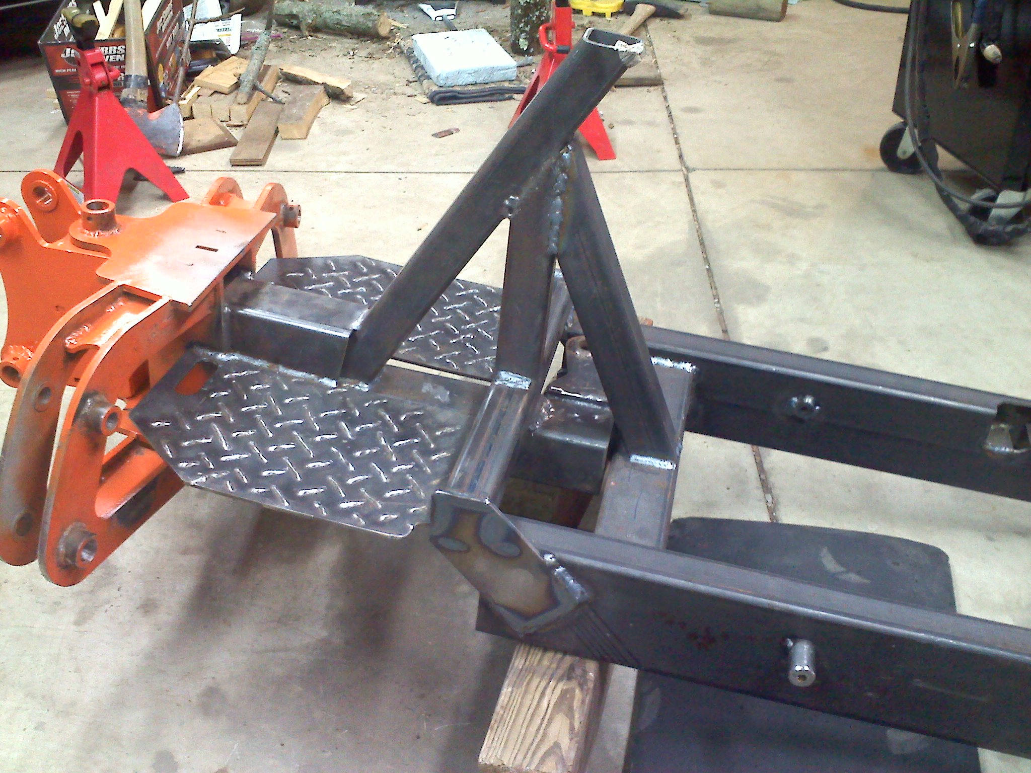

progress pictures....
sub frame and main swing framework mounted to B7510
subframe and swing feamework
pic of swing connection to subframe

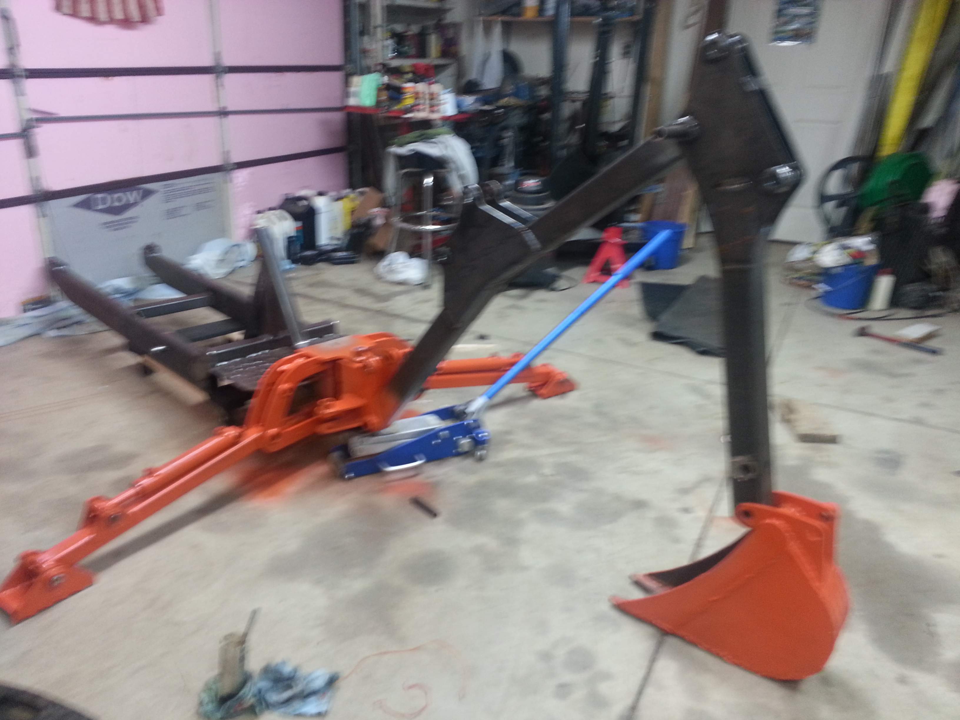

got the stabilizers assembled, mocked up the arm and bucket.
after seeing the post...need to include a close up of the stablizer arms

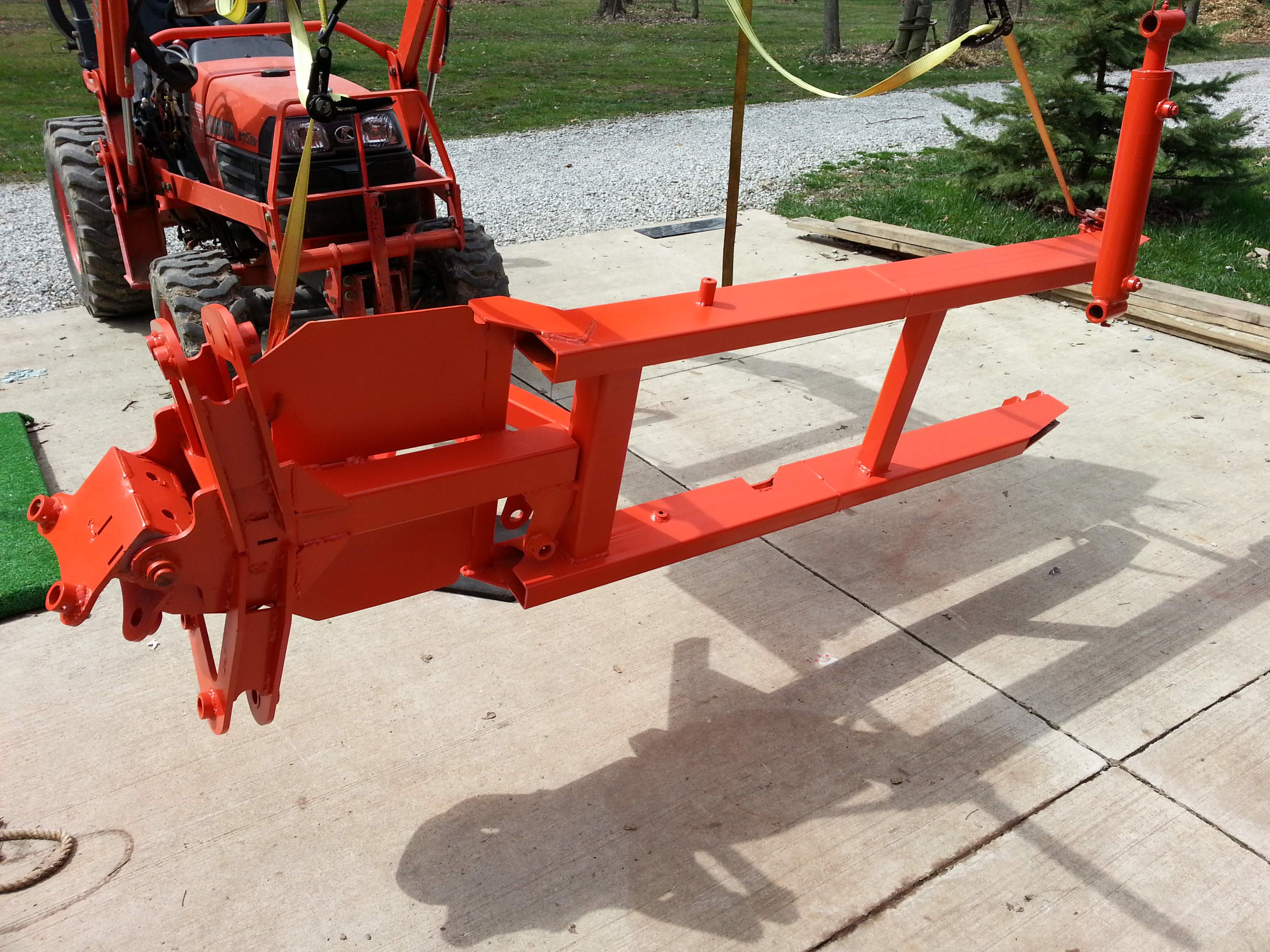

#25
OK, did some painting. first some rustolium metal primer applied via a cheapo HF spray gun..
worked pretty darn good! first time spraying paint in 30 years!
Got some bright Bota ORG from the Kubota dealer 3 miles from the house, only $35 paint for a Qt., 15 buck pint of solvent...not too bad for Kubota dealer?
Will post bota orange parts tomorrow.

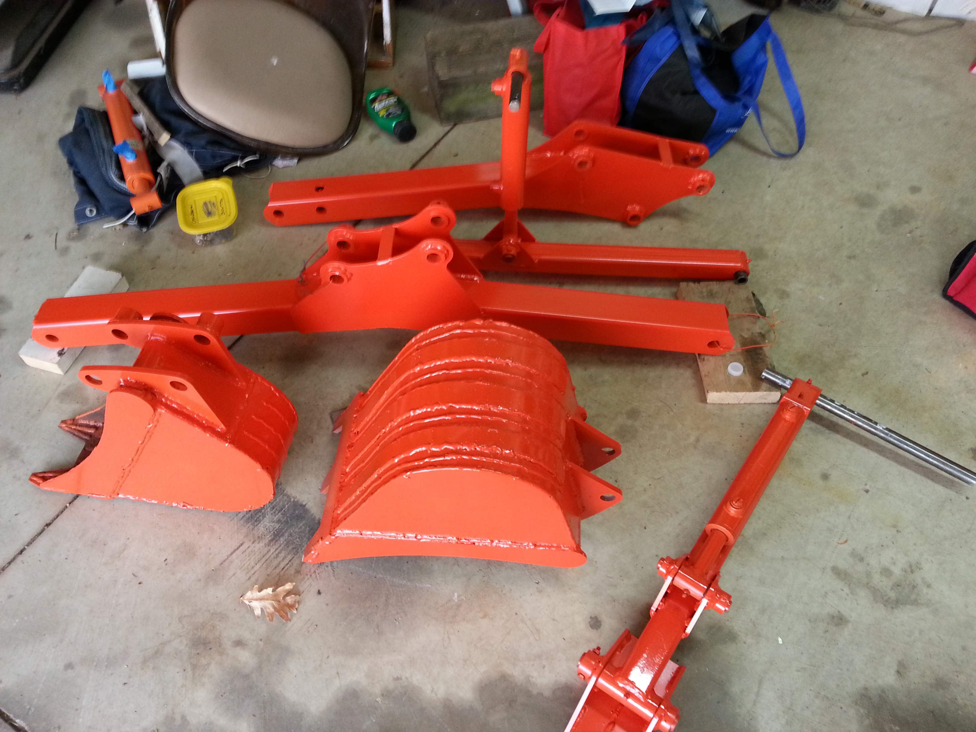

Orange painted parts...
and a correction on the solvent cost...10 bucks
20130417_150229 sub frame orange paint on bucket.jpg 20130417_113028 bucket and booms orange.jpg
   / CDP MID600 "backhoe build" project #27
Very good job. I have a B7510 also, but with a Woods 6500 on it. Great combo since its also sub frame. Are you using tractor hydraulics? If so I would LOVE to see, in detail, your hydraulic hook up. Also a close up shot of the rear sub frame attachment. Again great work, looking for ward to seeing more.
