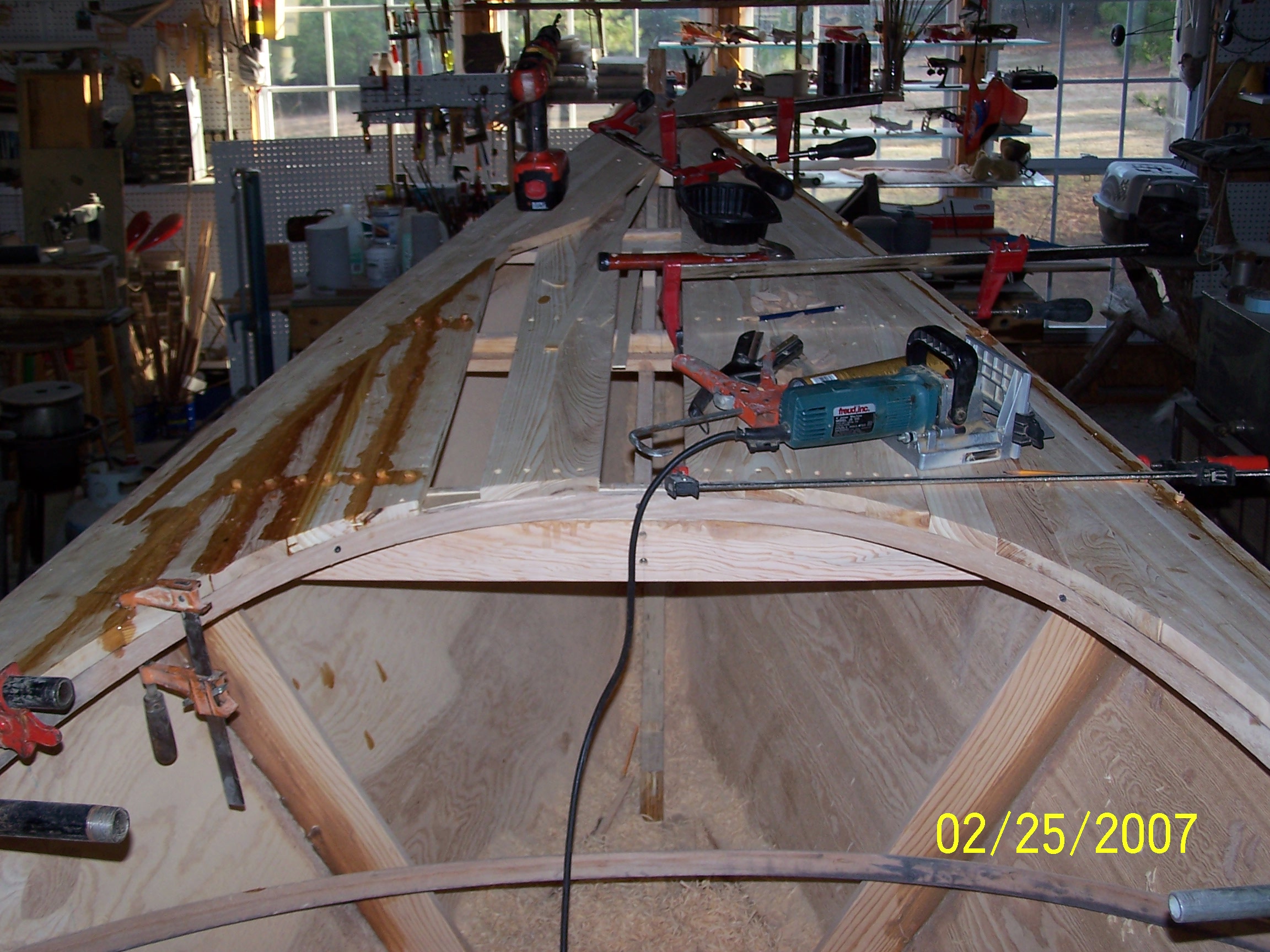

Not thats a boat! Very well done! I have 6 strips on so far. 3 on each side. I am hoping to add a couple more today.

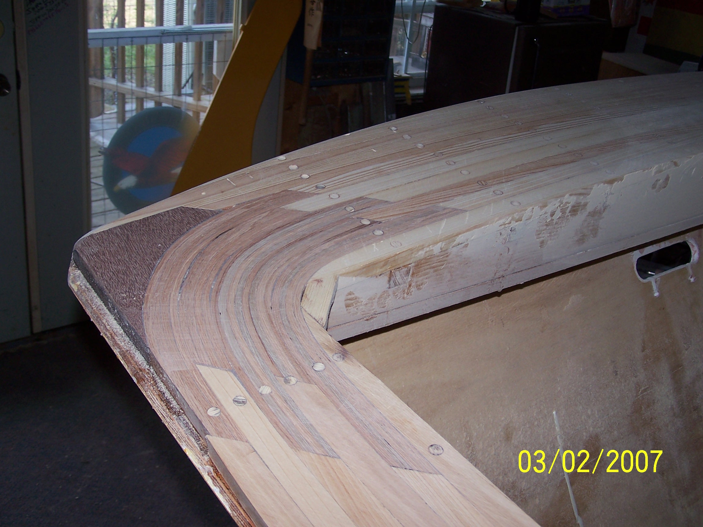

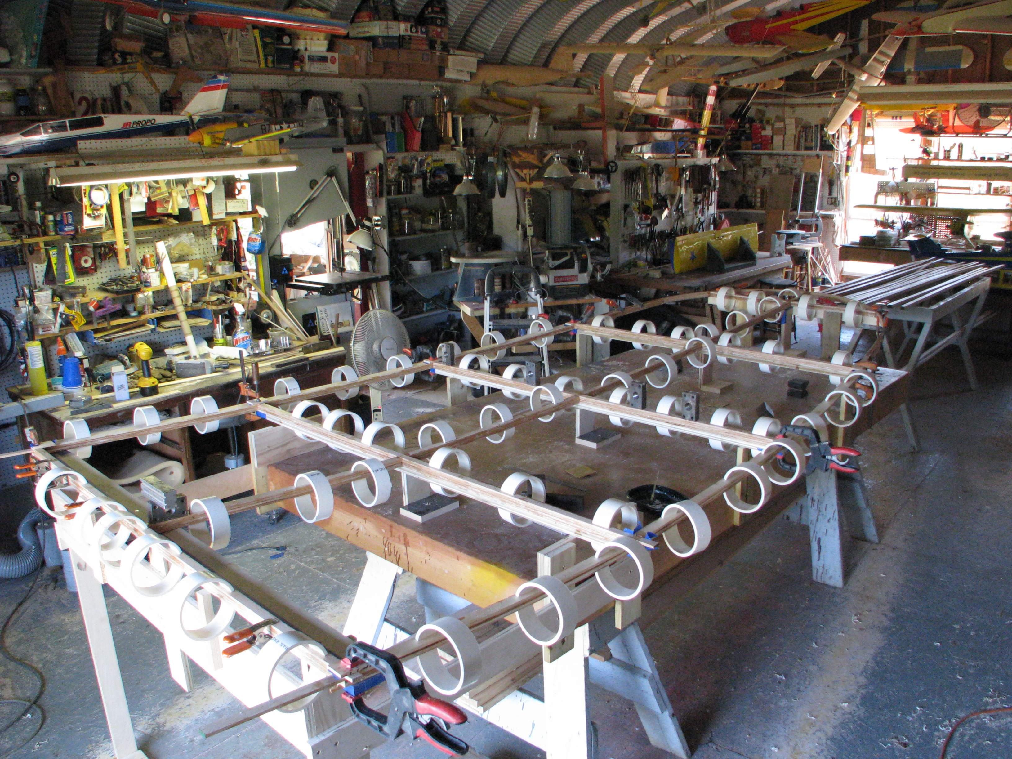

Your framework answered a few questions, as far as how to clamp the strips.Something I tried when building the oak stripped top frame for my boat was to cut some 4" schedule 40 into 2" stripes. for clamping stuff.
Question? Did you steam bend the ask, or just heat with heat gun?

I cut the ash into 1/8" strips then used a heat gun to help bend them. Once they cooled down i was able to unclamp and glue up the laminations. Seemed a little faster then waiting for the steambox to heat up.

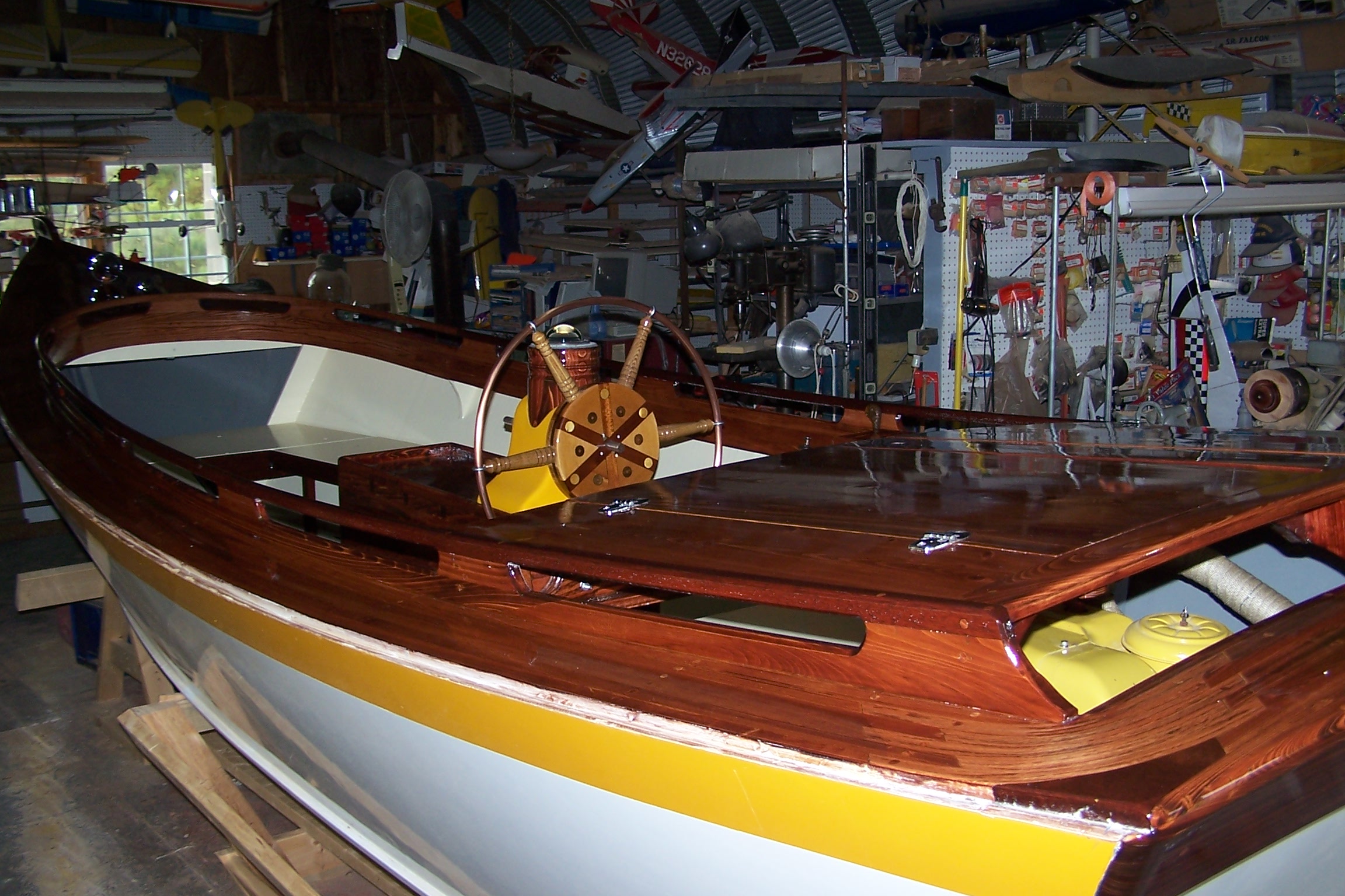

Some of those boats are so nice, I'd have trouble putting them in the water if I made one that turned out as nice as some of y'all's photos
   / cedar strip canoe #28
Yep, same here. I hate talented people, they make things look so easy. :eek:

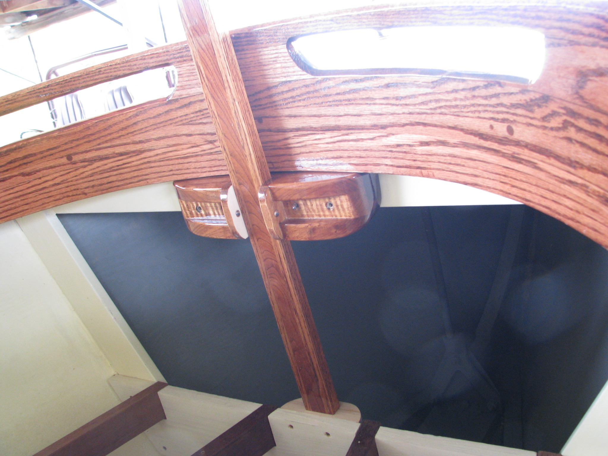

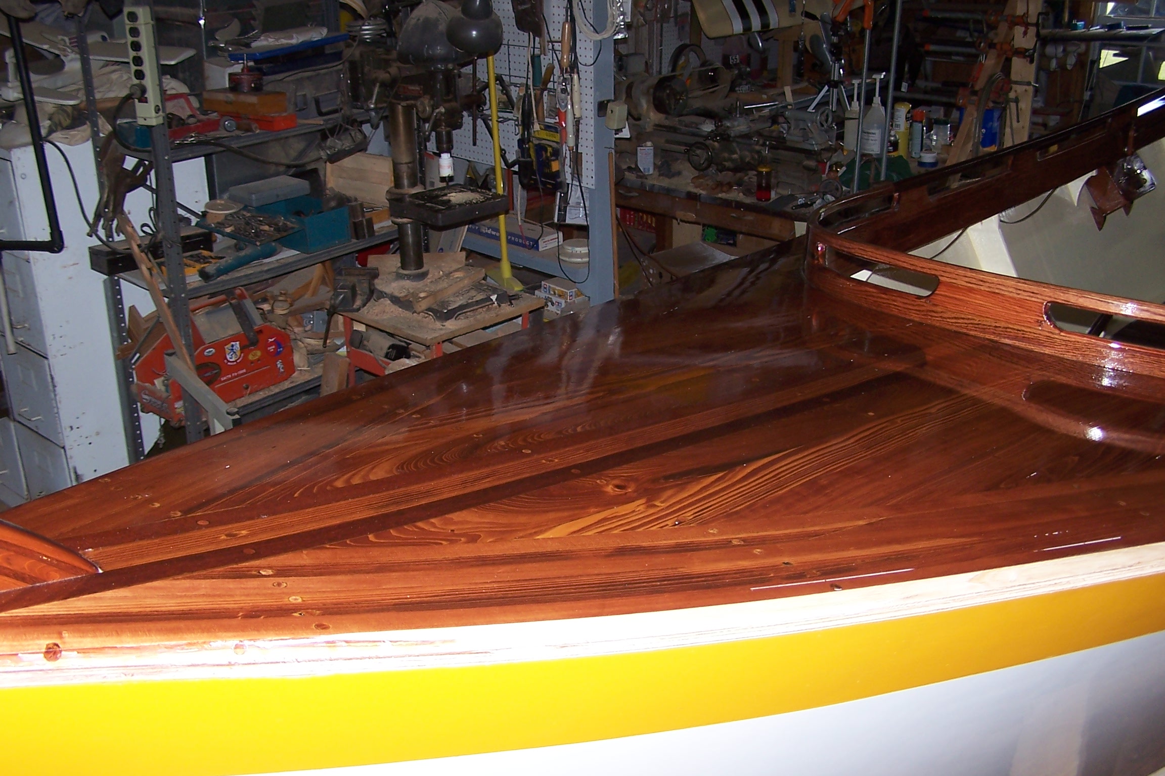

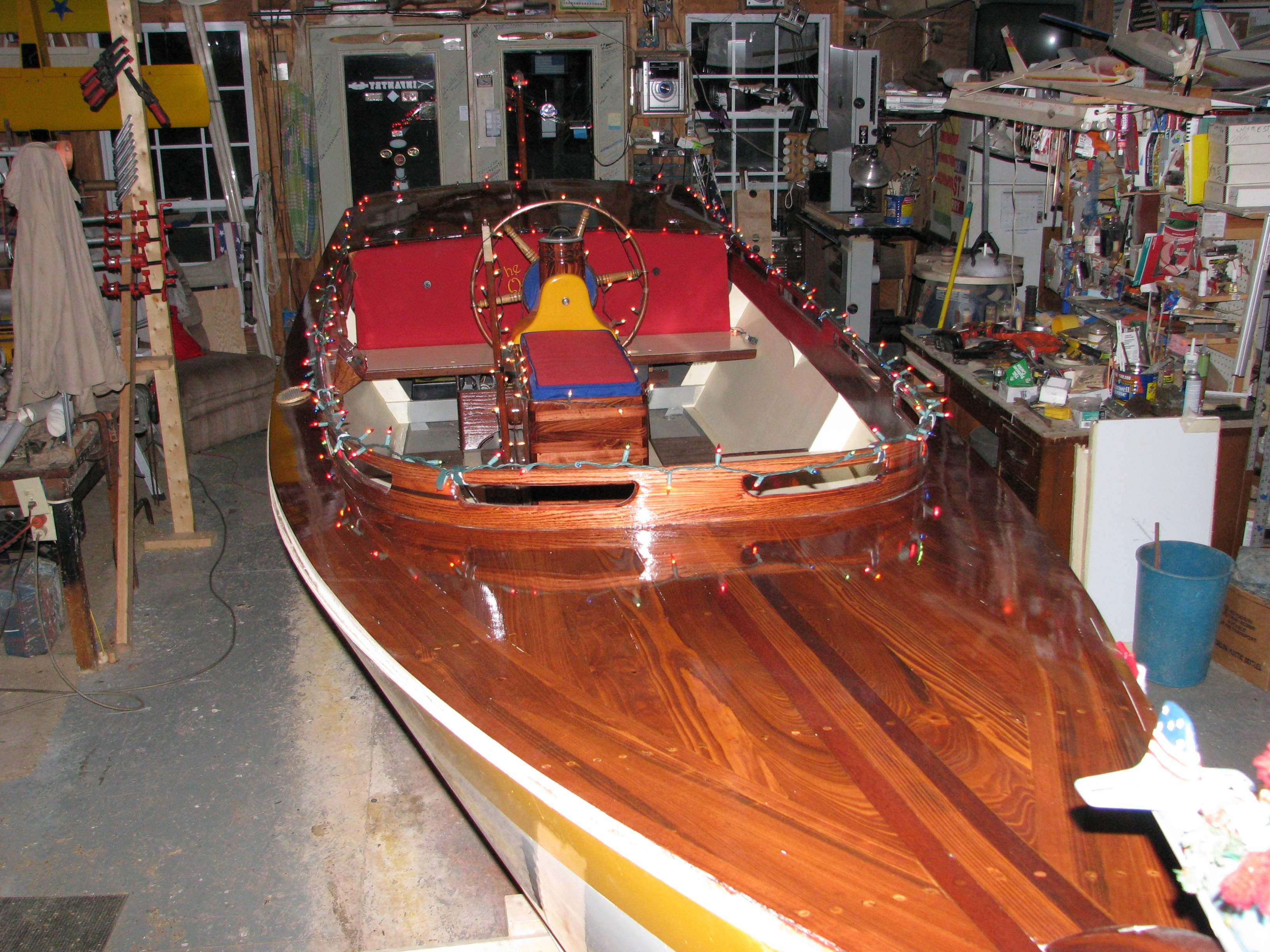

There are 2 places on my boat AS I built it was really special.
Army Grunt
   / cedar strip canoe #30
The deck is cool also
Army Grunt
