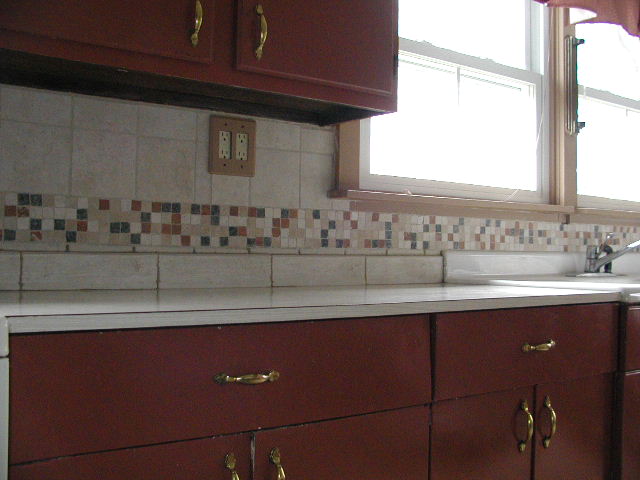

<font color="blue"> Attached is a picture of the area to be tiled </font>
Well, just like giving elephants giving birth /forums/images/graemlins/tongue.gif, way too many months later (just ask my wife!), here's a picture of the area that has been tiled. Now, for the final question, does this tile and/or grout need to be sealed? If so, with what?

   / Cement Board #35
My wife's brother and I just finished doing the project of a large corner whirlpool tub, the project required using four sheets of the cement board. We cut the board outdoors using a 7 1/4 circular saw with a thin rim diamond blade sold at Home Depot for about $15. It cuts really fast and smooth, the same saw blade does wonders for cutting concrete block.
When the tub was in place we had to cover the base with $500 worth of very expensive tile, some of the tiles cost $24 each which required using extra care while trimming. I purchased one of Home Depot's 3/4 hp wet cutting tile saws, the price of $88 plus tax was only a few dollars more than renting their tile saw for two days. The saw did an amazingly fast job of cutting 5/16 inch thick tile, once I got it home and tried it out I was so happy I decided to buy it instead of renting one. Just my two cents worth, and NO, I don't own any HD stock !! (just wish I did)
   / Cement Board #36
You can cut the cement board with a utility knife by scoring both sides and then breaking it. If you have notches and stuff to cut out, you can turn an old saw blade around backwards and use your circular saw. Be sure to wear eye and lung protection.
I have had much experience with the green "water resistant" sheetrock, all of it very bad. I spent lots of time replacing old waterlogged sheetrock in my showers, replacing it with the green sheetrock, which was NO BETTER, and lasted on a year or so. Redid the whole thing with concrete board and that did the trick.
Now a backsplash is not going to get as wet as a shower wall, but if it was me, I'd use the concrete board.
